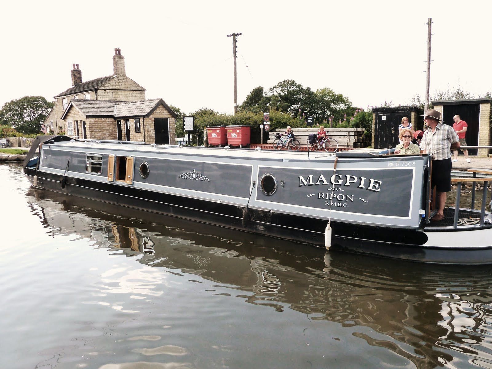

matty40s Posted April 21, 2021 Report Posted April 21, 2021 Looks like a mix of Cargo Grey and Battleship grey, with an off white coachline. Gunnel is just black gloss, epifanes black is better, slightly matt finish. 1
