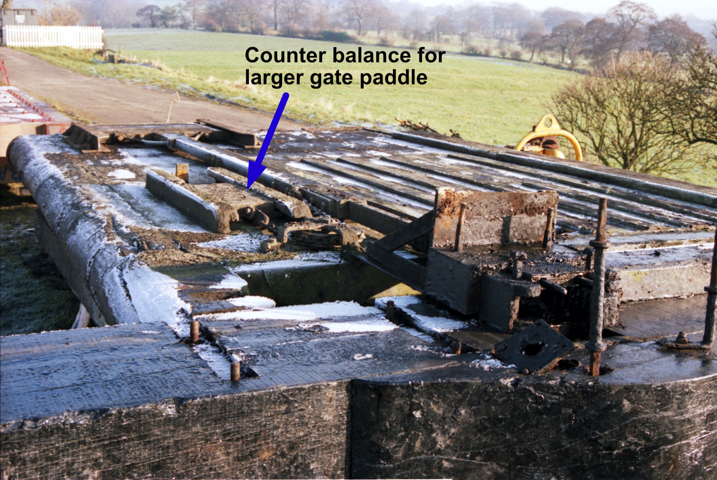

To increase the speed of passage through locks, the L&LC enlarged the paddle opening on bottom gates, fitting a counter-balance to make the additional weight easier to raise. I don't think any survive.

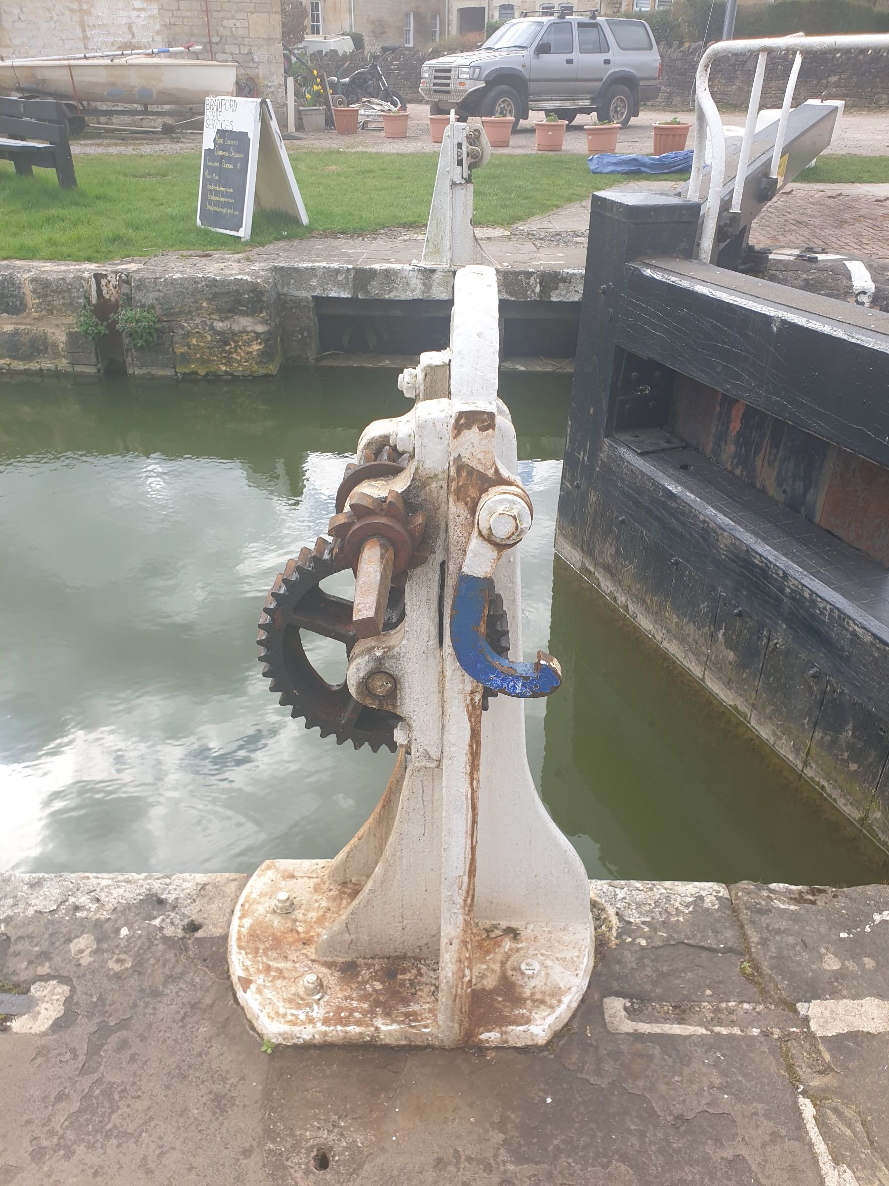

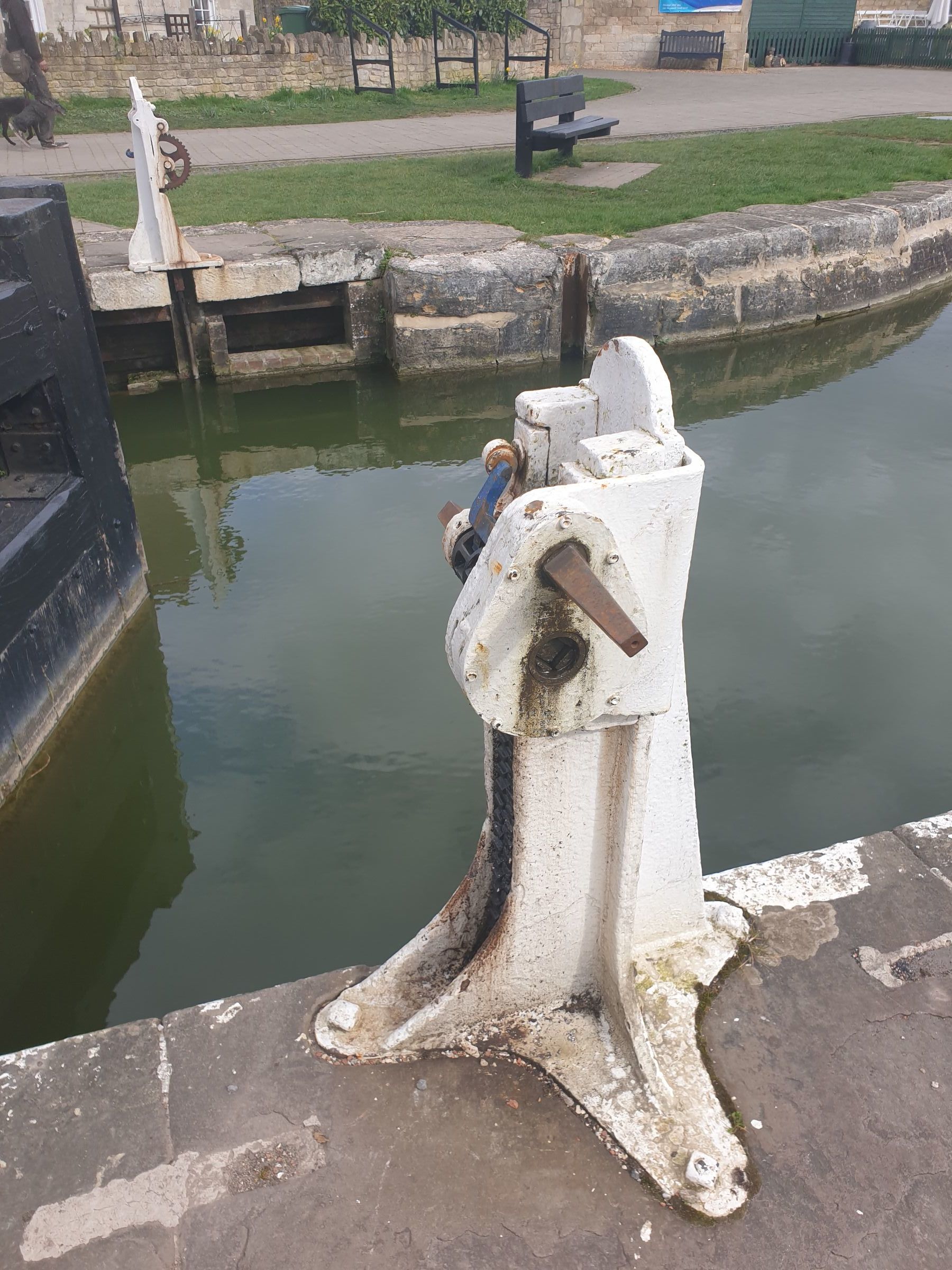

52 minutes ago, magpie patrick said:
That is a much neater reduction box than the Fenner gear which BW usually fitted to stiff paddles. Is it something that was added as part of the reopening or is it older?
Post re-opening and not only unique to the K&A but, erm, unique,,,
It's a good idea as it can be retrofitted to existing paddles, as here, but somewhat overdone, it seems to be about a 20 to 1 reduction!

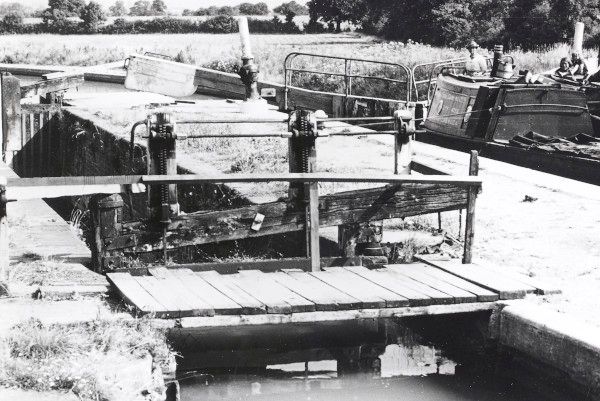

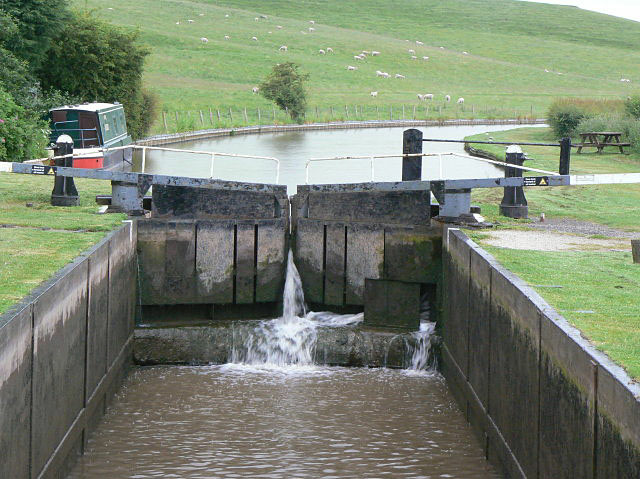

On the latter point about gates having a gate paddle fitted later, this happened at Beeston Iron Lock. The steel top gates (now replaced) were fitted in 1963 and I have seen a photo from about that time showing the gates with no gate paddle on either. Another picture from the late 1970s showed the towpath-side gate with a paddle added, and raised. By the early 2000s the rack had been disconnected but the paddle structure kept in place until the gates were replaced.
Have a recollection from years ago of seeing a picture of Park Gate Lock with a paddle fitted to the steel top gate, although I might have mixed this up with a different lock as I haven't seen any other pictures showing this, and it doesn't have one fitted now.
Beeston Iron lock: Photo courtesy of James Wood and www.canalscape.net website.
And a more modern photo, courtesy of Alan Murray-Rust and Geograph website:
Edited by Philip
