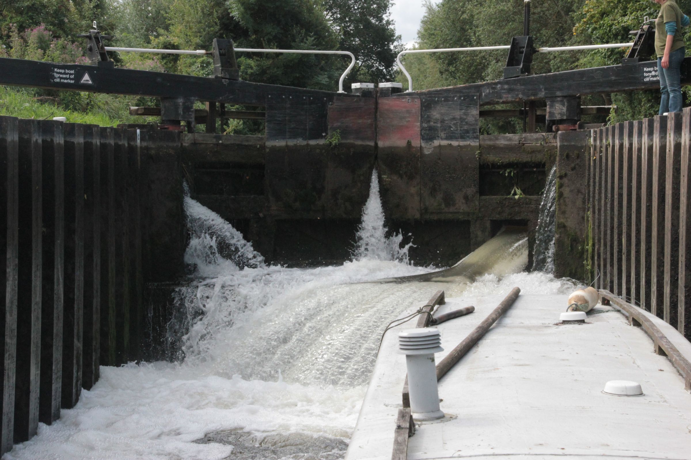

The Kennet and Avon is interesting; west of Newbury it is top ground paddles and bottom gate paddles all the way, but between Newbury and Reading it is mostly top gate paddles and no ground paddles (from the pictures I've seen). I know that, to be accurate, it is the Kennet Navigation east of Newbury, but surely the locks weren't originally built without ground paddles?
Also interesting to see from pictures that the sluices in the top gates east of Newbury don't have baffles, particularly given they don't have ground paddles!

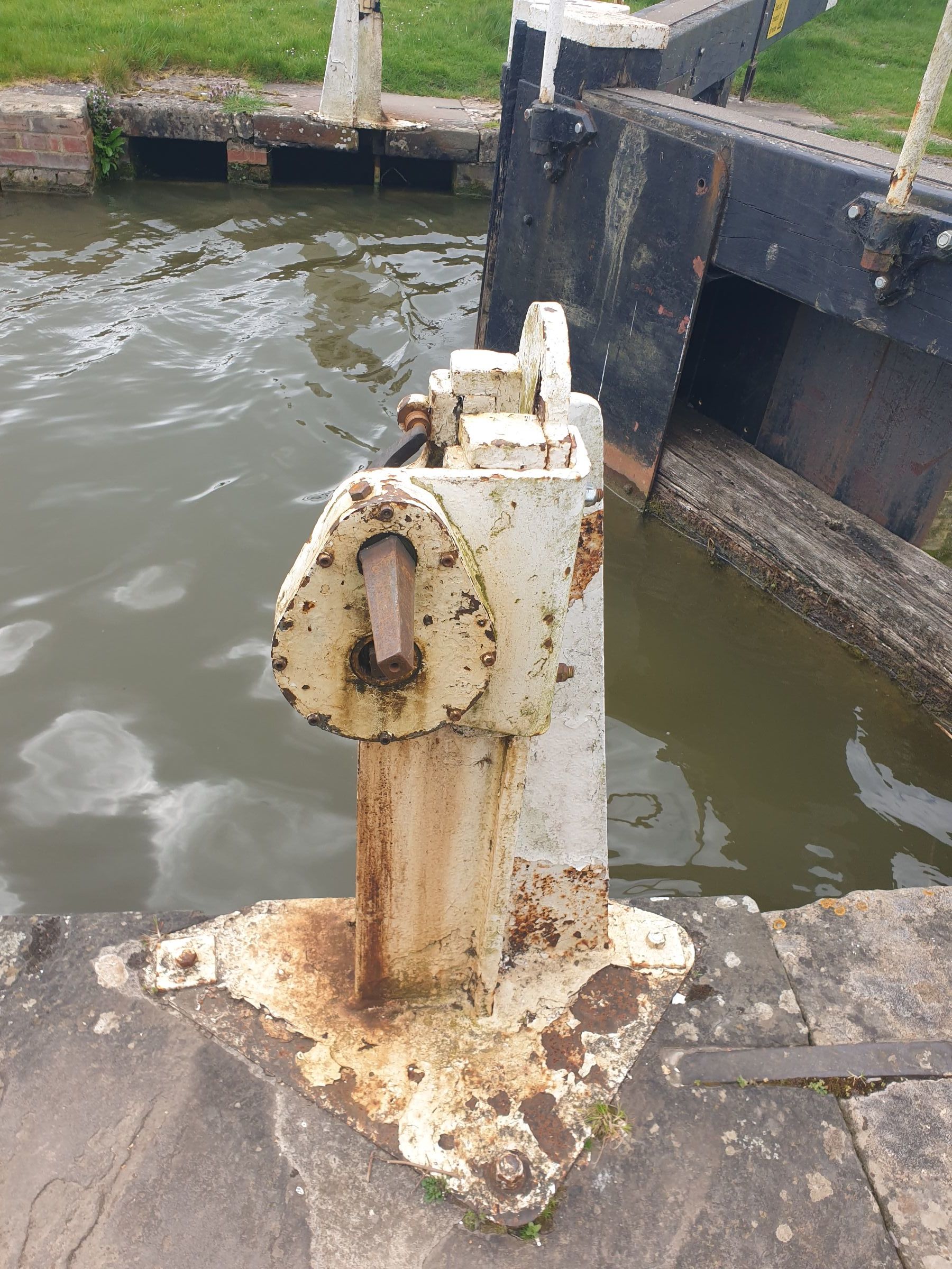

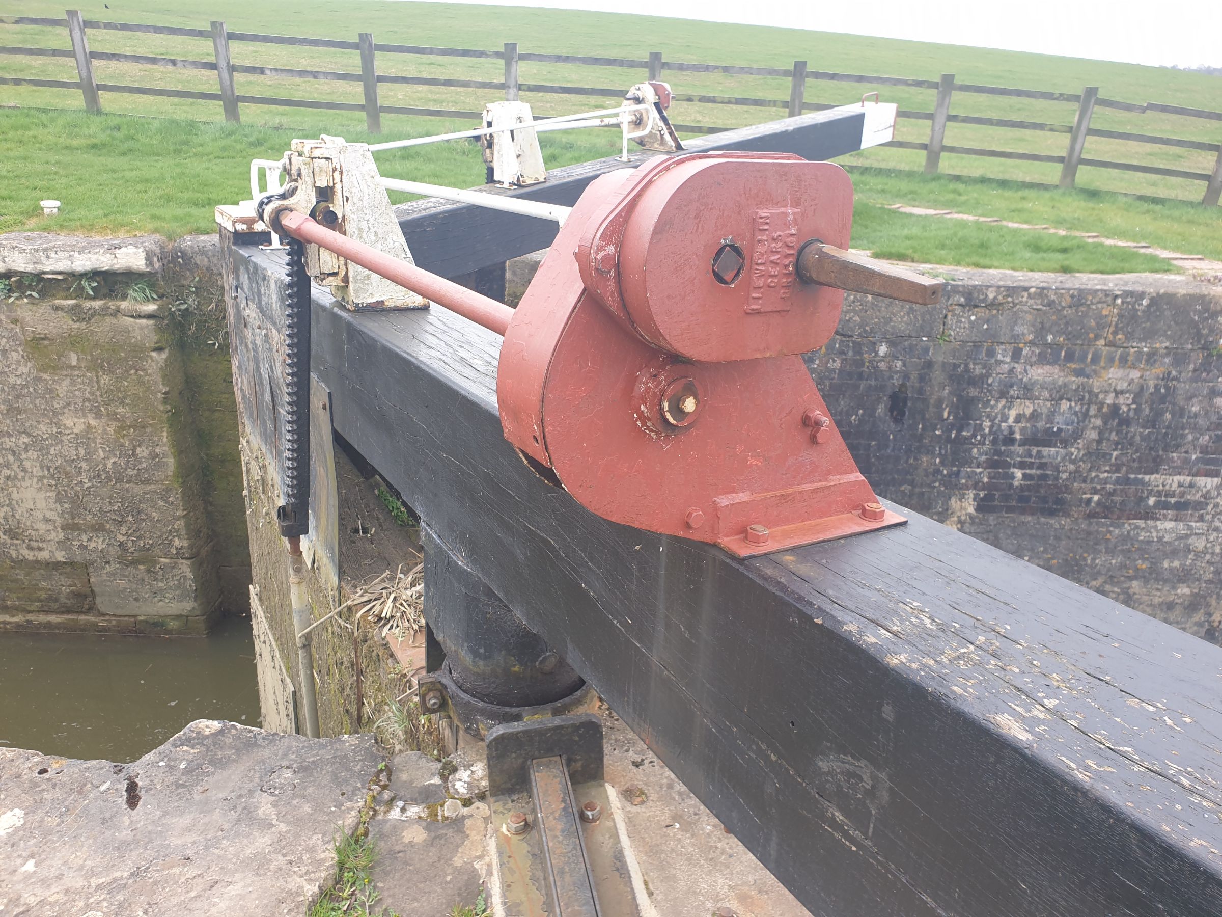

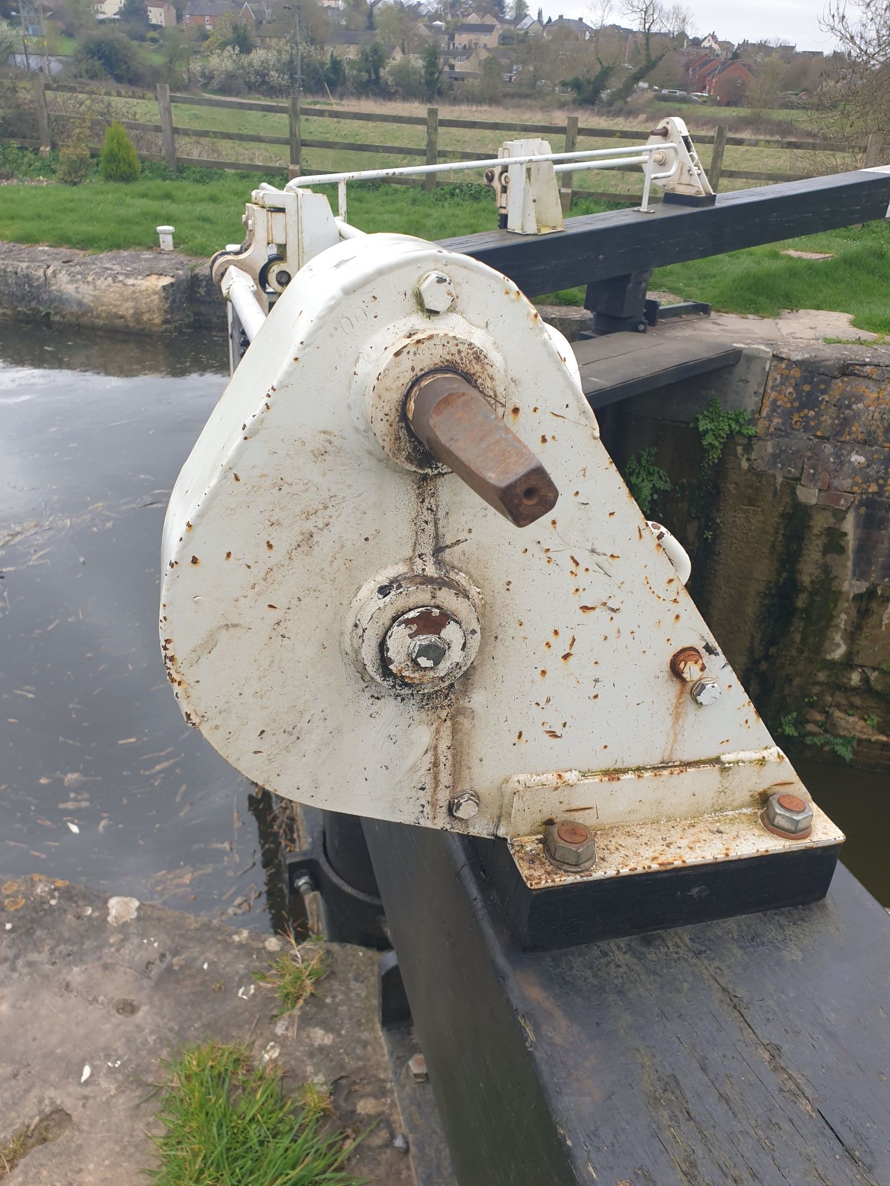

Walk along K&A at Seend yesterday. The gearboxes applied to the top ground paddles have also been applied to some bottom gate paddles. However the gate paddles already have gearing so this makes them very slow to operate. The gearbox droves through the original spindle, which appears to be the old K&A 1 1/8th inch square.
The ground paddles are original pre-closure gear. The gate paddles are not
Original ground paddle with gear box
Basic rule on the K&A is the rivers at each end have upper gate paddles and the canal has upper ground paddles - however the first few locks from Newbury towards Hungerford have gate paddles despite being built as part of the canal. And from memory Garston lock, the only turf sided lock that didn't need restoration, has upper ground paddles.
Somewhere I have a picture from within the lock of the upper gate paddles at Towney Lock - as you say, no baffles...

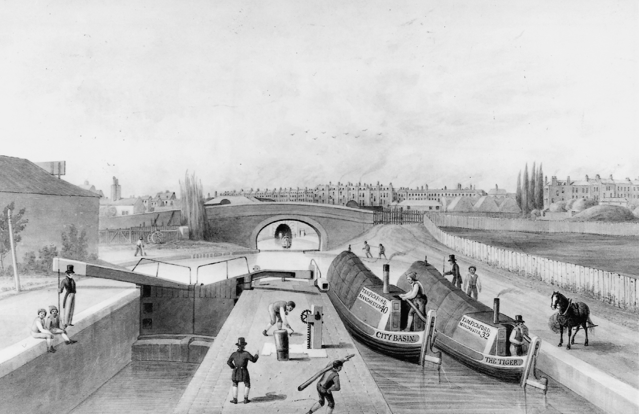

On river navigations, lock falls tend to be small and thus gate paddles can be used with little inconvenience. The introduction of ground paddles on the Willebroek Canal was probably because to lowest lock was tidal, resulting in a large fall at low tides. When canals were built, lock falls tended to be greater than on river navigations, making the problem of water falling onto a boat from upper gate paddles a problem. To overcome this, whilst reducing the number of locks by making them deeper, ground paddles were used. Where ground paddles were used, gate paddles were not fitted, and those found today were often added in the mid-19th century to speed up traffic to compete with railways, usually on the more successful canals. The image shows locks circa 1820 which appear to have a single ground paddle. If this was fairly standard, then a second ground could also have been added to speed passage through locks, rather than gate paddles.
I have seen photos of locks on the Regents Canal, from the mid-20th century, showing them fitted with top gate paddles. None of the Regents Canal locks have them fitted now.

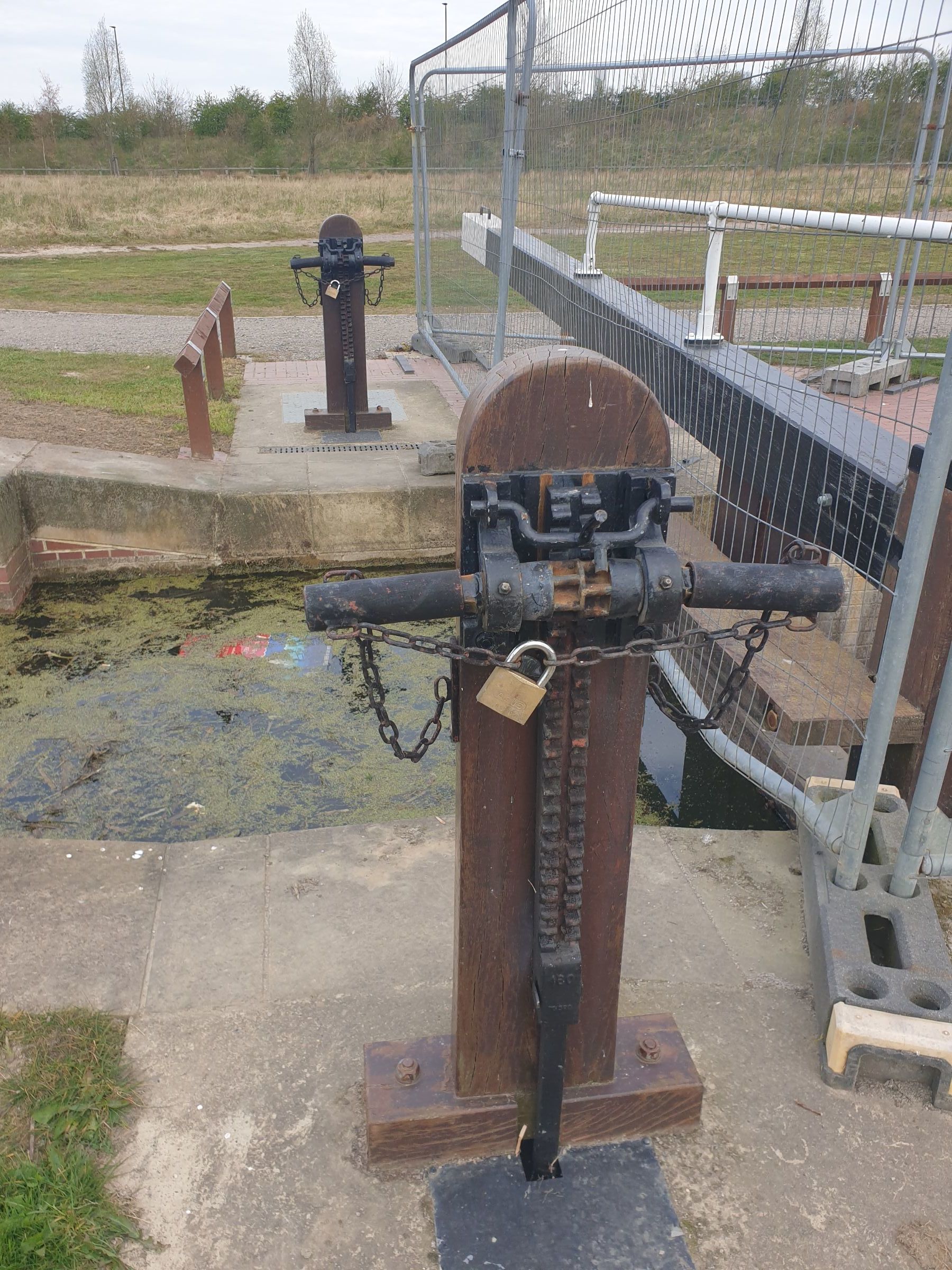

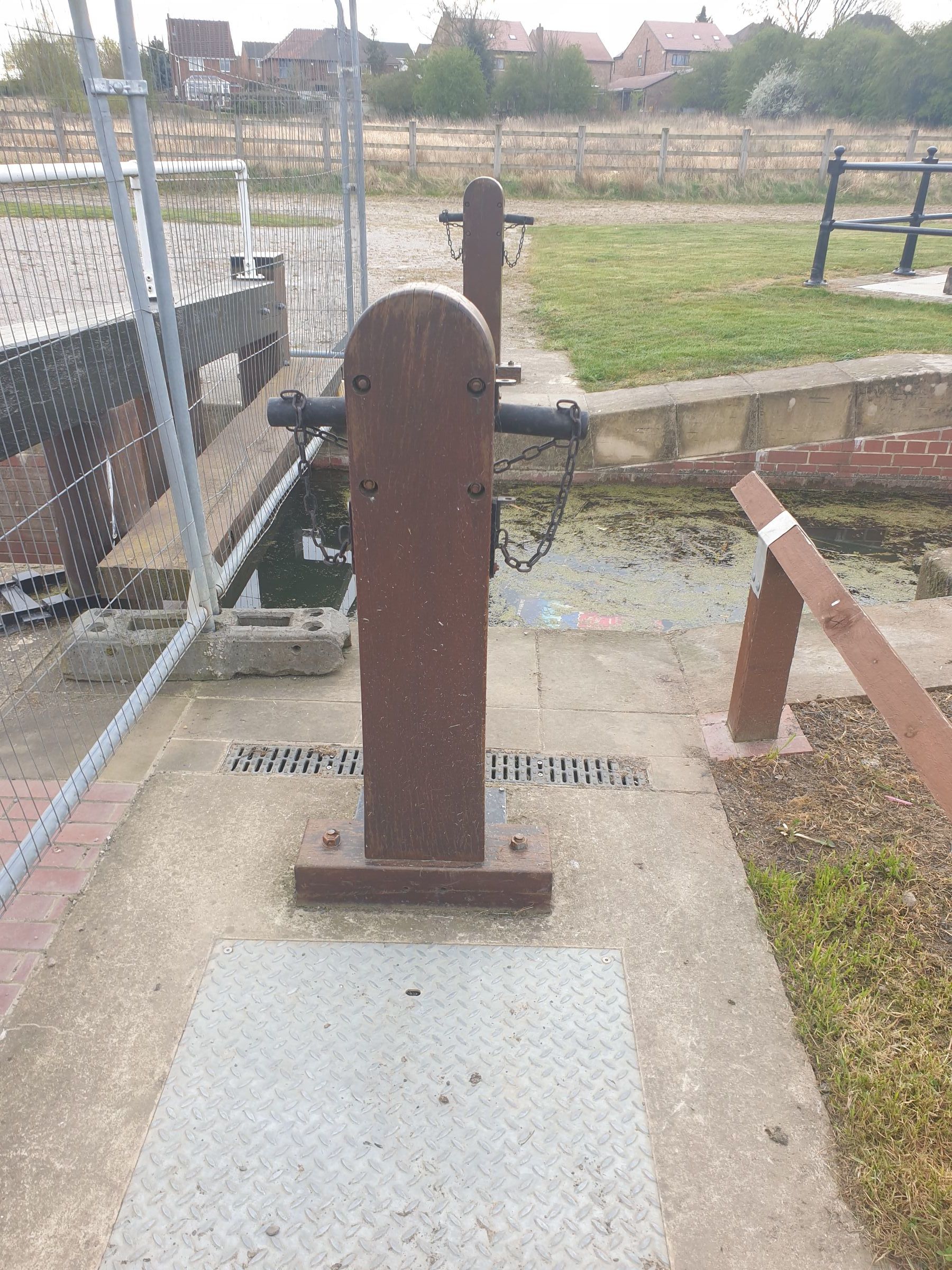

Saw these this morning at the new lock at Staveley on the Chesterfield Canal - maim feature of note is they face sideways, one facing the canal one facing away.
Other canals used to have this feature (at the waters edge whereas these are set back) but not common these days.
Always useful for stiff or heavy paddles as you can get two people doing the winding.

That's a picture I'm familiar with but I realise there are things I hadn't picked up. The boats are a bit short and somewhat styalised, and yet there is an interconnecting paddle with quite some detail! I hadn't noticed that the left hand lock appears to have only one paddle (I'm not sure you can see the position where it would be on the right hand lock). Adding ground paddles is rather more complex than adding gate paddles, although I know of locations where it has been done
The top-hatted gentleman on the right appears to be guaging the boat. Were Regents Canal toll clerks really so well dressed?

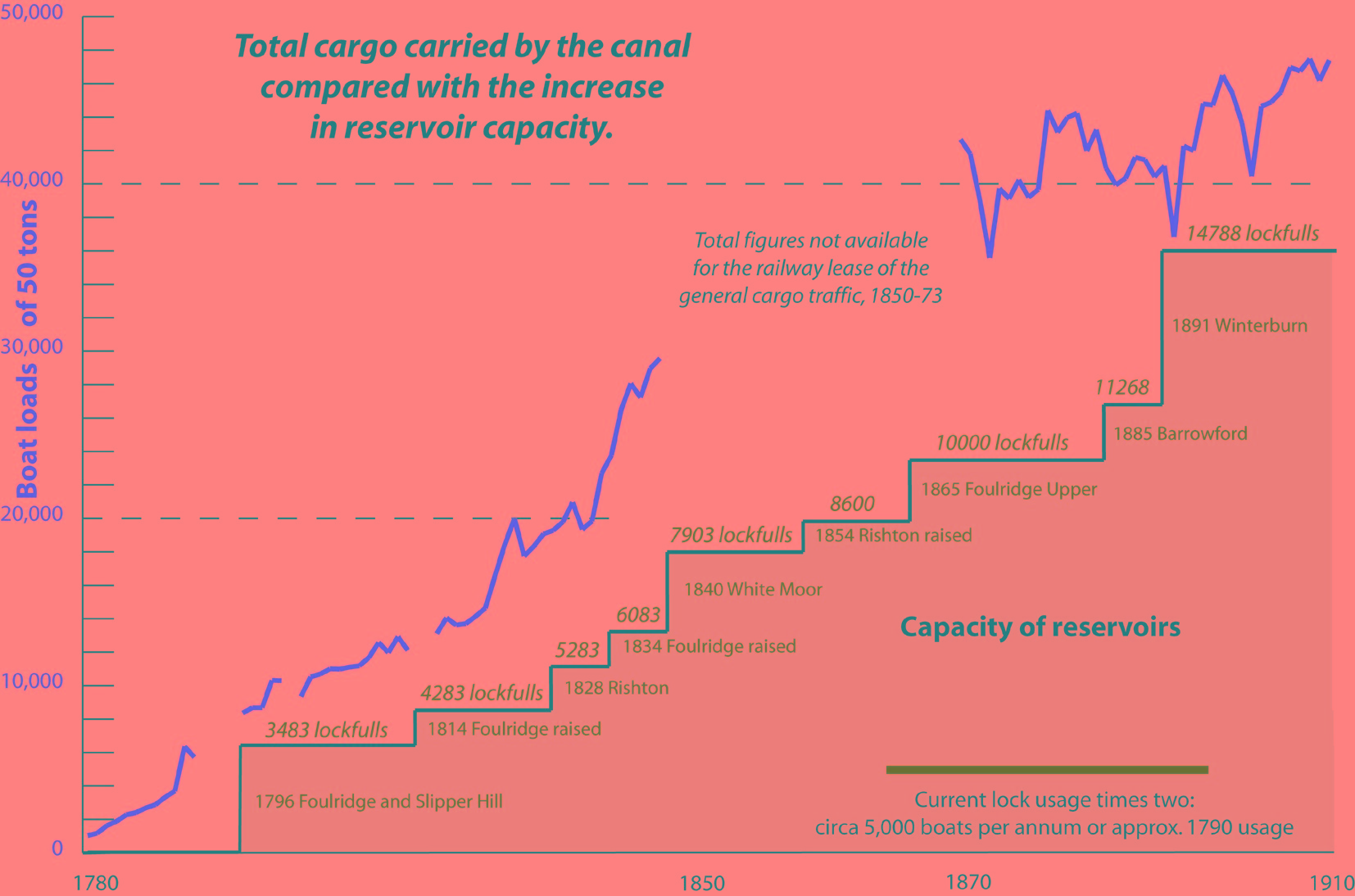

On paddles,  one for @Pluto were extra paddles added for speed or capacity? I realise they were related, but increasing the number of boats that could pass would be commercially very valuable on a busy canal.
I would suspect speed, as capacity depends upon water supply. This graph shows how L&LC reservoir capacity was increased to cope with increased demand. Capacity is in lock-fulls, calculated at a standard 80,000 galls per lock. Some years ago, I did suggest to BW's water engineers that they go back to measuring in lock-fulls, as it would remind them why they needed to supply water.
The 'City Basin' & 'The Tiger' boat scene is well known - and full of inaccuracies. The artist has made sketches on site, then filled in details at home/office.
Top hats! They give the impression of authoritarian confidence. An increase in overall height of a man (or woman) creates an impression of seniority. Officers of the law an example.
Boy in the middle seems to have dropped his windlass, and getting a reprimand. Authority again - "We brook no carelessness!" Advertising the company policy.
The balance beams are overlapping which might be correct, but why the strange crank?

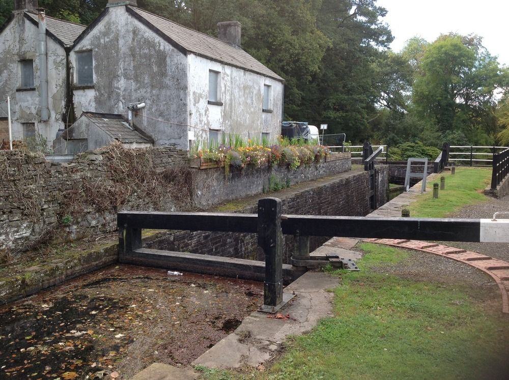

I can suggest a  couple of canals that have only one paddle to fill the lock - the Neath canal for example (pictured below at Tonna Lock) - I can't find my copy of Ian Wright's book but I don't think the Neath had gate paddles in it's commercial heyday. By contrast, the Monmouth Canal was greedy with two ground paddles and a gate paddle at the top.
One reason I pondered about capacity is it tended to be the busier canals that added gate paddles - accepting that water supply is the ultimate constraint other measures were undertaken to increase capacity, in extremis duplicating locks, and adding extra paddles to get more boats though a lock in a given time would be quite a cheap way of doing it.
If you do a quick calculation based on a narrow canal carrying 500,000 tons pa, which is around 10,000 tons per week, so 400 boat loads. That means you would have around 60 boats per day, or 5 per hour based on a 12 hour day. Would you need to speed up passage through the locks to increase the number of boats? Certainly there will be a few canals which had places where the number of boats passing was nearing the limit The L&LC Wigan flight is probably one, and there would certainly be locks on the BCN where speed through the locks could be a factor, but in general water supply was probably more important. As a guide figure, suggested to me by a waterway engineer, anything over 2 million tons per year will be approaching 'saturation' on a reservoir-supplied canal. Water for river navigations is not so critical.
