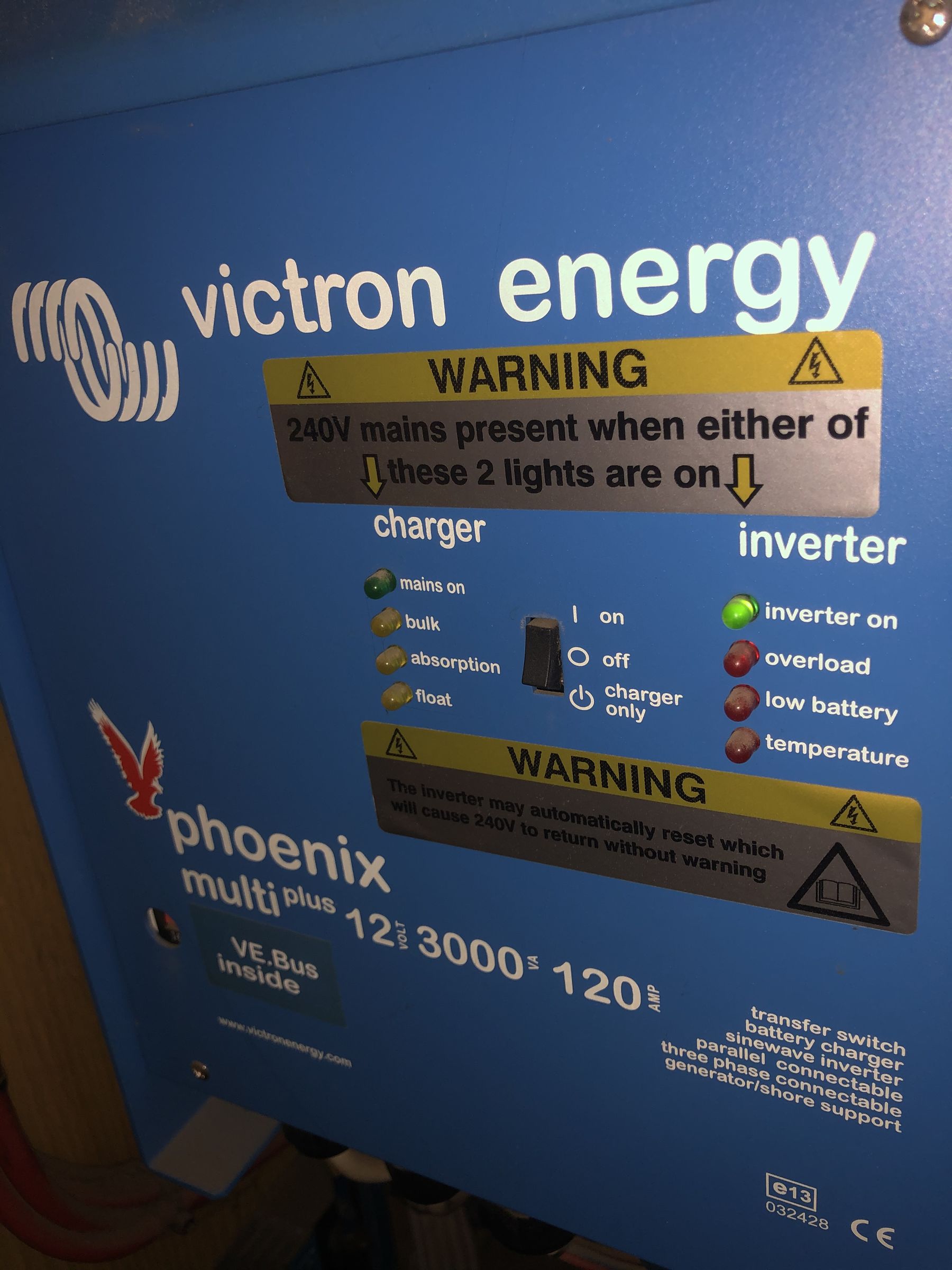

RufusR Posted December 13, 2020 Report Posted December 13, 2020 (edited) Ok I have same victron the agm charge profiles are set up for victron agm batteries , there are 2 options either 14.7 v absorb or 14.4 v absorb these are set either by puter via usb link or by dip switches inside the case on upper right . Check the profile of your battery and whether your victron has temp compensation , victron agms should have 14.4 for shallow cycles or if new non compensated , 14.7 is good this time of year if no temp compensation. Some agm like full river want 14.7 nominal. Leoch ones prob 14.4 nominal but this time of year with low temps then 14.7;is good if you don’t have temp compensation. . If you have temp compensation the. 14.4 is prob best , those two options are the only ones for agm , if you need a different voltage you will need to play with other batteries settings unless newer unit which has more options Edited December 13, 2020 by RufusR
Richard10002 Posted December 13, 2020 Report Posted December 13, 2020 The manuals for the 12/3000/120 with particular firmwares, (xxxx4xx or xxxx1xx) have tables at 5.5.2 to show the dipswitch settings for the 4 charging profiles available: https://www.victronenergy.com/upload/documents/Manual-MultiPlus-3k-230V-16A--50A-(firmware-xxxx1xx)a-EN-NL-FR-DE-ES-SE.pdf https://www.victronenergy.com/upload/documents/Manual-MultiPlus-3k-230V-16A-50A-(firmware-xxxx4xx)-EN-NL-FR-DE-ES-SE.pdf The 4 Absorption Voltages are 14.1V, 14.7V, 14.4V, and 15.0V It would seem that the OPs charger is set for the 14.7V absorption voltage. He could, if he wishes, change this to 14.4V 1
