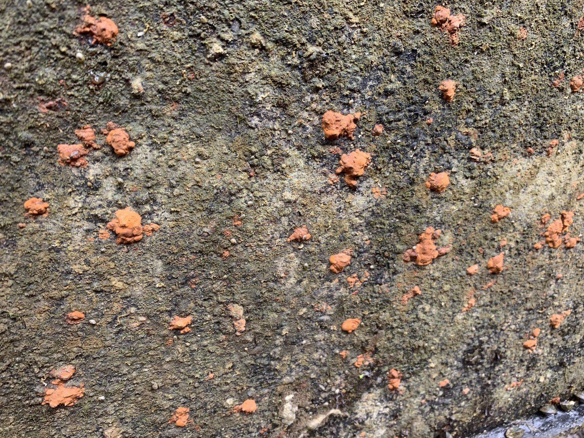

9 minutes ago, manxmike said:
In the end the galvanic action of boats moored either side of us and the MIC bug in the canals thinned the hull down to 2 - 3 mm in places, so we sold very cheaply.
Whilst I am sorry you suffered from the MIC, I'm pleased that you at least acknowledge its existence.
I am repeatedly told there is no such thing - 'estuaries & offshore yes', but 'canals no'.
I made the mistake of going through Chester and down to the boat museum at Ellesmere. What a mistake, stopping every 15 minutes to clear weed, MIC very strong down there. The boat museum was wonderful, but I wouldn't take a boat there again!
I seem to remember that a boat on the Chesterfied was diagnosed with it.
I wonder why people deny the existence of a bug that eats metal and excretes acid? Maybe because if they admitted it someone would have to do something about it?
The 'industry' acknowledges it, it just seems to be boaters with the blinkers on.
There are any number of scientic papers and industry presentations.
Extracts :
Boat owners and yards know all about rust. There is endless literature on electro-chemical and galvanic corrosion – all under the general heading of ‘rust’. But there are other types of corrosion which closely resemble (but are not) rust in the conventional sense about which little is known by boat owners and by many yards. This is a corrosion caused by microbiological action which is can occur on boat hulls, particularly those lying in canals or rivers containing high levels of chemicals or decaying vegetable matter. Microbially Induced Corrosion (MIC) is a highly unpredictable process but under the influence of micro-organisms, corrosion processes can be rapid, happening in a matter of months compared to the years it would take for ordinary abiotic corrosion to reach serious proportions.
This phenomenon is well known in the oil, gas, water and mining industries but is little understood in the steel boating world. MIC frequently occurs in areas with high nitrate content in the water – this particularly pertains to arable regions of the canal network and particularly to canals and rivers on the east side of the UK and where there is intensive crop farming using non organic chemical fertilizers with consequential phosphate, sulphate and nitrate run-off into the watercourses. Marinas fed by rivers are another risk area and, in salt water environments, it is well known that harbour muds are highly contaminated by sulphides produced by these creatures.
Sulphide films are, by their very nature, highly corrosive and the identification of such very obvious. It is usually found under muddy and slimy surfaces, sometimes even behind paint coatings and a very careful visual inspection is necessary to locate it. It is not discoverable by non-destructive testing such as ultrasonic thickness measurement, eddy current testing or the magnetic method familiar to most marine surveyors. The bacteria are often found inside oxidised welds or in areas which contain physical defects such as porosity, overlap or lack of penetration. The microbes leading to this condition can both cause corrosion from beneath existing coatings or seek out pinpricks in the steel coating and cause the reaction to occur from the outside. MIC bacteria can be present under previous blackings and is not eradicated by simple pressure washing.
Unless correctly treated, MIC can continue to thrive beneath the coating, emerging as major pitting.
and
These organisms are commonly found in ballast tanks where the vessel has ballasted by taking on muddy river water or lying in the mud of harbours or in the waters of canals particularly those running through farm land where surface water often deposits chemical fertilizers into the canal. The author discovered the severity of the problem some forty odd years ago when employed as a superintendent engineer for a company running a number of general cargo Liberty ships which often loaded ballast water for return trips from the West African coast. The ballast water was, from the nature of its loading from the rivers, often heavily polluted with vegetable matter and very muddy. On inspection of the ballast tanks at the classification surveys very severe pitting of a clearly defined and characteristic type was frequently found under mud deposits in the tanks and a great deal of time - and money - was spent in trying to find the cause of the problem. It was eventually identified as microbiological in origin when specimens of the corroded steel were sent for laboratory analysis. The per diem corrosion rates were often as high as 860 mg/dm2 or, if it is easier to understand, pits several centimetres in diameter, 8 to 10 millimetres deep were often found in 18 millimetre thick mild steel plates in less than two years.
Interesting read https://www.iims.org.uk/wp-content/uploads/2019/11/Biological-Attack-on-Iron-and-Steel.pdf

Another example of the rapid corrosion of steel hull plate in a ship’s bilge was reported by Campbell et al in which pit depths of 8 mm in 12 months were recorded.
One of the earlier reports on the problems of suspected MIC in a ship’s bilge was made by Copenhagen in 1966. Localised deep pitting including perforation of 8 mm mild steel plate located near the propeller shaft casing in the ship’s stern occurred in less than 2 years.
 In 2007 Mart reported several examples of suspected MIC in RAN vessels including one case in which 10 mm bilge shell plating was penetrated in less than a year.
One of the highest corrosion rates reported that was suspected to be due to MIC was the perforation of 11 mm hull in less than 6 months.
I do wonder if MIC is the problem @WotEver had (one side of his NB 'disappeared' within 18 months)

It has been denied for so long, and it is having such a serious affect on shipping that the Surveyors Professional Bodies are circulating information with 'what to look for'.
Known cases on the canals are few and far between but (like Covid) I reckon there are a lot of un-diagnosed or mis-diagnosed cases.
This is one of the documents circulated amongst surveyors
This is a document produced by Steve Hands (who is a Surveyor based at Sawley Marina), it is based on the IIMS document above, and he uses it to try and 'spread the word' using just a simple, single page document.
http://handsonmarine.com/microbially-induced-corrosion/

You can't win with underwater problems. Boat has never suffered from MIC (As far as I can tell) but is now in slightly brackish water in Belgium. Bottom now seems to be covered in blasted barnacles and mussels. Next year, Covid permitting, will be in France where no doubt it will be attacked by something else.  I seriously wonder if steel is the best material any more. Riveted iron? GRP? not wood surely?
