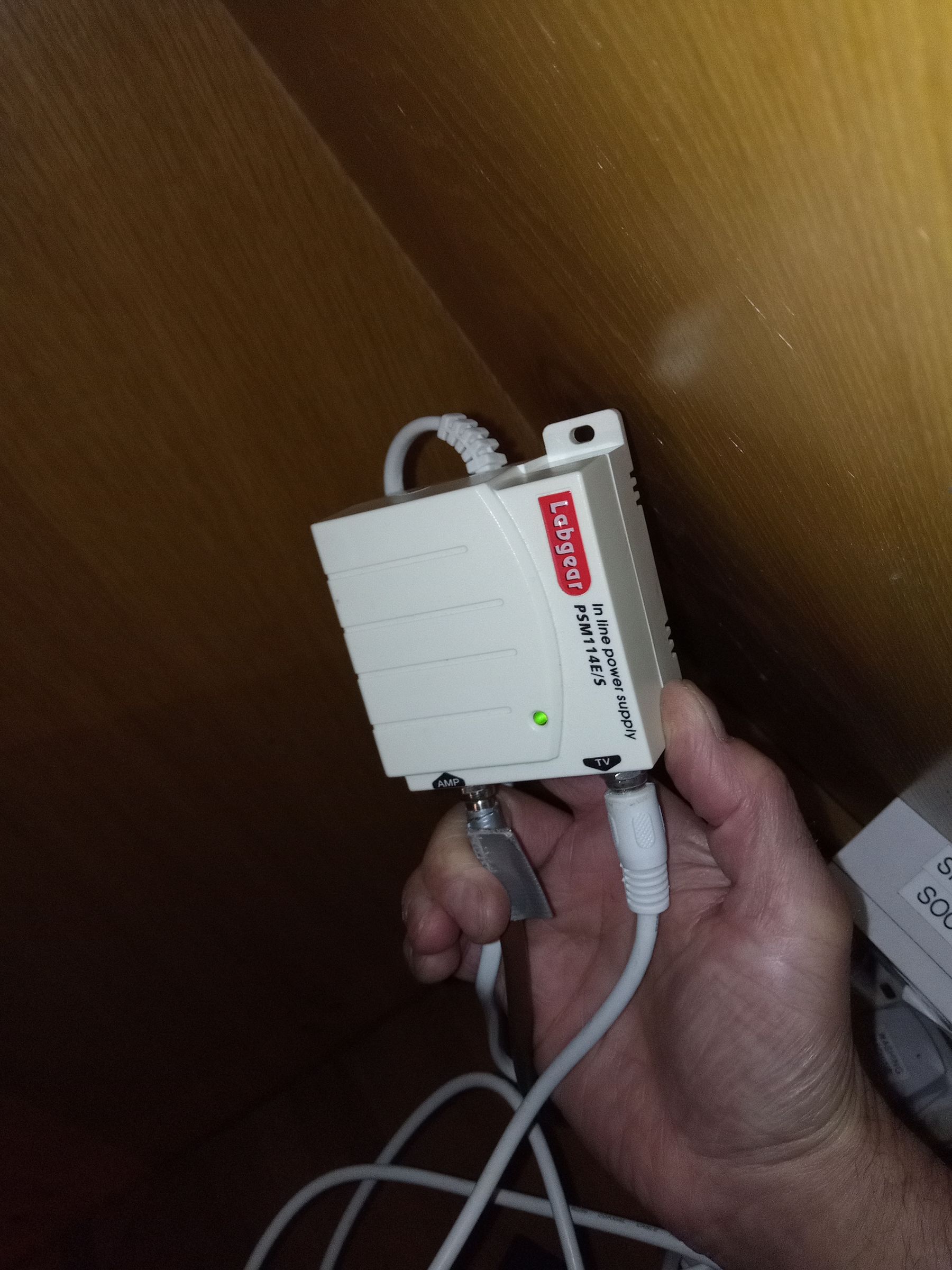

I've had a good digital Freeview signal since I came back to my mooring a few weeks ago. I was just watching TV when suddenly the TV went blank and now it's saying "no signal"
Can't understand it? Nothing has been touched. I've got one of these things. Maybe it's gone faulty?
Just did an auto-tune but nothing

It looks a bit as if there may be a problem with the brown aerial lead to  plug connection. If the smallest whisker of the braided shield touches the centre conductor you do get the symptoms you describe.

I've no idea about the transmitter. Just pointing my antenna in the same direction as everyone else. I have a signal meter for the satellite dish - will that work for the digital antenna too? The thing is I already know I don't have a signal so what the meter going to tell me that I don't already know? Anyway I've resorted to streaming TV on my laptop so won't need to go to bed early. I'll try to sort it out tomorrow.

No that's just a bit of duck tape. There's no problem with the connections. I checked them all. One minute it was all working (as it had been for the last 3 weeks) and then nothing. It just cut out as I was watching it.
The Labgear power supply has a green led indicator. I'm fairly sure that it only illuminates if there is a good connection to the antenna. It is still illuminated as the picture on my original post shows.
https://www.labgear.co.uk/wp-content/uploads/2016/11/PSM114ERP_IM_V3_2.pdf
"The PSM114E/S has automatic short circuit and overload protection and will cut out automatically when either is detected."

Sore-id. One of the coax connectors going through the engine hole had corroded slightly and I think it must have shorted or continuity of the core was interrupted. I guess the green led on the power supply doesn't indicate a healthy connection after all. Anyway I replaced that connector and the TV is working. Fortunately it was the first connection I checked so the gods were on my side today. Thanks for those who responded and Tony you were right (again) just a different connection that was faulty.

As it just inserts DC current onto the up lead I could not see how it going faulty could blank the signal, degrade it possibly but not blank it.

The signal went faulty as I was watching TV and it just went blank so I assumed it must be a component, but of course when there's some moisture around any connection can gradually degrade to a point where it no longer works, and if that happens to be when you're watching TV then that's when it stops working.
