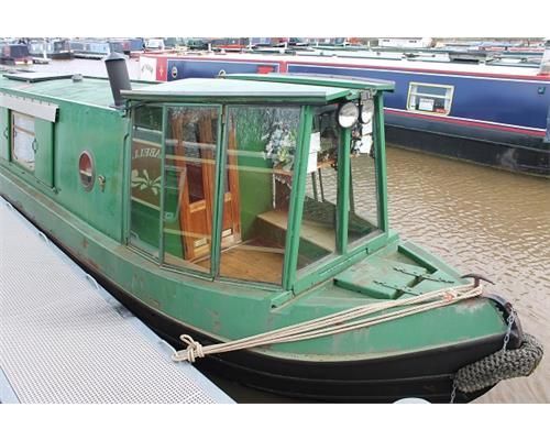

Thanks big d, I saw this too on Pinterest.
It's ok but we'd want to be able to open the windows too in summer. Maybe we'll have to design something ourselves from conventional house windows or customised nb windows

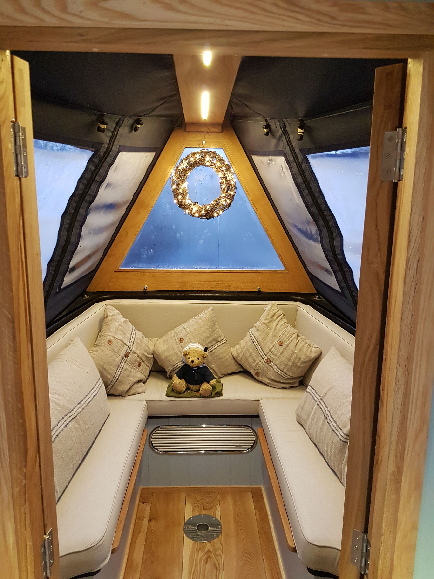

Our floor is at the same level right into the prow deck we can walk straight into it without crouching down....that's why we had it built that way....
.I'll try to post pics ehich may help

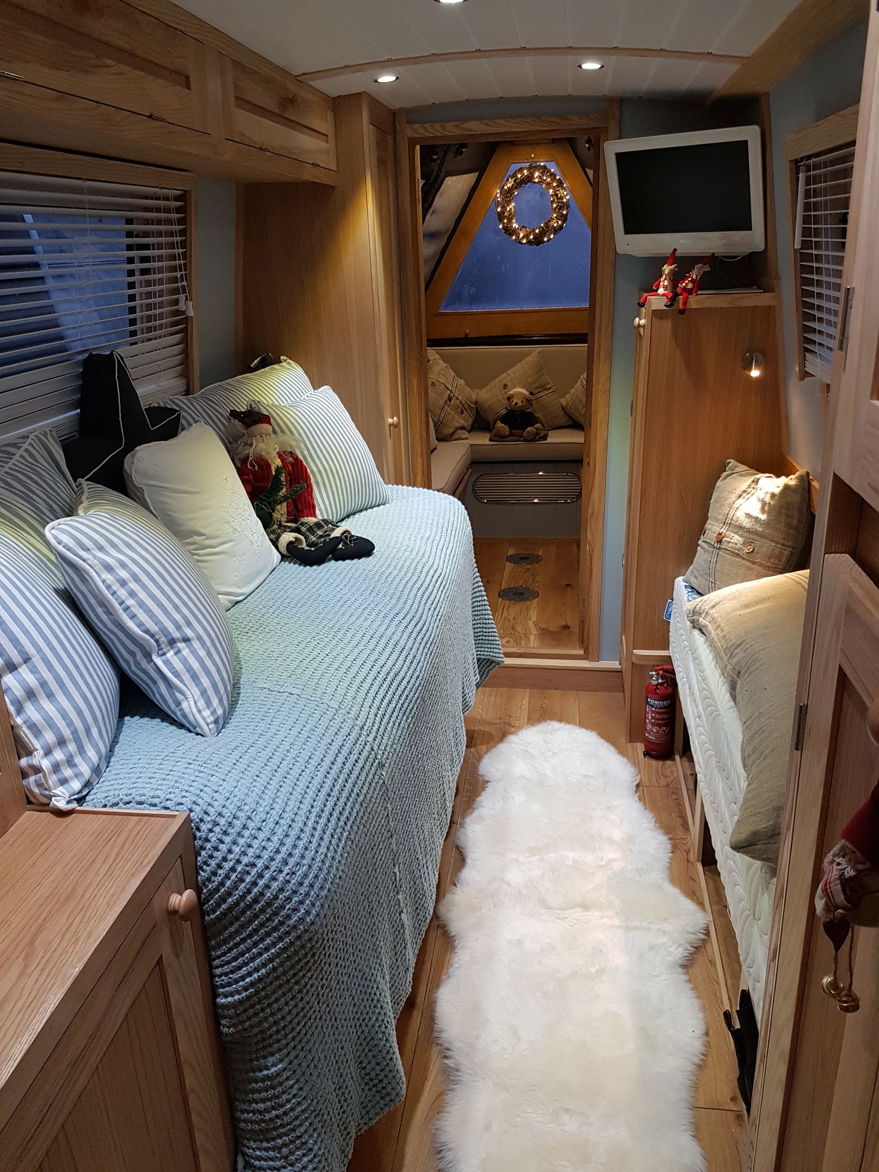

Here you go....much easier to see photos than to describe ? the table obviously slots into the Desmo fittings in our prow "snug " which is where we are considering something to replace the current cratch canvas arrangement. The bed folds away to enable free passage through the boat during the day and simlpy drops down across the full width of the boat at night.
Yep enclose that in double glazed windows and a specially formed roof you will almost certainly stop any leaks. I do wonder how much extra condensation you will create though without extra ventilation.
