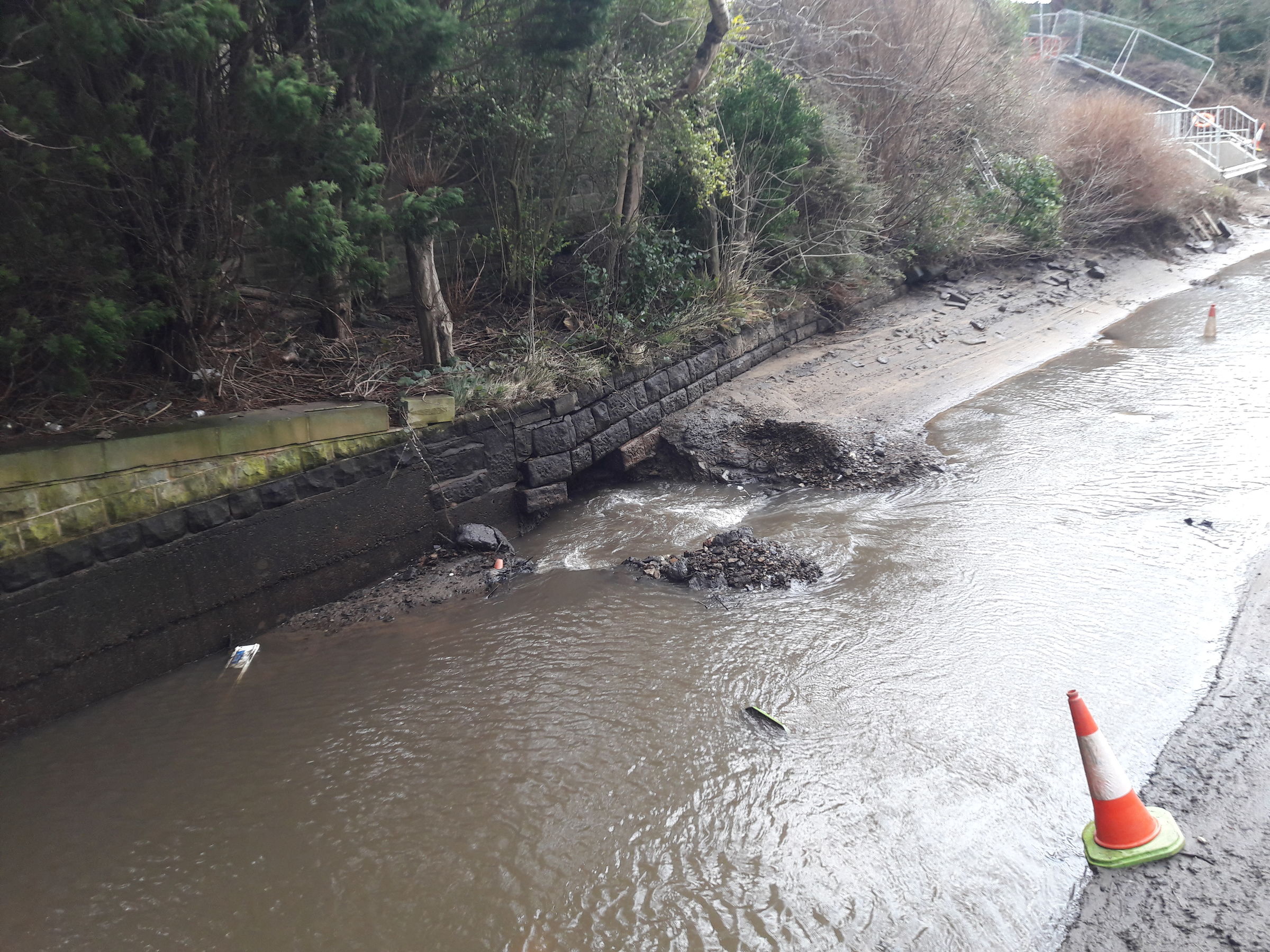

The canal at Mytholmroyd has emptied into the culvert which passes beneath just east of bridge 11.
Judging by the mounds of debris I assume the culvert failed upwards due to the amount of water passing through from storm Ciara. There was a similar failure here 4 or 5 years ago. Ironic that a storm overflow for the culvert (which you can just see in the background) is currently bring built as part of the Mytholmroyd flood alleviation works (which failed spectacularly on Sunday), but is not yet in use.
The empty pound shows how much debris has been brought into the canal by streams and culverts which empty into it.
There must be similar shoals awaiting unsuspecting boaters along the rest of the canal.
Both mounds have tide marks on them suggesting that they built up while the canal was full, and so the culvert failure occurred quite late in the flood.

The water is pouring out of what was called a wrack dam on the Rochdale, designed as a stilling basin to keep the canal from siltation. They should be cleaned out regularly, though even if empty I doubt if they could have coped with the amount of material that was brought down here, though it could certainly have been reduced.
Many of the stilling basins are never cleaned out, as far as I have seen, going up and down the Rochdale.

It's good to see they have marked the navigable channel with cones though.

Looks like its just marking the location of that shopping trolley to me....they mark the channel with sticks on the Rochdale.

That's to guide the big old historic boat they are sending up from So'r'by to cut a new channel. They are always bragging about doing that.

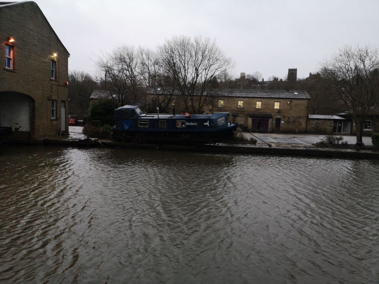

Decided to take a wander down after we saw one of the Elland boat's up our way...
Hmm, the old C&H boat Hebble moors next to that.
I wonder why they didn't take precautions to stop it grounding.
