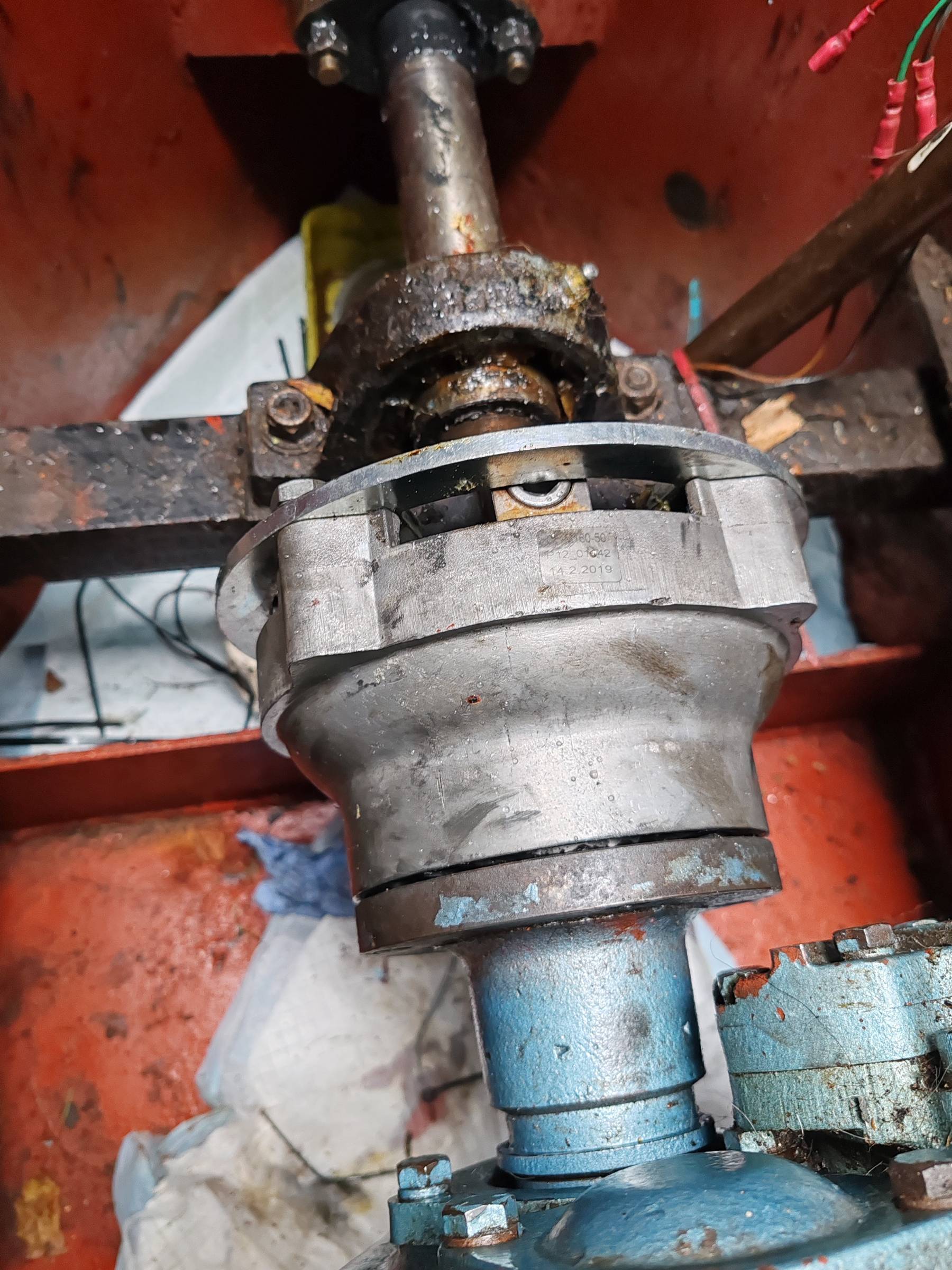

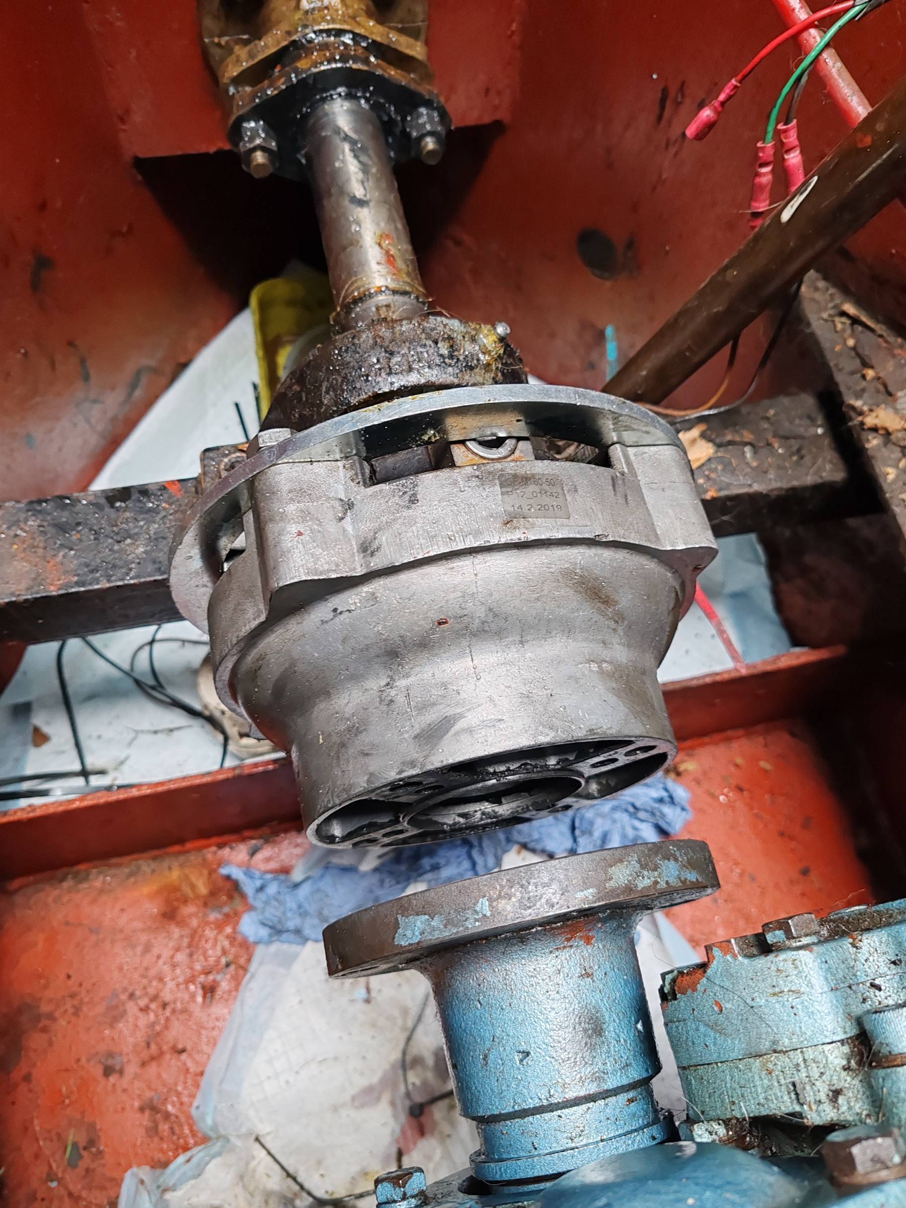

Collaborator

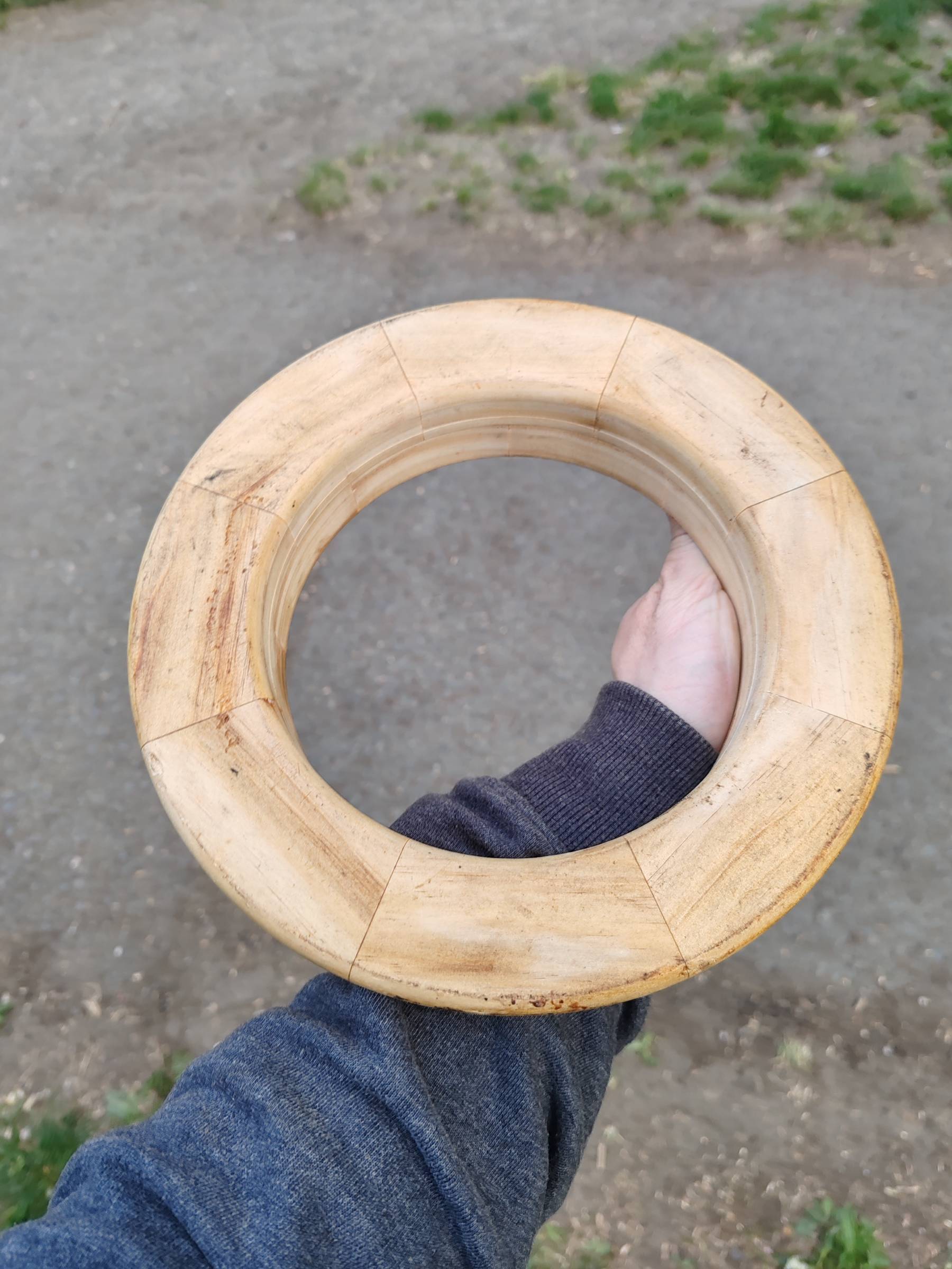

  5. @LadyG realised I never linked some images of the wooden port hole liner a friend did as a test run The pictures were too big for the forum, so I've uploaded one. Here's an Imgur link to see the others : https://imgur.com/a/vF2allc One bigger port liner and one smaller one They look a tad scruffier now. Been banging around in my boot and had an oil bottle leak also!

  7. Yeah it was two stripped threads for us also! We our lucky in that out propshaft is quite easy to access and so apart from the cold water I was able to hold onto it and slowly shift it back without too much fear of losing it. Our only other obstacle was ensuring we had got the flange holes enlarged properly. It took a bit of time because we couldn't get the flange off, so had to do it insitu... Not ideal but patience has hopefully paid off.
  8. So, coupling rethreaded, refitted, and given a small test spin. Everything appears to be fine... Fingers crossed. We going to do a small move on Monday so will know more by then! We ended up making the holes slightly bigger than rethreading them. Had to increase flange holes also as someone mentioned. Wouldn't have managed this without @Rincewind kind clarity about how to get the thing off (we had spent a good hour prior to my post doing all kinds of nonsense while trying to not lose or break anything!) Total cost was £70 for the rethreading bits. Hopefully this lasts us at least 5 more years!

  10. We are going to attempt what Kingdom Isambard Brunel has suggested. This original coupling cost us about £350 when we got it, around 5-6 years ago. A straight replacement appears to now be around the £600 mark. So if we can rescue it then that's what we would prefer. Also we can then try and make it last longer as well. Worst case we buy new. It's also been a great learning curve for working out how to replace it, so certainly worth the effort regardless.
  11. Hurrah! Thanks for the help. We got it out and now due to work out a rethreading fix!
