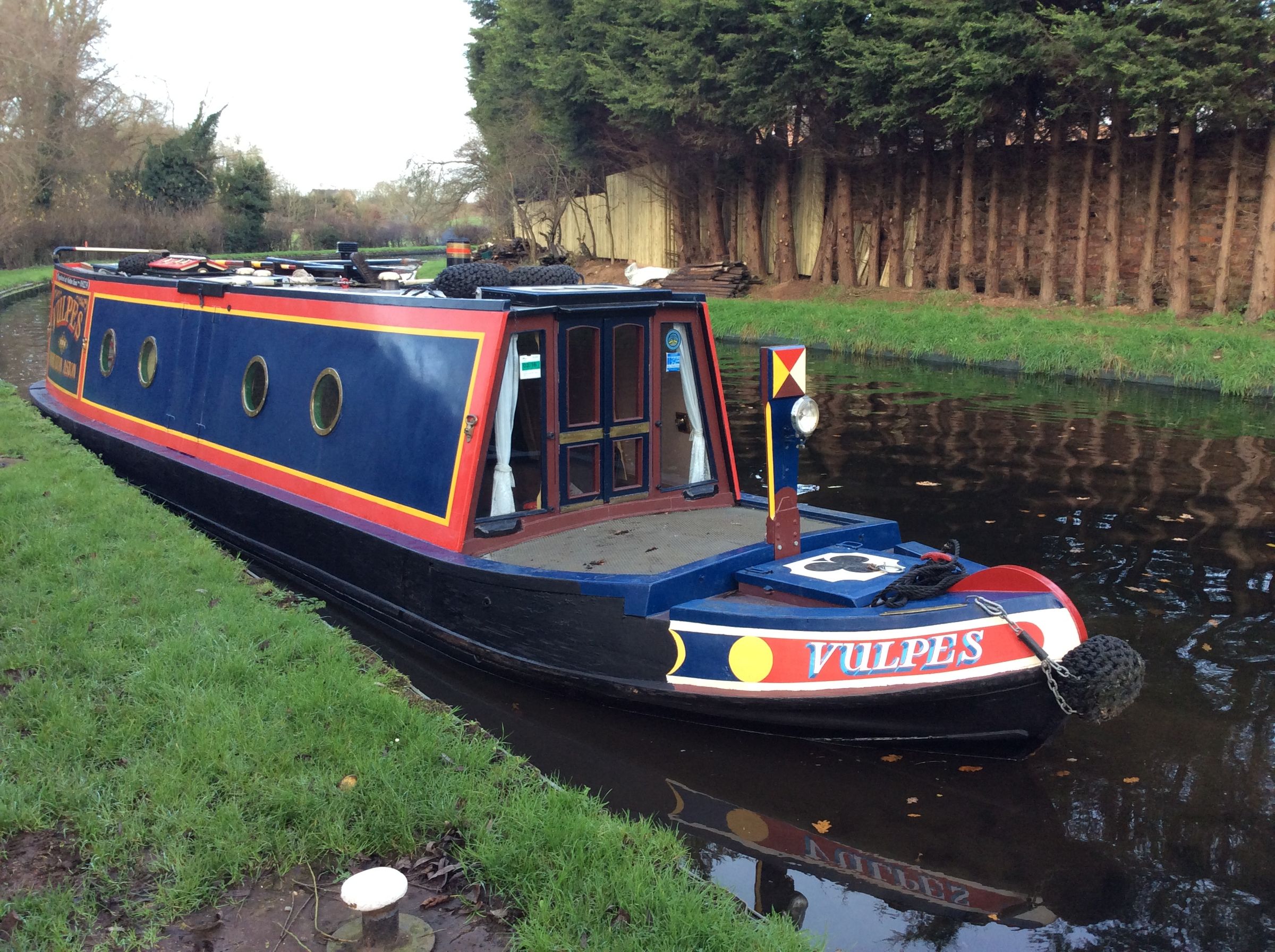

I had Treadmaster on the front deck when I bought my boat. The seal to the cabin structure had failed and water was dripping into the cabin.
Getting the first layer off was easy but that’s because there were two layers and water had infiltrated the space in between. There is no way the adhesive will be stronger than the steel so unless you have inadequate fabrication or very rusty steel you should be able to remove it. I could only clean the surface of the steel mechanically prior to painting.
The job still isn’t really finished four years later because I need to replace the timber valance I built across the front of the cabin and get the deck scuppers sorted to drain the deck properly. There was an ad hoc arrangement of filler both above and beneath the Treadmaster to get get fall and direction into the pathetically small scuppers through the cants. Thankfully I know someone who will do that for me later in the year.
I’ve attached a before and an after photo (taken four years apart).
JP
