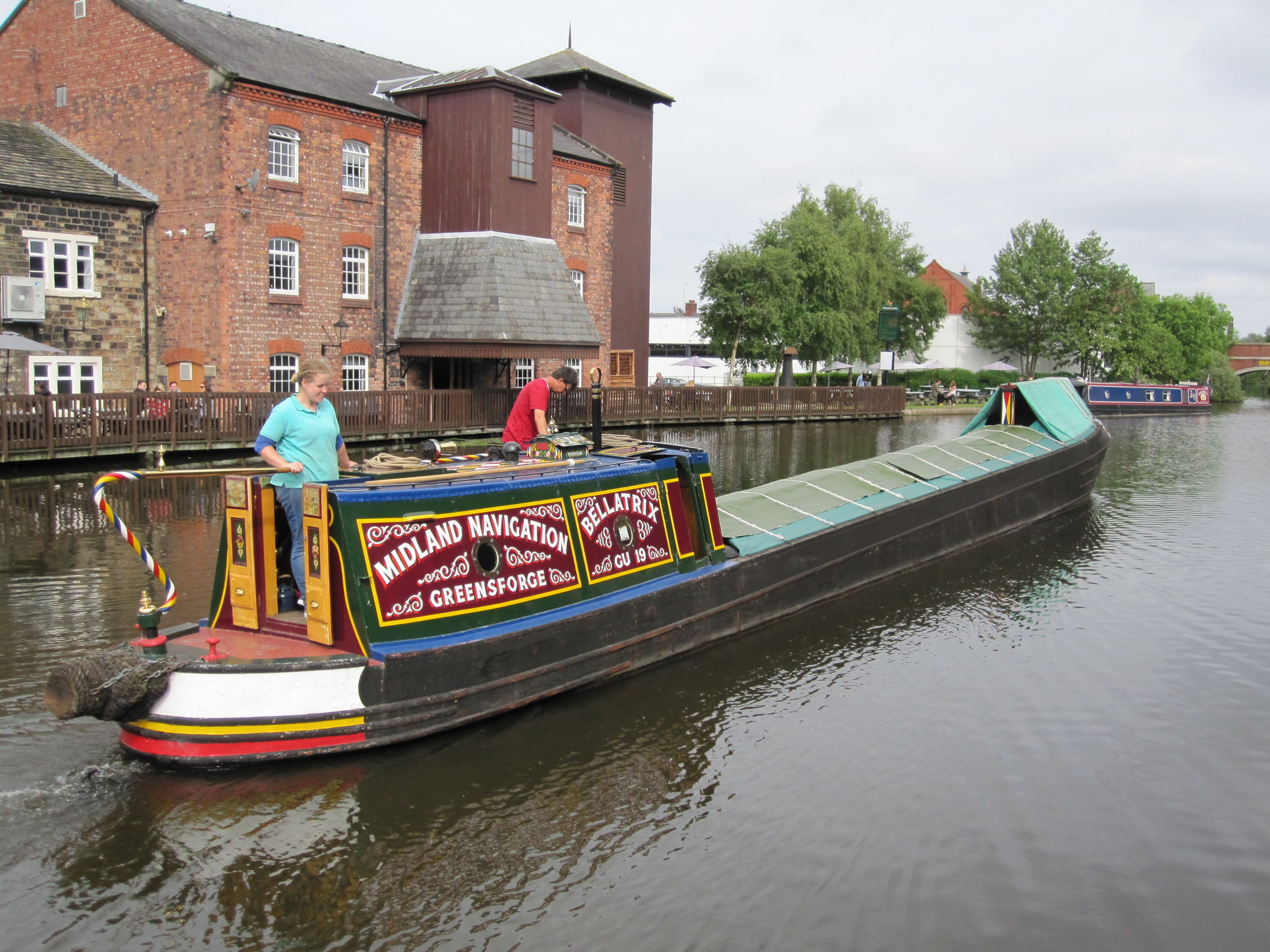

Has anyone had a historic boat through the Standedge tunnel in recent times?
We're hoping to take Bellatrix (small Northwich) through at the end of September.
Anticipating a lot of arm wrestling with CRT. Ability to quote the previous experience of others would be helpful.
Note the beam though - 7' up to 21W, 6'10" after that to Huddersfield.
You might need the grease pot out again!

Your exhaust pipe may have to be removed and you will probably have to ballast the bow down.  I can't see a major problem if you meet the profile requirements on the link.
https://canalrivertrust.org.uk/places-to-visit/standedge-tunnel-and-visitor-centre/boating-through-standedge-tunnel
We've got some IBC's in there just now,so we can put 31/2 tons of water in if necessary. Also we can take the cratch down.
We've had the grease out often enough with Ribble.Not that she's oversized - It's just that L&L gates don't go back far enough!
Bellatrix is remarkably straight, and almost certainly less than 7 feet - and we only want to go to Marsden for a wedding, the turn round and go back again.

Are you sure about that? Back in the 1960's,  I used to help work a Small Northwich, and as far as I can remember it measured seven foot and a half an inch across the guard irons The sometimes quoted six foot, ten inches is the measurement across the gunwhales.
As far as I can recall, they check your above water dimensions (fail and no go, no argument) but not much said about age, maker, purpose, draft or whatever. Not even sure that they checked the insurance but may have asked the question. In any event, if you don't fit you cannot pass but enjoy the reverse scenery on the way back down again.

Also, update and thanks to all who answered my original question. I measured Bellatrix today, and she is 7ft 01/4ins over the guard irons at the engine hole bulkhead, so that's the tunnel out for us.
