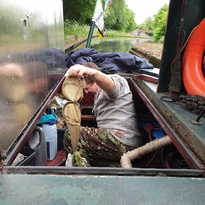

Any advice from experienced heads...! Just returned to our marina after quite a long cruise (during which I cleared the prop of plastic 3 times), and have checked the weed hatch again today as she felt a bit sluggish for a while at the end of our trip. We’ve pulled more plastic from around the prop again today.
The only real problem I picked up was that she was slower than usual, we only cruise very slowly anyway, but it worries me what damage could have been done by the engine working much harder (I guess) with all of the crap around the prop. Not sure how long it may have been there.
It’s a Beta Marine 43 engine on a 58 foot narrowboat.
Any thoughts, or advice appreciated.

Its the way of the canals, not a problem, just a damn nuisance. Poly bags do little damage, may wear a bit of blacking off the extreme end of the swim .
The wash was a short straight plume coming from the back which rather put me off the scent a bit...on the other occasions the wash has been very messy...

You're obviously cruising in the wrong part of the system....
Boating is not like driving a car where you're insulated from what's going on around you.
Boats need constant fettling and you need to be aware of the slightest change in sounds....
As long as you don't / didn't overheat the engine all that will happen (before there's so much rubbish around the prop that you stop) is that you'll use more fuel.
I was always taught that it's a good idea to select reverse and give it a short burst of power every so often.
The problem is that a small amount of rubbish will attract more and more and more - then a visit down the weed hatch is necessary and often very unpleasant.
You're lucky you have a Beta - even if it's a 43 - a BMC would have stalled long since.

 Didn’t pick up any change in engine tone...have to hang head in shame and admit to not checking the engine temperature. How would over heating manifest itself...?
4 minutes ago, Dunworkin said:
I’m guessing that if it was overheating then we’d have picked up some indications whilst cruising ?
Well - after the temperature gauge shows its running hotter than normal,
then it boils up
then it boils dry
then a final indicator is when the engine seizes up.
Edited by Alan de Enfield

For me, there was a noticeable decrease in forward motion and in two instances clouds of (steam) = water vapour.
OTOH on my first foray onto the canal system (we hired from Planetcraft - under Gravelly Junction...). On returning the boat the yard said "didn't you notice that there was a helluva lot of weed and rubbish around the prop?  You've wasted a lot of fuel...
Thus it's easy to criticise and easy to ignore the symptoms...

Problem with that is that if it's like my Beta 35/38 it will only have an LED, (although I have now fitted a gauge, which is much much better.) So just before the engine seizes up the red LED lights and the buzzer buzzes then the engine seizes.

There have been incidents where mechanical damage has resulted from something big and nasty suddenly getting snagged, but there's probably not too many members on here who haven't at some time caught their own mooring line and normally it just stalls the engine.  What you experienced certainly wouldn't have caused any damage.  Apart from the symptoms already mentioned, black smoke from the exhaust is another sign of a fouled prop.
You now know why the biggest misnomer in the English language is weed hatch.  I don't think I have ever had to use the hatch to clear actual weed from the prop.  Pretty much everything else that lands in the canal but weed, never.
Main thing I notice was exiting locks...normally just a click in to forward drive and she nudges out...but I was having to give a bit more throttle to get her underway....should have trusted my own suspicions and checked sooner...

Point well made....sometimes  a bit of smoke when first starting the engine but not noticed any black smoke whilst cruising...my normal attentions are focussed on how she feels, sounds and the plume in the water directly behind me.
It's not the change in engine tone,the boat just feels different/wrong.You get used to feeling that when you moor on somewhere like the BCN.?
