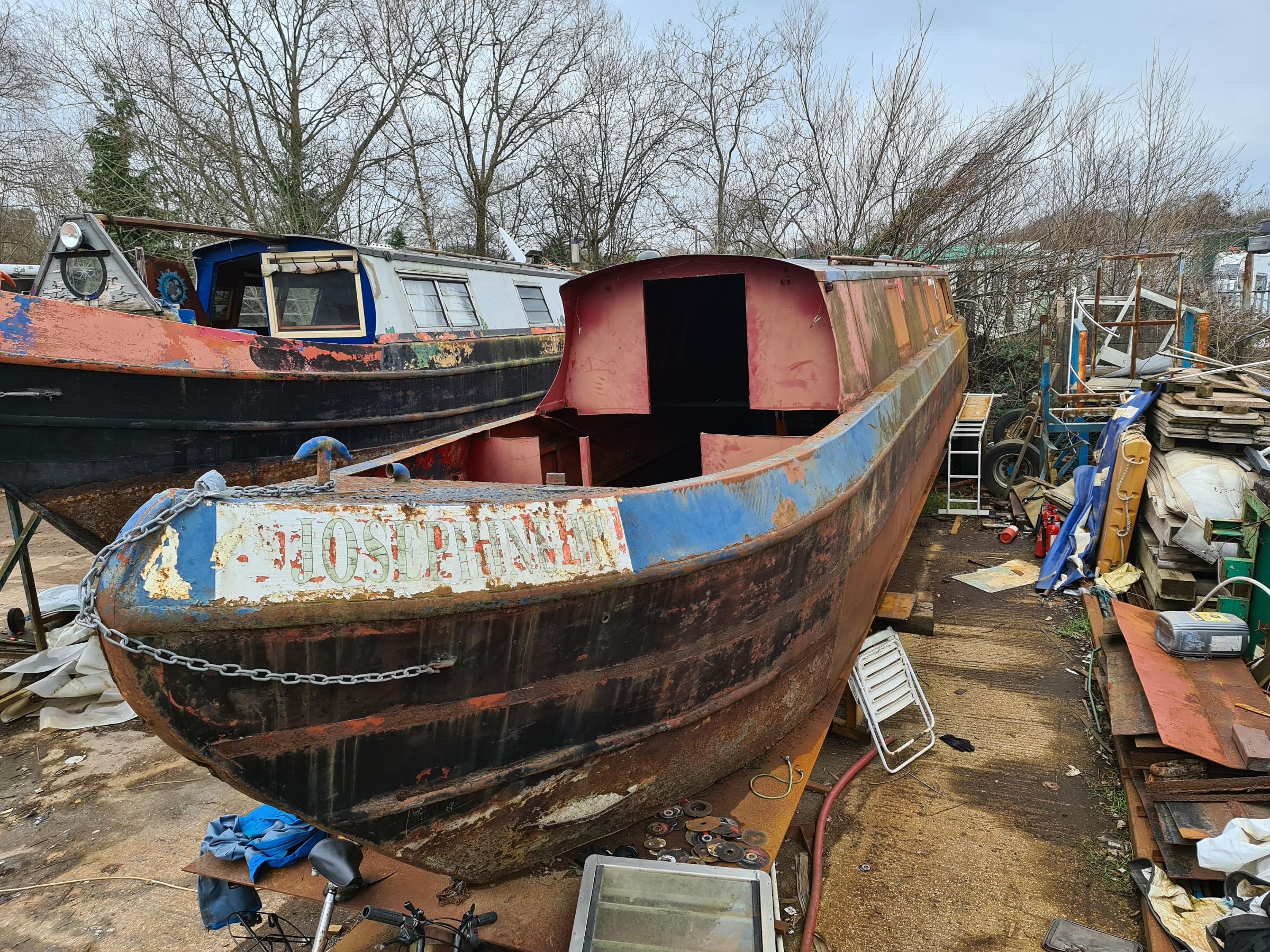

  29. Been down to the boat today for the first time this year, pleased to report that all is well. Did a bit more welding and measured up a few bits for the next steps. Thought I'd get some photos of her as she sits now, quite striking proportions! There's a few bits of life that are happening in the background that are a bit drastic but should really benefit the progression of this as a project, it's probably going to be moved to a more convenient yard fairly shortly
