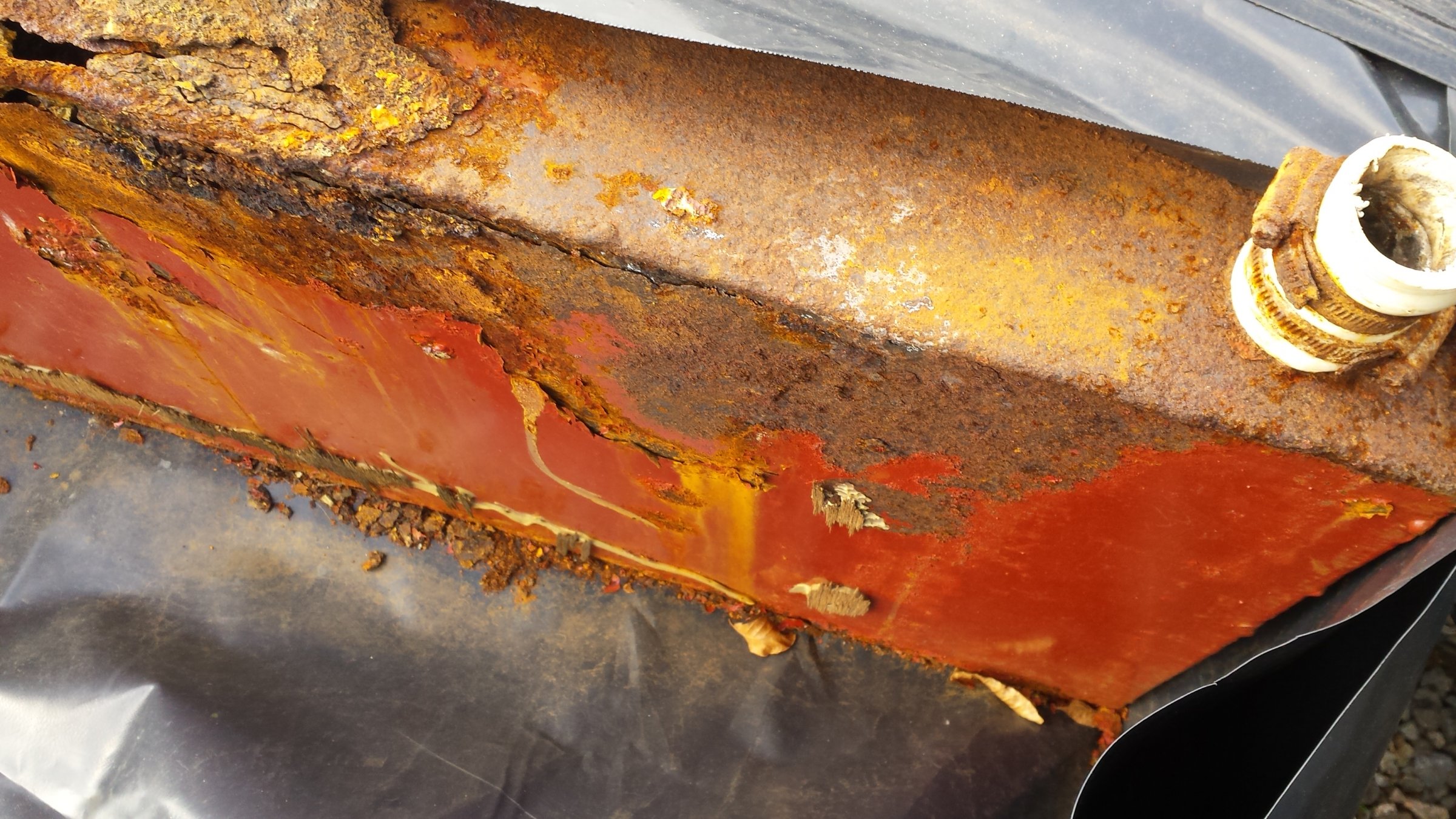

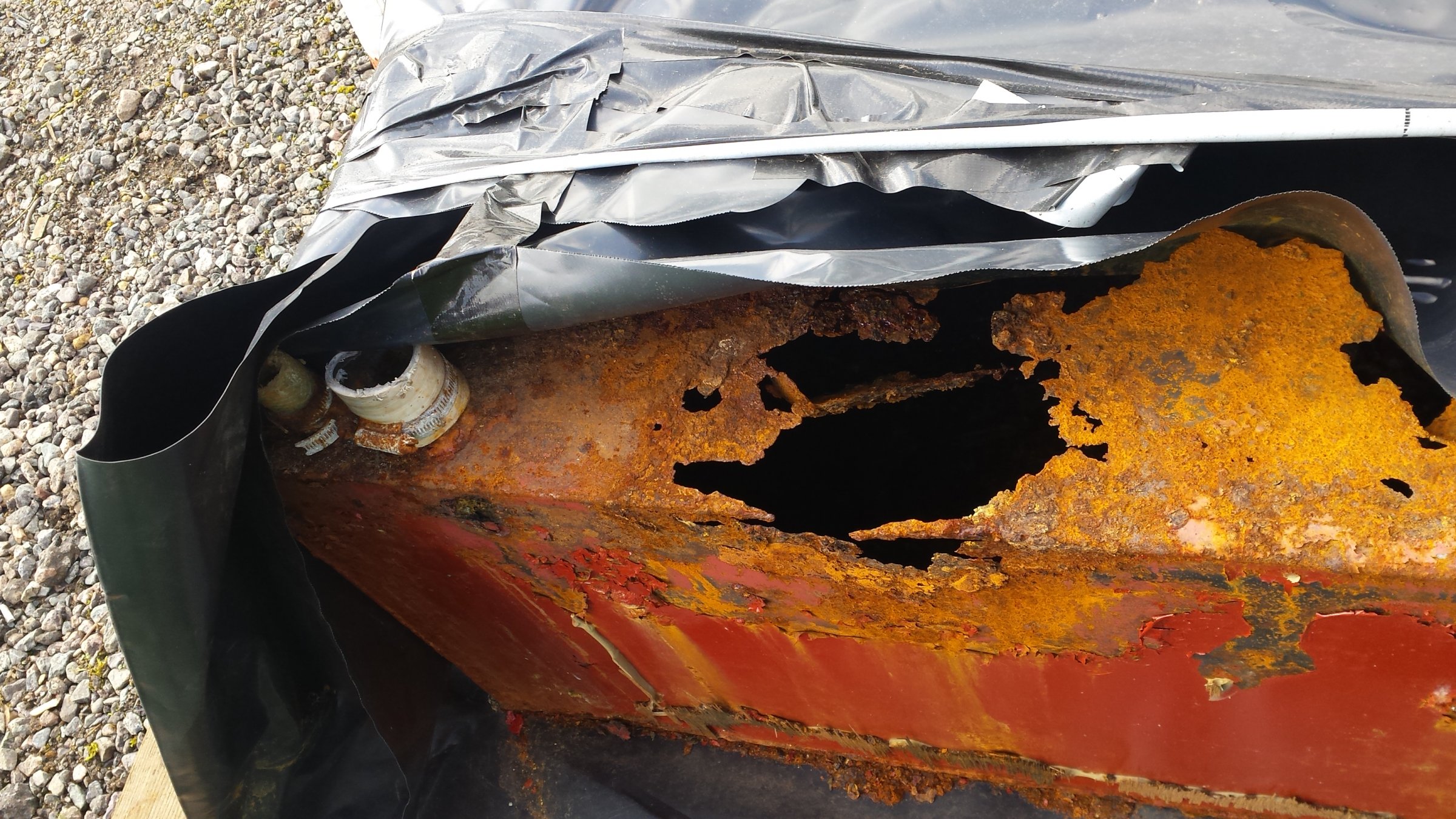

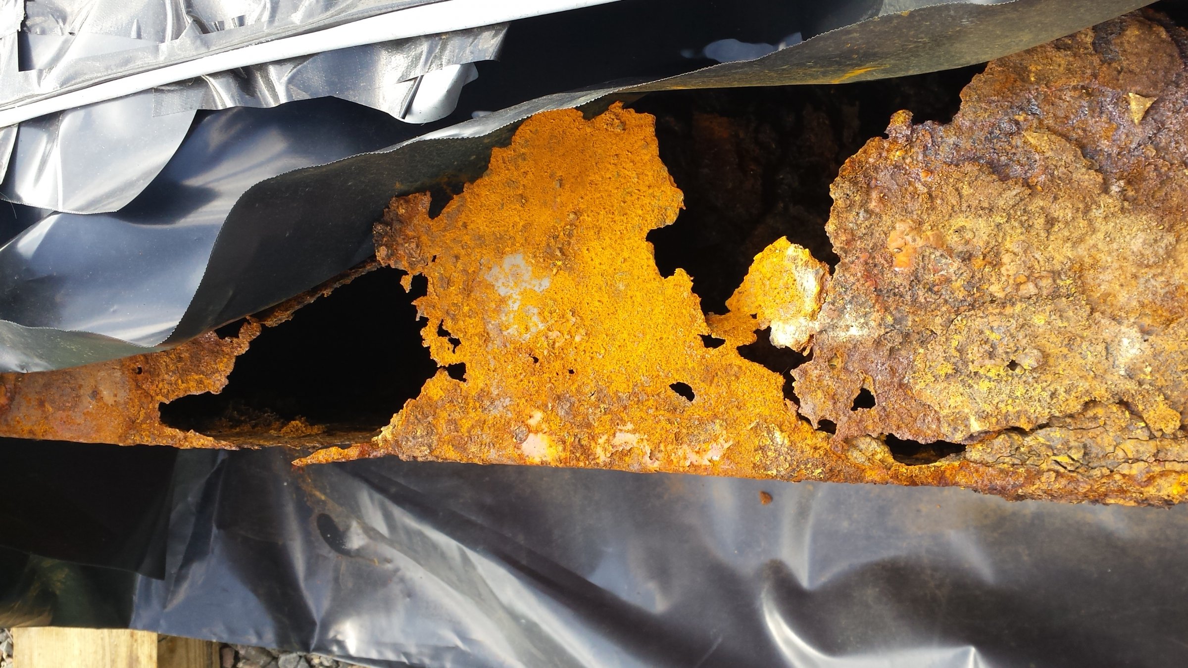

Hopefully this will focus your mind. The owner has had the boat from new (20 years), thought the steel tank under the bed was getting smelly this year.
We got it out.....just.
The owner had a pump out before we started...luckily.
New STAINLESS steel tank now installed.
Ooh dear.... that really needed doing! Surely the smell was there for a while!.? Mine isn’t that bad, but I’m def doing it now BEFORE it gets that bad!
I’m planning to replace it with a plastic one though. Can anyone suggest why I shouldn’t?
