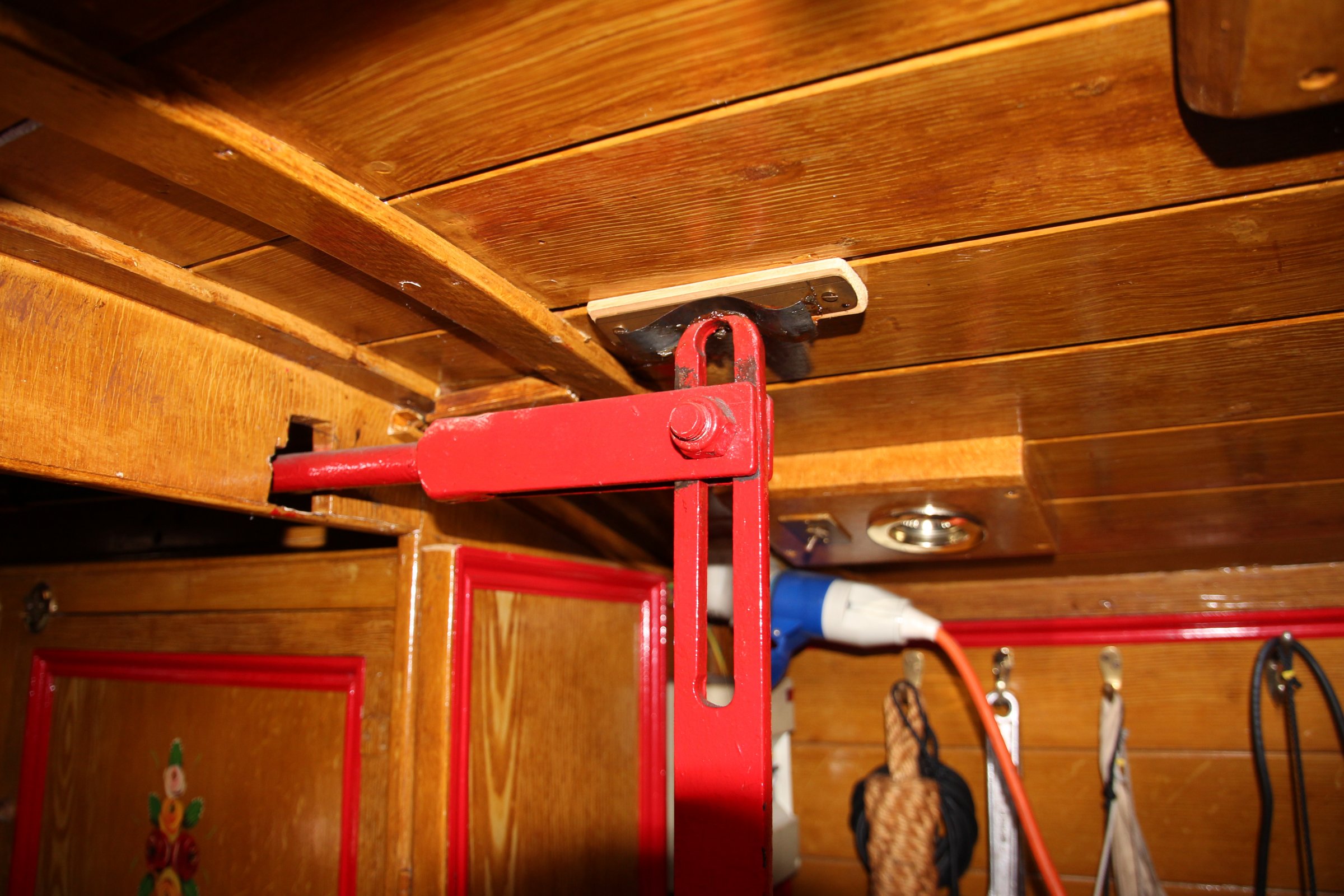

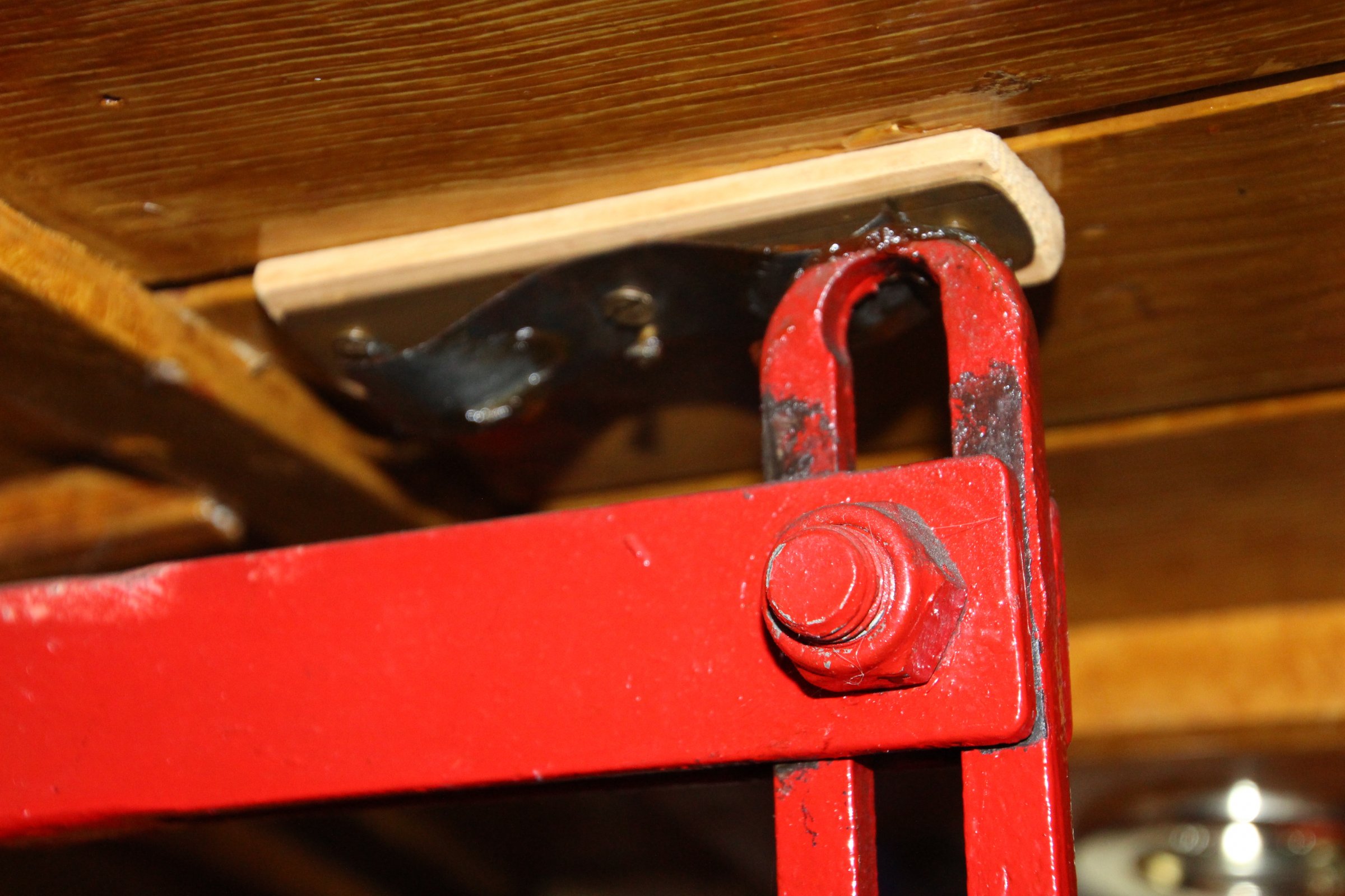

Hi,
I had a similar problem with traditional a 'pull/push' gear selector rod, I got a 6" length of thin 1" wide tempered 'spring' steel. This was slightly bent and the two ends heated and bent into 2 small pencil coils. I then made a small wooden block and made a hole in the middle of the selector rod and screwed both to the ceiling, A 'cam' was made and fastened to the rod, positioned in the center of the bend when in neutral. To select 'forward' gear the rod is pushed forwards and slight resistance is felt when the cam pushes past the end of the sprung rod, the same happens if reverse is selected.
Sounds compilcated? not really' will get a picture next time I visit the boat if you want.

On 2/18/2018 at 14:52, LEO said:
Hi,
L.
Hi, As promised, have attached a few pictures, let me know if you want more. The red gear lever, runs down to the engine and has lots more forwards and reverse movement.
L

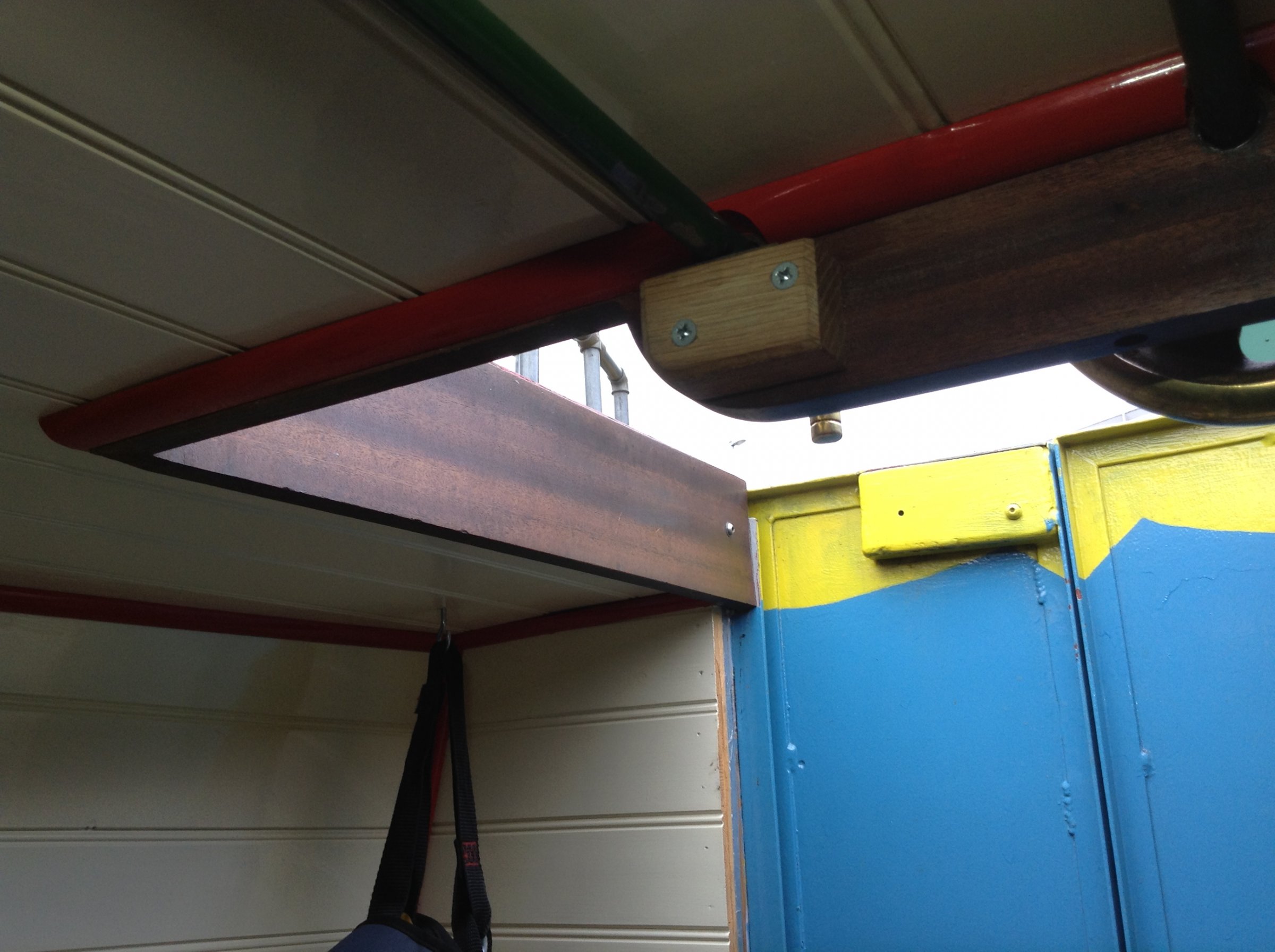

Not the easiest thing to see (or photograph) but this shows my solution.  In the small hardwood block, is a sprung ball catch (as found on internal doors).  A small countersink was drilled in the rod for the ball to drop into.  Along with the detent already in the gearbox, it seems to help.
Neat idea.
L
Thanks Leo for posting,  this looks a good solution.  My linkage is slightly different but I think a similar set up to this could work well.
 This looks good too and nice and simple.  Thanks for these ideas, certainly has the making of an absorbing Sunday afternoon project.  Typically that will probably involve me breaking something else in the process. Cheers Tom
