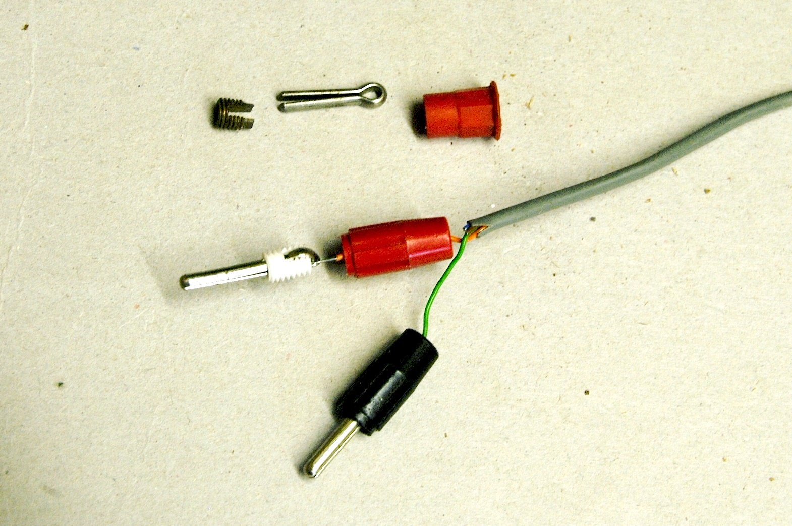

I am trying to source some plugs like the ones in the picture below. I need them to fit in an Electronic Model Railway Controller I had built more than thirty years ago, when these plugs were commonplace. I have tried ebay and tried googling images without any success, I am not even sure what they are officially called, although I have aways known them as "split pin plugs"

I don't think those are Banana plugs - Banana plugs are modern / common, are 4mm diameter and are solid with a longitudinal spring wire along the connector shaft.
My first thought was a "Wander Plug" which is a 3mm plug and split like your picture shows.
What is the approx. diameter of your plugs when both halves are pressed together ?

Yes Wander Plug rings a bell, and a Google image search seems to confirm that name. The ones I have are 3mm dia when closed up, but do not seem to be available any more. I found some on a vintage radio site but thet are unfortunatelyalready sold out. There are none on ebay, although ironicly there are several female sockets advertised.

Yes, they're Wander Plugs and are 1/8" diameter (3.1mm). Banana plugs are 4.1mm.
As far as I can tell, they're no longer available. You might get lucky with some old stock in an electronics shop (not Maplins, a real one) or else you'll have to change the sockets and use Banana plugs I think.

I have considered changing the sockets on the controller, together with all the plugs on connecting equipment, but I would rather not. I may resort to an idea I found on a vintage radio chatboard where someone soldered the wire to a standard 1/8" split pin (I have lots of them) and glued a (toothpaste) tube cap over the joint for insulation.

Sorry, yes, banana plugs are different.  I just had an idea I had used them many years ago in place of the plugs you showed.  Perhaps there was enough give in the sockets for them still to fit.
Maybe use some 3mm/1/8" split pins with self-amalgamating tape round the top to hold/insulate it.

The  best you can probably use now are  1/8 short split pins with some sort of  insulated cover. I remeber this shop well. May have suitable pins. Pm me for phone number, live locally  to you.

Thanks for that, I have already found more than enough 1/8" short split pins in my spares cabinet, and will be able to use those, suitably insulated with some shrink sleeving, but thanks anyway.

Split pin and toothpaste cap as suggested. Small hole in cap then fit with open top facing up. Mix some araldite/plastic padding/similar and force into toothapste cap to "pot" the soldered joint. Jobs a goodun.
