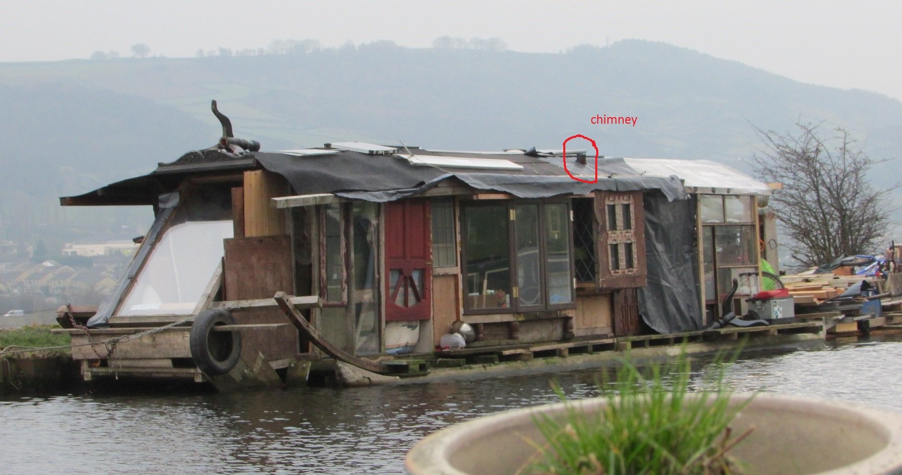

  6. Mike, no engine , no fuel system, no gas, but it does have a stove
  7. not sure how it gets a bss, but it has a reg no. and displayed a license, so it must comply.
  8. I think this is still floating its way around the system, man powered !!
