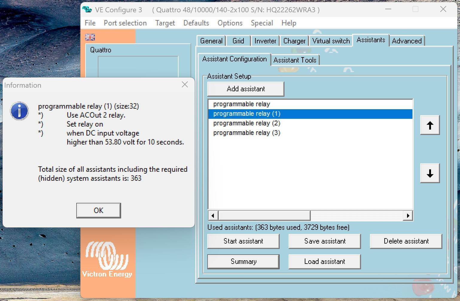

blackrose Posted April 29 Report Posted April 29 On 26/04/2025 at 20:34, booke23 said: How much solar do you have? You need quite a lot to consider a solar dump, and it will only produce significant amounts of hot water for half the year anyway. I'm still unaware of a solar dump system from a MPPT which can switch on/off a mains immersion heater. Is there some sort of simple relay system which could be set up? The only system I've seen requires replacing the mains immersion heater with a 12v immersion and they can be problematic depending on how easy the mains immersion is to get out.
b00ke23 Posted April 29 Report Posted April 29 1 hour ago, blackrose said: I'm still unaware of a solar dump system from a MPPT which can switch on/off a mains immersion heater. Is there some sort of simple relay system which could be set up? The only system I've seen requires replacing the mains immersion heater with a 12v immersion and they can be problematic depending on how easy the mains immersion is to get out. Me neither, and you’d think there would some sort of system to do this. I knew a guy with a manual system that worked well…..basically he had a 1kW mains immersion that could run off the inverter which he would manually turn on mid morning in the summer once his LFP’s were fully charged. Even then he had a heavy duty dimmer type switch on the immersion so he could vary the power as it was rare his solar could actually produce the full 1kW….as the sun got higher he could turn up the immersion. It’s not ideal in that it needs watching closely and constantly fiddling with, but it did produce pretty much all the hot water he needed for 8 months of the year. I think he had about 1.8kW of solar.
IanD Posted April 29 Report Posted April 29 1 hour ago, booke23 said: Me neither, and you’d think there would some sort of system to do this. I knew a guy with a manual system that worked well…..basically he had a 1kW mains immersion that could run off the inverter which he would manually turn on mid morning in the summer once his LFP’s were fully charged. Even then he had a heavy duty dimmer type switch on the immersion so he could vary the power as it was rare his solar could actually produce the full 1kW….as the sun got higher he could turn up the immersion. It’s not ideal in that it needs watching closely and constantly fiddling with, but it did produce pretty much all the hot water he needed for 8 months of the year. I think he had about 1.8kW of solar. You can do this automatically with some inverters/combis; on the Victron Multiplus/Quattro you can connect a 230Vac immersion heater to the second AC output (which is relay switched), and use an assistant to turn the relay on and off according to SoC -- in my case, 99% and 95%. I have 2.1kWp of solar and a 2.5kW immersion to make sure it can absorb all the power even in full summer sunlight. Once the hot water is up to the immersion cutout temperature the heating stops.
b00ke23 Posted April 29 Report Posted April 29 17 minutes ago, IanD said: You can do this automatically with some inverters/combis; on the Victron Multiplus/Quattro you can connect a 230Vac immersion heater to the second AC output (which is relay switched), and use an assistant to turn the relay on and off according to SoC -- in my case, 99% and 95%. I have 2.1kWp of solar and a 2.5kW immersion to make sure it can absorb all the power even in full summer sunlight. Once the hot water is up to the immersion cutout temperature the heating stops. Now that sounds ideal.

Alan de Enfield Posted April 29 Report Posted April 29 38 minutes ago, IanD said: ..........to the second AC output (which is relay switched), and use an assistant to turn the relay on and off according to SoC Is that the same as a Butler ?
IanD Posted April 29 Report Posted April 29 39 minutes ago, Alan de Enfield said: Is that the same as a Butler ?
