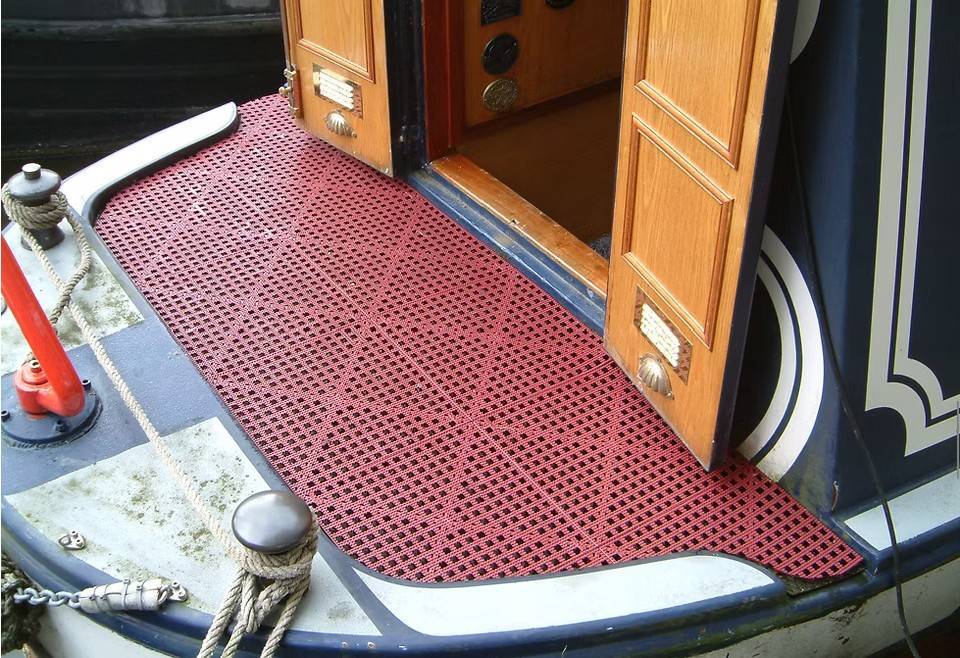

JoeC Posted April 16, 2025 Report Posted April 16, 2025 Try this for flooring ... Non-slip | Versatile Non Slip Flooring | England
IanD Posted April 16, 2025 Report Posted April 16, 2025 9 minutes ago, JoeC said: Try this for flooring ... Non-slip | Versatile Non Slip Flooring | England Thanks for suggesting that -- exactly what I'm looking for to put down on my stern! 1

Tonka Posted April 16, 2025 Report Posted April 16, 2025 1 hour ago, IanD said: Thanks for suggesting that -- exactly what I'm looking for to put down on my stern! Water still lays on top of the metalwork and slowly corrodes boat.
blackrose Posted April 16, 2025 Report Posted April 16, 2025 Just now, Tonka said: Water still lays on top of the metalwork and slowly corrodes boat. Which is why I've epoxied my locker floors and decks. I don't know any single part paints that can withstand what is effectively immersion for long periods without lifting.
IanD Posted April 16, 2025 Report Posted April 16, 2025 (edited) 3 minutes ago, Tonka said: Water still lays on top of the metalwork and slowly corrodes boat. Which is why they'll only be there when I'm out on the boat -- the rest of the time they'll be in a stern locker... Of course even without such mats water lays there every time it rains anyway -- and the paint (even two-part epoxy, which is what I've got) wears away underfoot, which leads to rust, which the matting will stop happening... 😉 Edited April 16, 2025 by IanD
