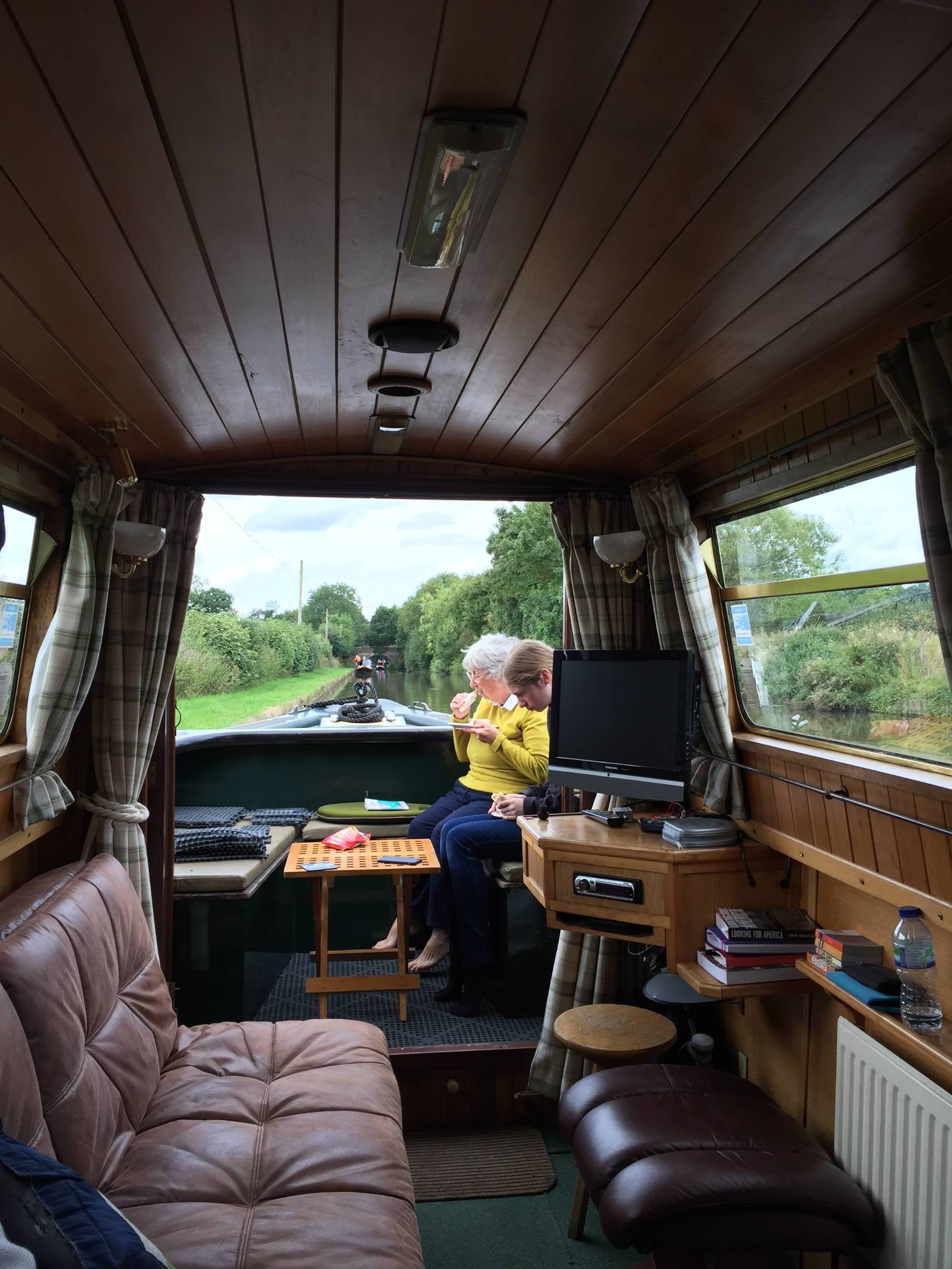

In all the years that had shares in Ownerships boats with corner baths I can’t remember ever using the bath! It was often a positive selling point for potential new owners who liked the idea. The bifold front doors, however, were useful for access and also made a great feature in hot weather.

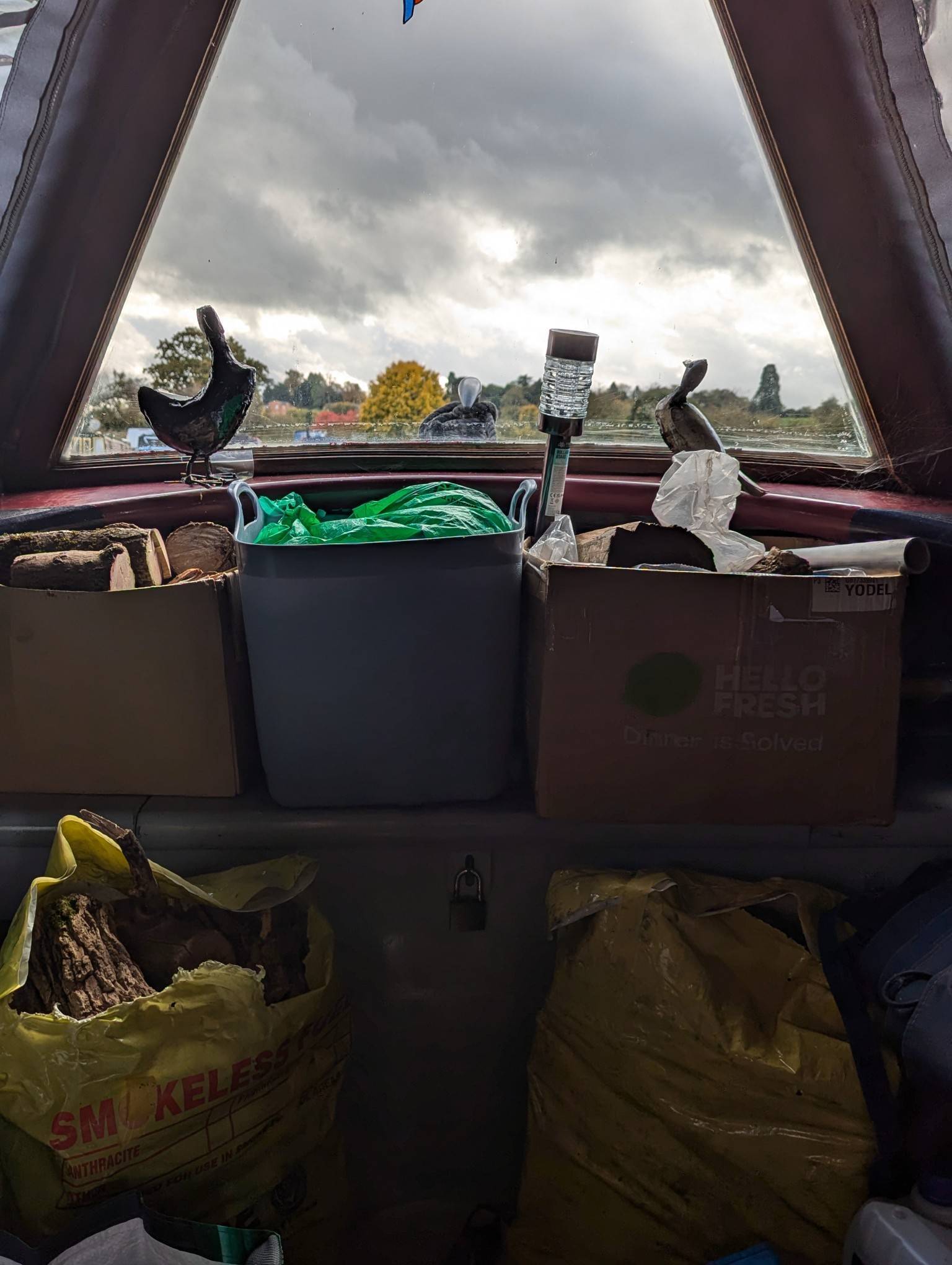

We've got a small bath and we use it all the time. Currently for storing a folding bike, a few weeks ago it had the spare toilet cassette in it, then before that it was being used as a spare towel 'cupboard'.
Also can't ever remember ever using it as a bath though 😀

Wot ! No coal?
Obviously middle-class.   😷
