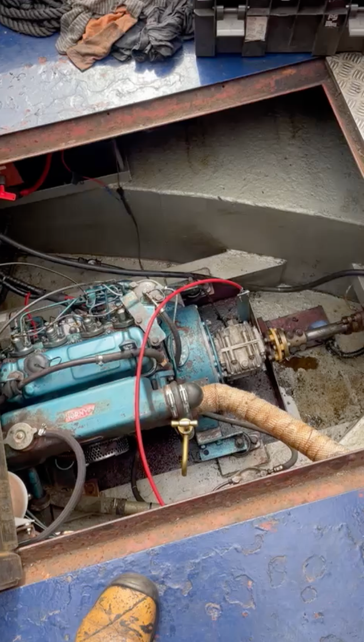

Thanks Matty- photo of engine FYI

20 minutes ago, MtB said:
Thanks for the photo.
Does it still do it now you've lifted the floor panel over the engine?
When I lift the floor panel, I can't hear the vibration over the sound of the engine. So, I'm assuming the vibration is continuing.

If you can hear it with the cockpit boards down but not with them up I can't see how it could be the engine. Must be 'external'. I see you have an aluminium checkerplate board(so did I). Check that it hasn't distorted slightly. Mine used to over a period of time and needed 'adjustment'.
My engine is an Isuzu 42 and the air filter casing sits just above the rocker box. With normal engine vibrations It has a habit over time of working it's way down till it touches the rocker box and causes a rattle just like you have. Cheers .
