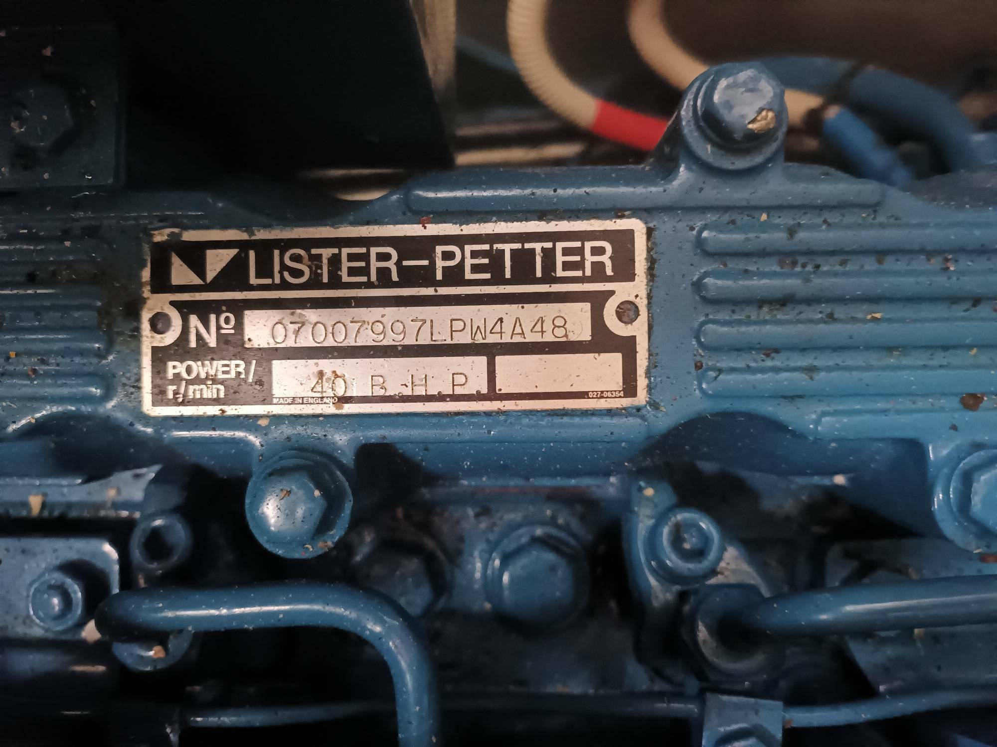

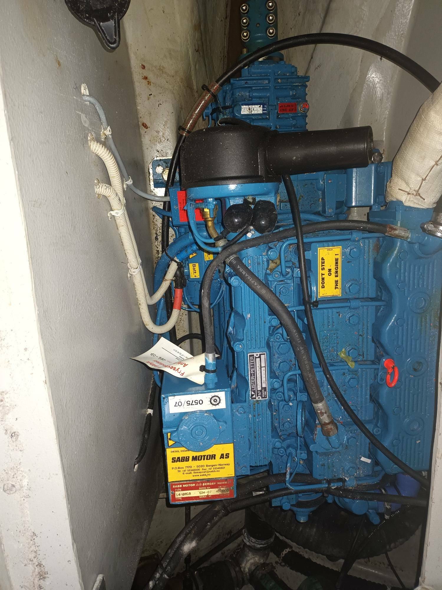

I have recently bought a boat with the pictured Lister Petter 40HP.
I understand it is not possible to determine the Lister Petter model from the serial number alone, so any tips on what this is would be very welcomed.
Ideally I would like to identify the type so I could get a full manual and drawings, if any are available on the light or dark webs.
Under Type it has "L4-186GB", but google had nothing to say about that.
Thanks
Is this the Mitsubishi Lister ?
No its a Sabb Lister
The engine Plate is glued on not riveted.

Are you sure the G isn't an L? Manuals come up for L4-186LB. A change in font from the L in L4 though.
It’s Lister Petter LPW 4 cylinder 40 bhp build 48 (marine build) built in 2007 also known as Canal Star or Alpha. All spares Manuals etc available from Richard at MES Midlands or Sleeman Hawker Dorset and others. Manuals and Parts List also available online FOC
https://www.sleeman-hawken.com/sabb-l4-lister-petter/

Thanks a lot. I got a manual from https://www.winget.co.uk/wp-content/uploads/2020/12/LISTER-PETTER-LPW-LPWS-OPS-MANUAL.pdf
The pictures are insanely bad I should be able to find better ones now with the full reference.
Thanks a lot everyone.
I think I'll be able to find my way around the engine somewhat...

Not really much of a connection. Sabb would purchase a marinised engine from Lister Petter and then carry out various modifications to make it suitable for lifeboat use.
6 hours ago, Steve56 said:
This engine would have been keel cooled so no worries about corrosion.
Without inspecting a particular engine, you can't be sure of that. Many sea boat keel cooled engines used  a raw water cooled manifold and then injected the raw water into the exhaust.
I can quite safely say that. During my time as a Lister Petter engineer I visited the Sabb factory in Bergen to assist them with the engine. Also as a lifeboat it is necessary to be able to run the engines out of the water for short periods, hence they would be 100% keel cooled. As the photo shows the engine is fitted with a dry exhaust.
