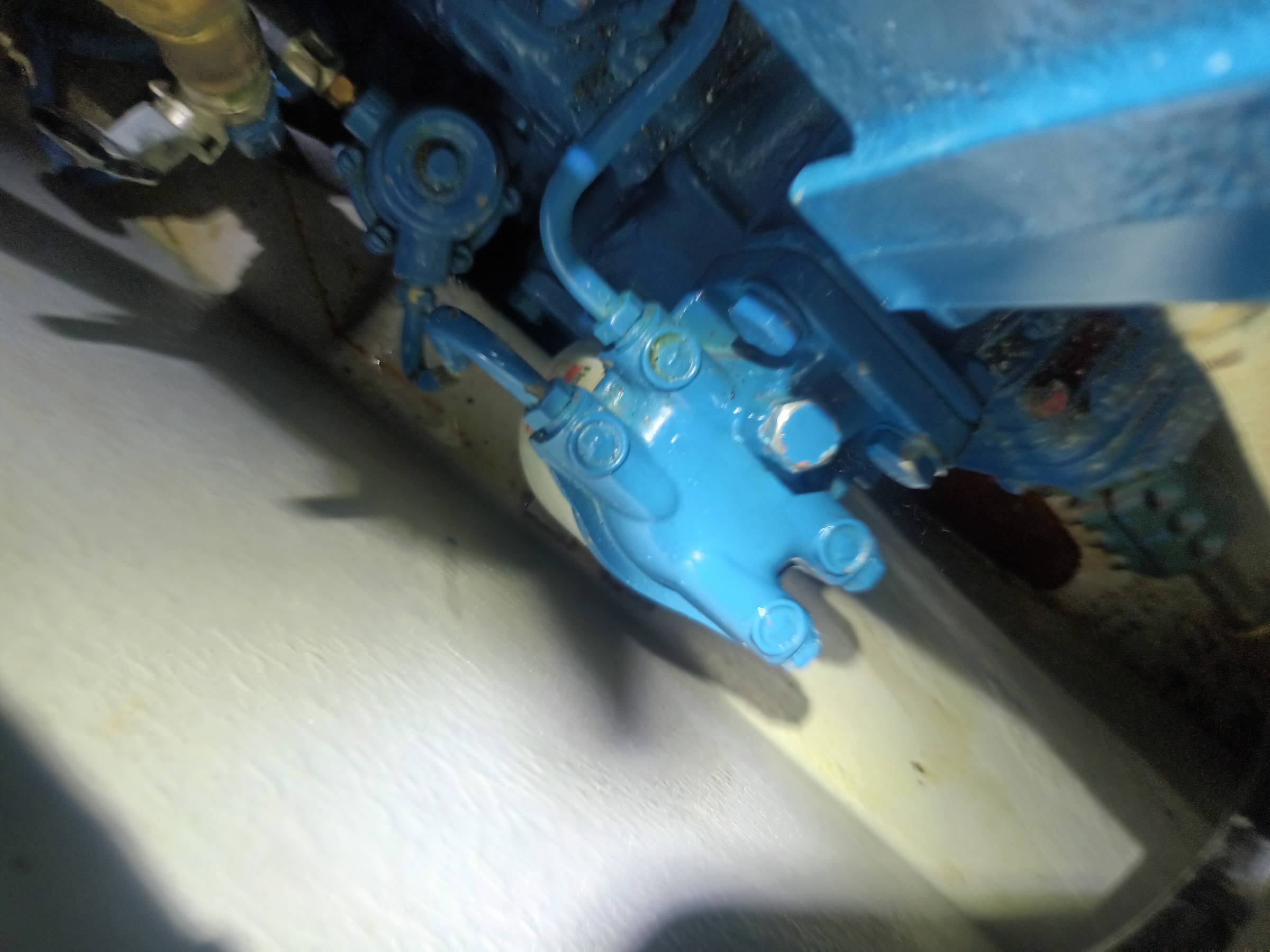

  • Interests

  • Occupation

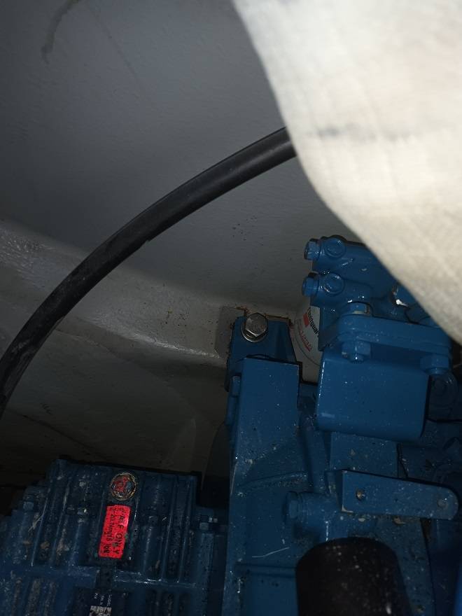

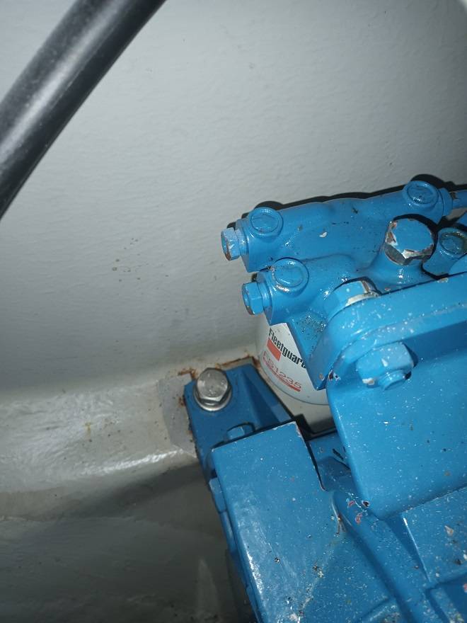

  6. Great. I'll have to feel my way to it, if it's even lower than the fuel pump. Access it terrible on these boats, but with that photo it should be ok. Thanks a lot Tony

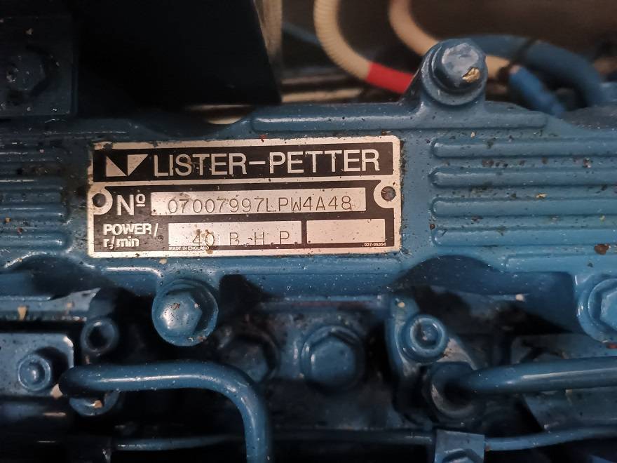

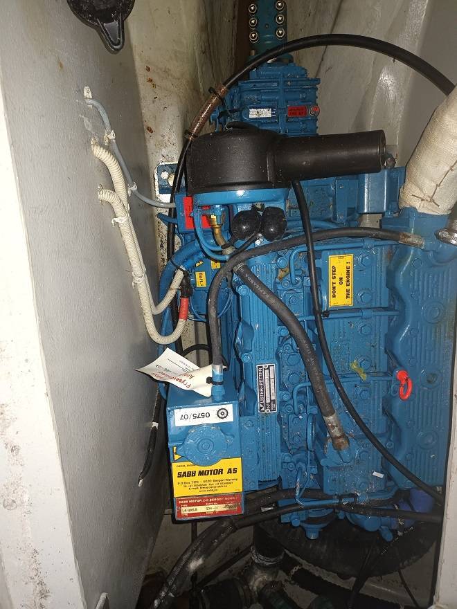

  7. Good morning Tony Here are the two photos I have. I can take more this afternoon when I return to the boat. Thanks On a separate thread, Peugeot 106 said: It’s Lister Petter LPW 4 cylinder 40 bhp build 48 (marine build) built in 2007 also known as Canal Star or Alpha. All spares Manuals etc available from Richard at MES Midlands or Sleeman Hawker Dorset and others. Manuals and Parts List also available online FOC On a separate thread, Peugeot 106 said: ''It’s Lister Petter LPW 4 cylinder 40 bhp build 48 (marine build) built in 2007 also known as Canal Star or Alpha. All spares Manuals etc available from Richard at MES Midlands or Sleeman Hawker Dorset and others. Manuals and Parts List also available online FOC''

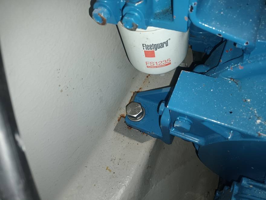

  8. Hi I need to fit a new tank, and by watching a few videos and talking to fellow boaters, I know that some important precautions need to be taken to avoid a massive air lock in the engine. I will use the existing "fuel to engine" and "return to tank" hoses, and am under the impression that a good way to avoid the air lock issue would be to: 1. Isolate the fuel filter. 2. Fit the hoses to the new tank. 3. Undo a bit the bolt on the fuel filter that releases the air. 4. Turn the ingition (without starting the engine) to "suck the fuel" out of the new tank into the hoses (and filter). 5. Repeat the process until no air comes out. 6. Start the engine. I learnt about steps 3. to 6. from the video below, which has a different type of filter, and it's a tutorial on how to release the air out after running out of fuel. That is not my case, so hopefully I won't need to continue the process on the injectors, only at the fuel pump. Please let me know what you think about this. The relevant part starts at around the end of the first minute. The attached photos are of the existing fuel filter in my engine. The engine is a Lister Petter PW4A48, but I'm not sure that's relevant for this matter. Many thanks! Many thanks!
