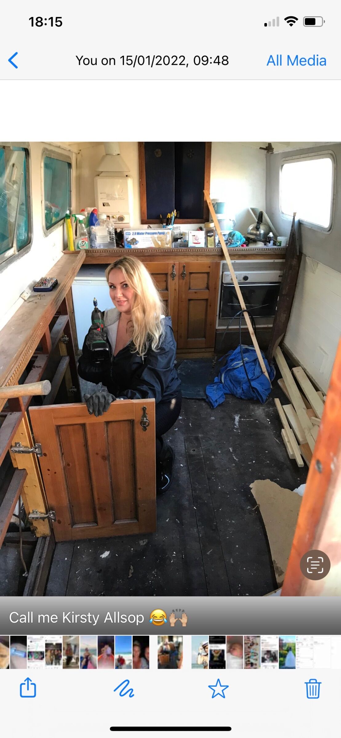

Shelley1981 Posted June 26 Report Share Posted June 26 Hi everyone! Just started renovating my 1970 Dobson. Anyone know about boilers? Wondering if it can be moved to other areas of the boat from the kitchen so I can make my hatch a big bigger. Any advice appreciated Link to comment Share on other sites More sharing options...

Tony Brooks Posted June 27 Report Share Posted June 27 Yes, it can, but whether it is practical or not is the question. You need to find enough free wall space, run gas pipe that is compliant with the BSS, and alter the hot and cold water supply, as well as cutting a new hole in the roof and sealing the existing one, that means locating and avoiding the strengthening ribs that are probably in the roof. If this is a boat you are permanently living on, you might need to employ a Gas Safe registered engineer endorsed LPG & marine, and that opens up a whole new more stringent set of regulations that apply to homes, rather than just the Boat Safety Scheme. If it is a holiday boat you will only need a person who is "competent" and if you are competent and in the case of an accident can prove it, you can do it yourself. You can do almost anything to a boat as long a sit complies with the regulations, and you have enough money. That could even include having a window take out and the aperture filled in to give a mounting area. but will it be worth the cost and upheaval. . Link to comment Share on other sites More sharing options...
Shelley1981 Posted June 27 Author Report Share Posted June 27 Thanks Tony, I’m not going to be living on the boat and have about 6k to do it all up. Probably getting carried away with myself. I thought the boiler was a bit of an eyesore here but was told it had to stay put. Probably my best bet LadyG, there is a lot to do to get it up to scratch Link to comment Share on other sites More sharing options...
Tracy D'arth Posted June 27 Report Share Posted June 27 Strange door with the handle inside if those spring hinges are not on the outside! Link to comment Share on other sites More sharing options...
Shelley1981 Posted June 27 Author Report Share Posted June 27 It’s 1970 not yet renovated so was probably ok then! 1 Link to comment Share on other sites More sharing options...
Stroudwater1 Posted June 27 Report Share Posted June 27 Welcome to the forum. I wouldn’t necessarily be in a rush to change things which are often where they are for a reason. It’s tempting to stamp our mark on a boat then wish we hadn’t! Those heaters are really good. Don’t be tempted to change it. The convenience of instant hot water is not to be underestimated. 1 Link to comment Share on other sites More sharing options...
David Mack Posted June 27 Report Share Posted June 27 40 minutes ago, Tracy D'arth said: Strange door with the handle inside if those spring hinges are not on the outside! I don't think the hinges are actually attached to the door in that photo. Link to comment Share on other sites More sharing options...
Tracy D'arth Posted June 27 Report Share Posted June 27 5 minutes ago, David Mack said: I don't think the hinges are actually attached to the door in that photo. You mean that it is a staged photo? On the forum? Shocking! 😲 Link to comment Share on other sites More sharing options...

Tony Brooks Posted June 27 Report Share Posted June 27 2 hours ago, Shelley1981 said: Thanks Tony, I’m not going to be living on the boat and have about 6k to do it all up. Probably getting carried away with myself. I thought the boiler was a bit of an eyesore here but was told it had to stay put. Probably my best bet LadyG, there is a lot to do to get it up to scratch There are alternatives but none are as convenient as that instant gas water heater and if it is an air cooled engine, one alternative is a non-starter. Even if it is water cooled, you would need to run the engine every day to get hot water. The other alternatives need far more electricity than what you already have, and unless you are permanently connected to a shore line it tends to be in short supply on a boat. Even in winter, solar struggles for live-aboard use. I sincerely hope that you at least had your own hull survey, because there is no point in spending £6K on doing the interior up to find it sinks in a year or two. If you have not had a hull survey, I would suggest that should be a priority. I fear rectifying a bad hull could cost twice the budget you seem to have. To be honest, that layout looks to be a bit of a death trap in case of fire or flooding. I think my priority would be to get proper access steps so you can get out of that end of the boat in the dark or with it full of smoke. I fear that would require a total refit of the galley. Link to comment Share on other sites More sharing options...
