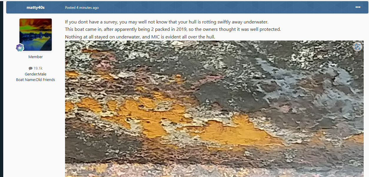

However, we have just seen another one this week. Vast rashes of orange all over the hull except for the rear end under the counter.
The surveyor said it was galvanic corrosion, when asked about microbial, he stated that No, it only happens up North as far as he was aware...

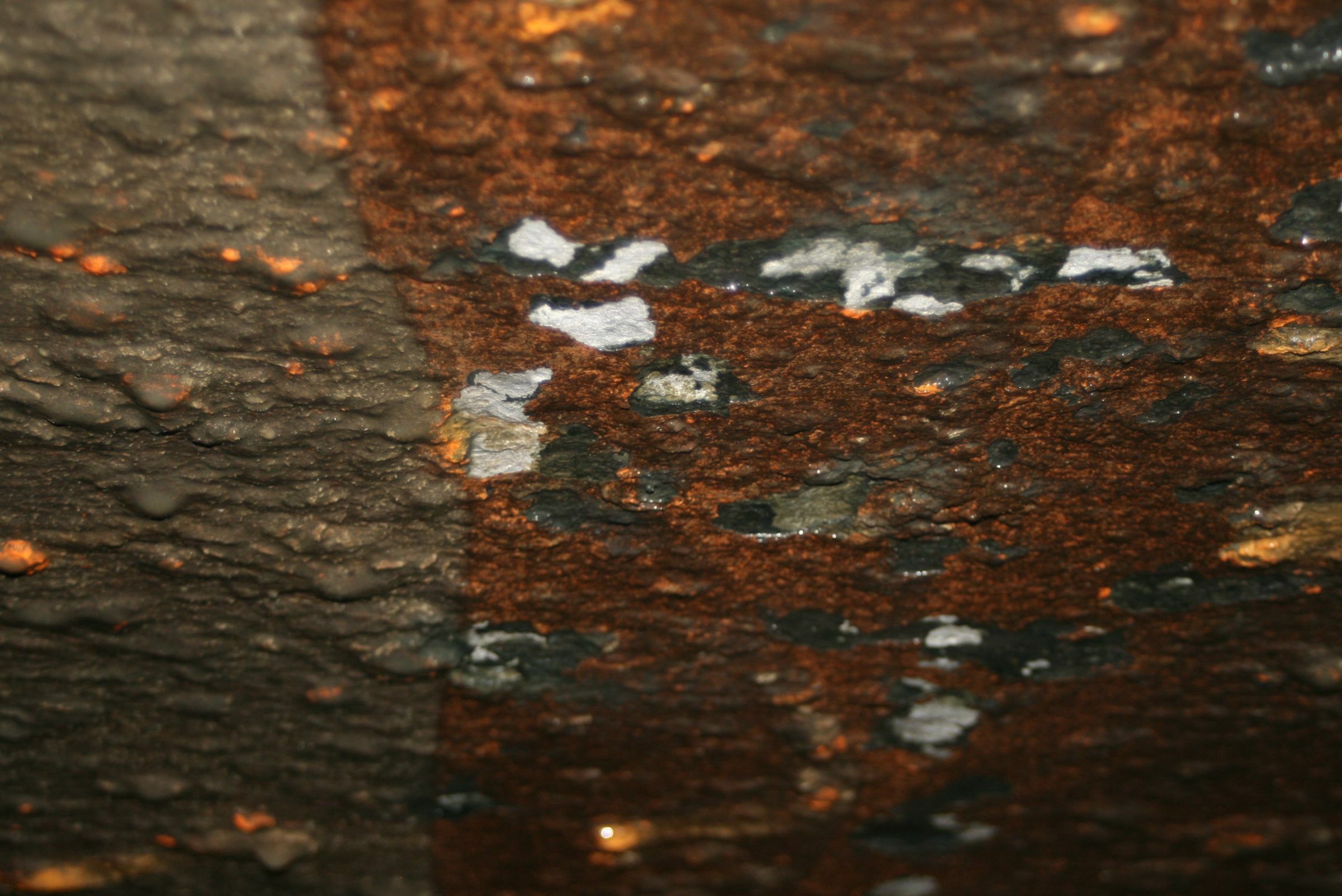

2 hours ago, Bod said:
Is this MC?
To the left unwashed, to the right the silver pits under the orange head.
Bod

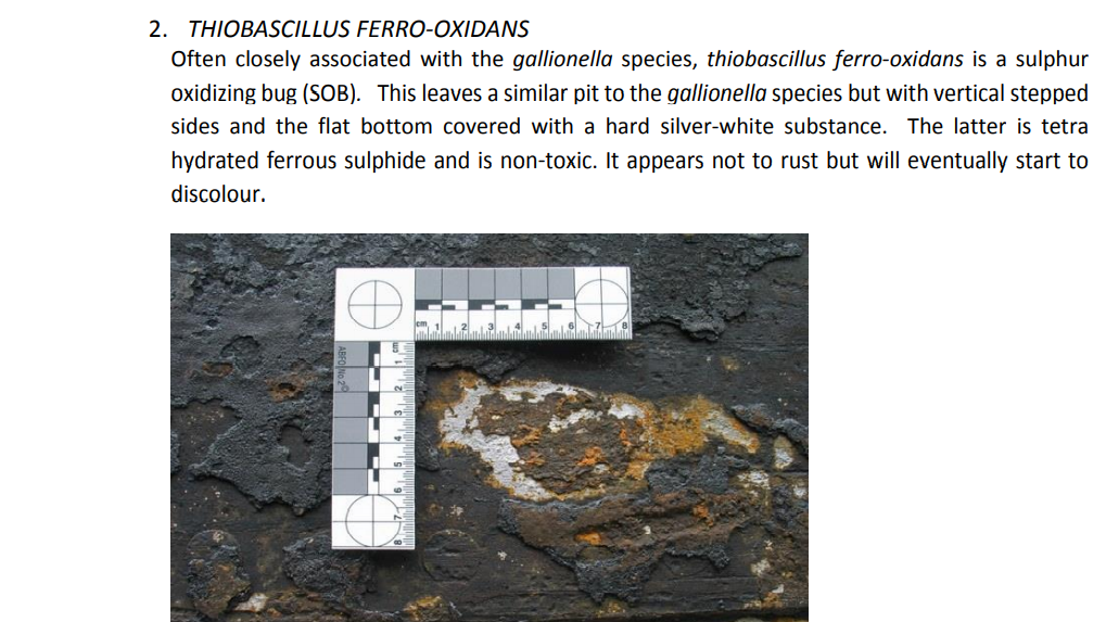

It certainly 'meets the description' and similar pictures have proven to be MIC.
If it quacks like a duck & .....................
There are two variants of MIC, your looks like ..................................
