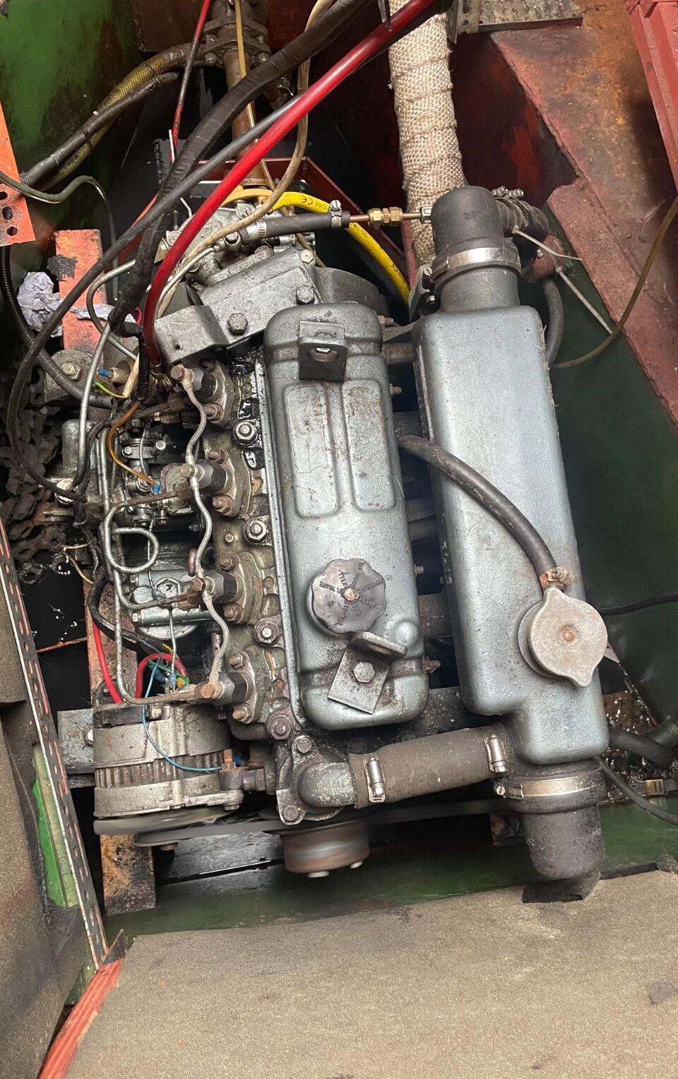

Some context for the situation.
I had the engine serviced about three weeks ago at a marina before leaving.  There they mentioned a leak but could not proceed with the service until this problem had been resolved. It was no longer a regular engine service at this point.
The Marina tried to refurbish the injectors but they were eventually replaced all four of them.
During the service the some of black liquid was vacuumed out from the bottom of the engine bay. It has since replenished indicating a leak somewhere.
About two days ago I noticed lots of fumes from the engine bay after running the engine to top up the batteries daily without issue. I turned the engine off at this point and went to bed. I should mention I hadn’t added or done anything to the engine at this point.
The next day I ran the engine for about an hour and noticed the smoke. I phoned the marina and I was told it was possible unburnt diesel and I should try to find the leak. Today I ran the engine and tried to identify where this leak may be coming from. Didn’t really get anywhere and about an hour in I noticed the smoke again and the engine bay was very hot. There is black liquid accumulating in the engine bay and I do not know where it could be from.
I’ll attach a picture of the engine and from where I saw the smoke emanating. In the picture the area between the two rectangle bits with screw top. Where that black wire is going, that is where the smoke was coming from. Or steam. Today it felt more like paraffin steam more
than smoke.
Edited by wandering
15 minutes ago, David Mack said:
Looks to me as if the water pump drive belt is missing, so the engine will be overheating.
Perhaps I'm being dense, but I'm not seeing a missing belt.
Steam is invisible so it can't be that. It might be hot water vapour or hot oil fumes. There looks like an oil leak towards the rear of the valve rocker cover that's dribbled onto the cylinder head which will cause hot oily fumes vapour, probably needs new gasket, a fairly common trait with these engines especially if it has the old cork gasket
Edited by bizzard
I thought the alternator belt passed beneath the water pump pulley, but looking at an enlarged view of the photo there may be a single belt for both.
No, I can see the belt, but the "nose" on the water pump pulley has been rubbed so it looks like a belt may be missing.  I think the photo suggests that the belt might be loose and also that the water pump and alternator pulley might not be in line, if so that would wear and loosen the belt.
For Wandering.
That looks like a dry exhaust tank cooled engine, so you check or top up the coolant level by removing the old car style radiator cap. Note my filling advice above.
I don't think it has been overheating because there are no rusty water stains around the filler.
I also can not see any signs of a diesel leak.
I don't like the sound of that because the only "black liquid" would be an engine oil leak so check the oil level and make sure it is between the two marks on the dipstick. It could be water or coolant with old oil floating on the surface, I hope it is. If it is a diesel leak it would dilute any old oil in the drip tray so it feels far thinner and runnier that the oil in the engine. Try smelling and rubbing between your fingers some engine oil and then the black liquid. That may indicate what it is.
I think that you need to ensure the coolant and oil levels are correct and then run for an hour or so with the engine exposed while you look for the source of this "smoke" or steam, then when you have found it come back to us.
If the rocker cover was taken off then there is every possibility that it's gasket has not been fitted correctly on the side nearest the coolant filler. If this is the case oil will leak and could easily drop onto the very hot exhaust "stubs" on the manifold. If so that would really smoke once everything is hot.
We need to know where this "smoke" is coming from.
Just a single belt for the alternator and water pump. On heat exchanger or direct raw water cooled engines there is another belt but way lower down and extending to the opposite side of the engine.
1 minute ago, bizzard said:
Looks like the busted off top of a colant temp gauge sender just above the front of the alternator.
Yes, but no signs of a leak, so we can assume that the OP does not have a working temperature gauge. He will need an infrared thermometer on the thermostat housing etc. to get the temperature.
I agree about the potential oil leak but not that the cylinder head itself would make much smoke (unlike the exhaust stubs) but it does suggest the gasket has been incorrectly fitted. If the OP feels he is capable I think it is new gasket time, but this time stick it to the rocker cover with silicon, so it stays in place while being fitted.
As the engine is probably canted a little downwards at it's stern end I bet oil has dribbled down the back of the engine too. Looks messy under that fuel filter mount.
