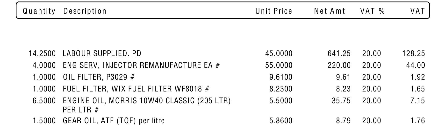

This was a service which was 14 hours of labour over a month because of injectors needing replaced, apparently. Paid 1100 pounds.
14 hours of labour for a service and new/recon injectors is really taking the pish. Even I'm not that expensive.

 A leak was identified when the man looked at it. I was told this should be found before the service was completed. I said fix the leak. I was then told I needed 4 new injectors. I was informed the leak stopped. When work was entering its final week I asked how long is left because it has taken weeks. Then he cleaned up and I was told it was done.
And the leak has not stopped. I was told a service cost 250 but the leak then lead to the further cost. Let me grab the invoice.

The invoice says Morris 10W40 Classic oil, which as Alan noted is not what is in your photo. It should look like this.

Don't feel too bad, unfortunately it seems to happen far too frequently. How anyone can claim 14 hours for a service and injector change is beyond me, unless there was more work than listed. Even if they had their own pump room and overhauled the injectors themselves it still seems way, way too much time - especially as they seem to have caused an oil leak or failed to find it and fix it.
