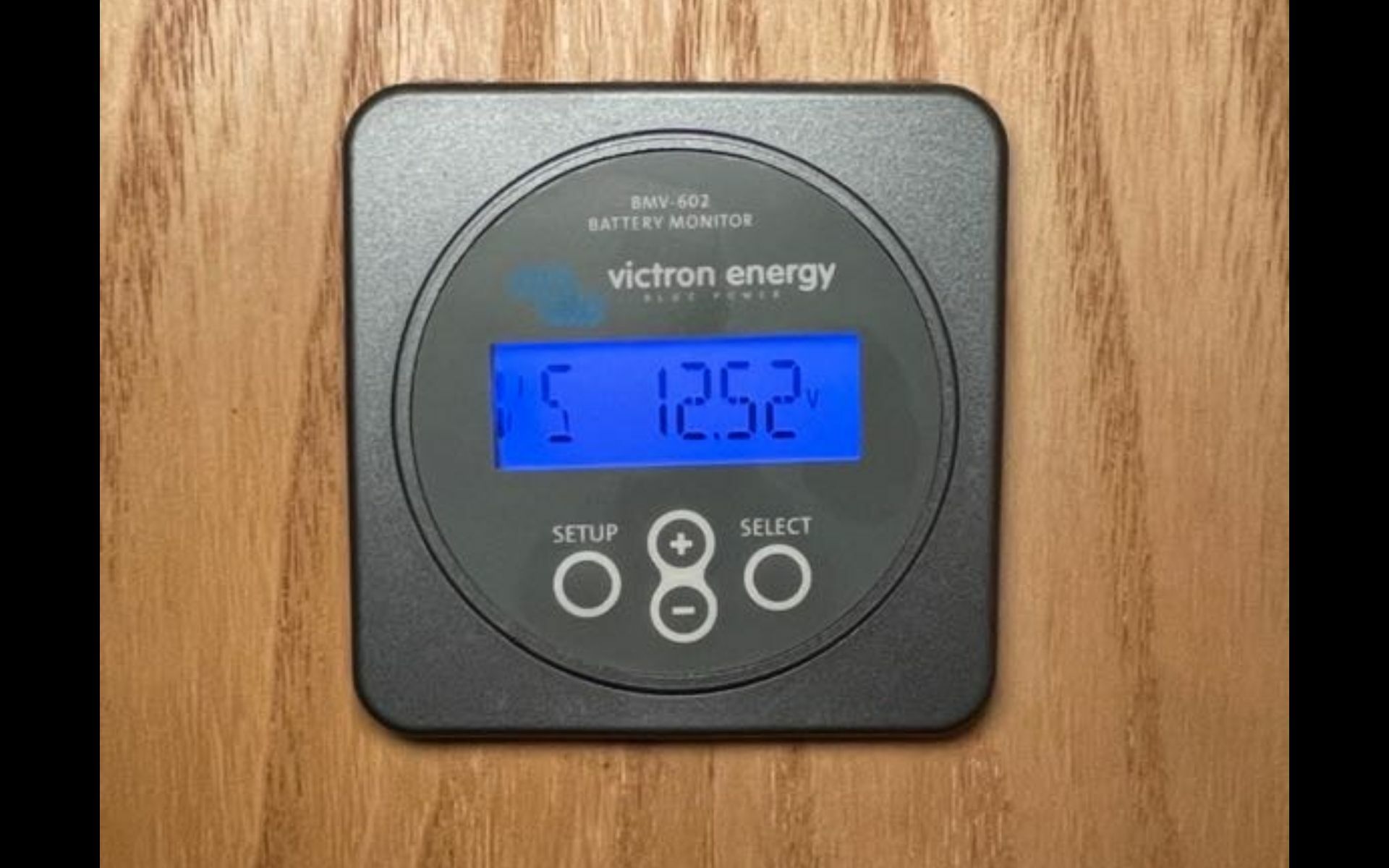

There is a panel in my room with Victron branding. Usually told me the state of charge. At the marina it was consistently 100%. As of three days ago, when I moved, the power would go back up.

What is this? These amp-hour counters can tell lies when they report state of charge. They are good voltmeters and good ammeters, but state of charge can get out of sync with the reality of the batteries really quickly. I ran in to this problem when I first had this boat.

The percentage meters often tell big lies and should not be relied upon, at 19 years old the batteries are probably worn out, while in the marina your electricity was coming from the shore supply , not your batteries. A 12 volt fridge in its a compressor fridge is one of the first things to complain it the batteries are bad.
I believe I accidentally reset it to 100 so I know that view in the panel is inaccurate. I wish I knew how to show images and videos of what I’m taking about here but fie size too big. The rate at which the number depletes, should that too be considered inaccurate? Ok it’s not 100%, that we can agree on, but now it’s going down to 99.6%. Is the change false too then, do you think?
