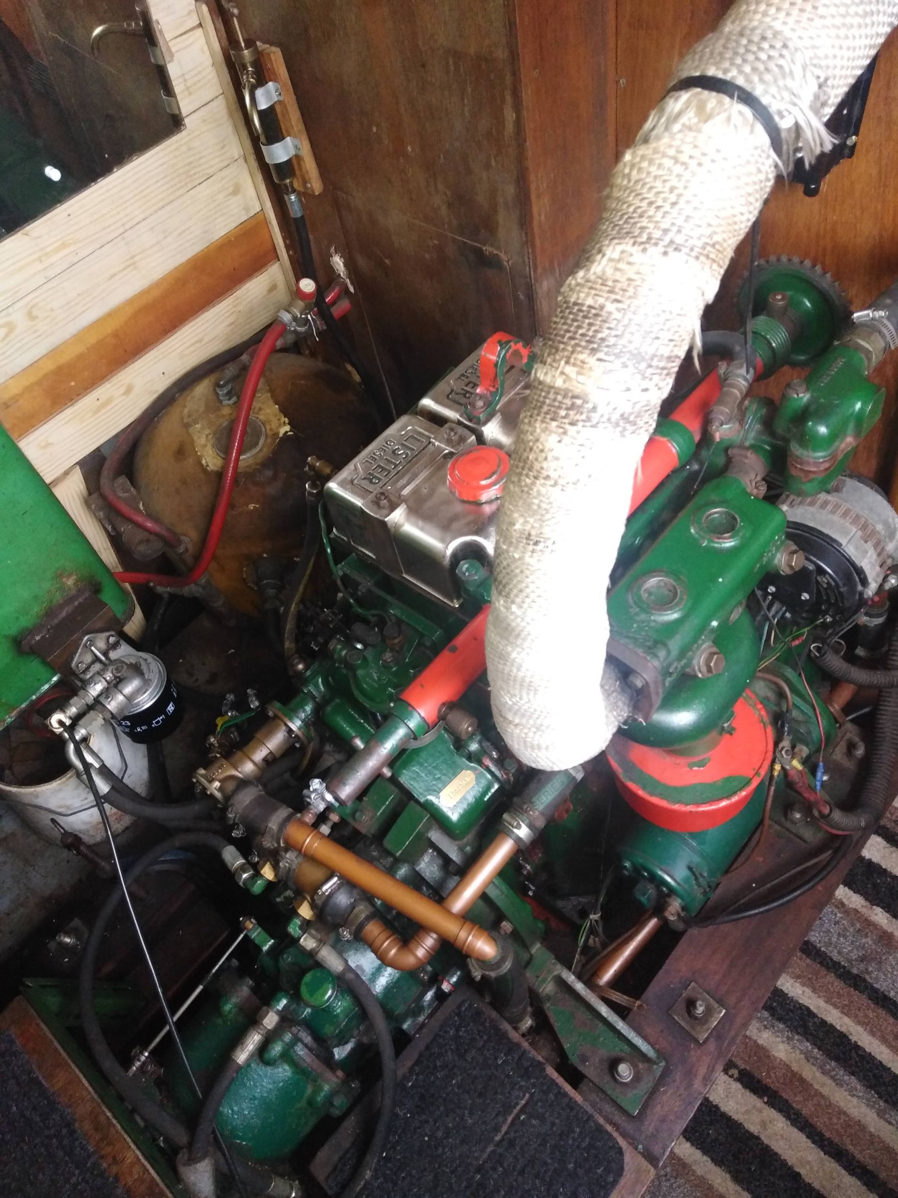

I came across what I think is the culprit,

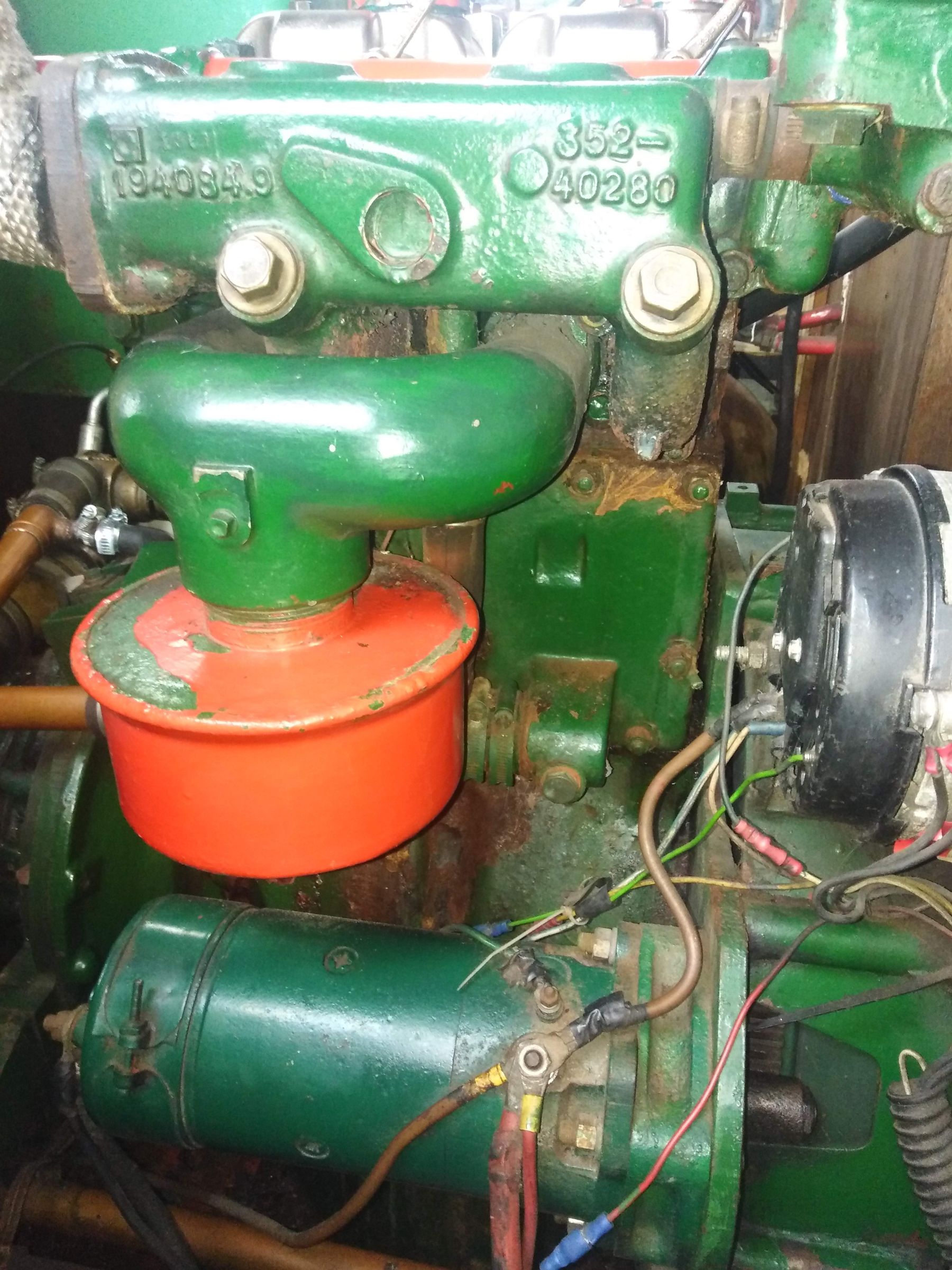

Behind the air filter is an exhaust manifold pipe water cooling pipe ( if that's what its called).
The state of the block here shows a leak that has been going on for years and years.

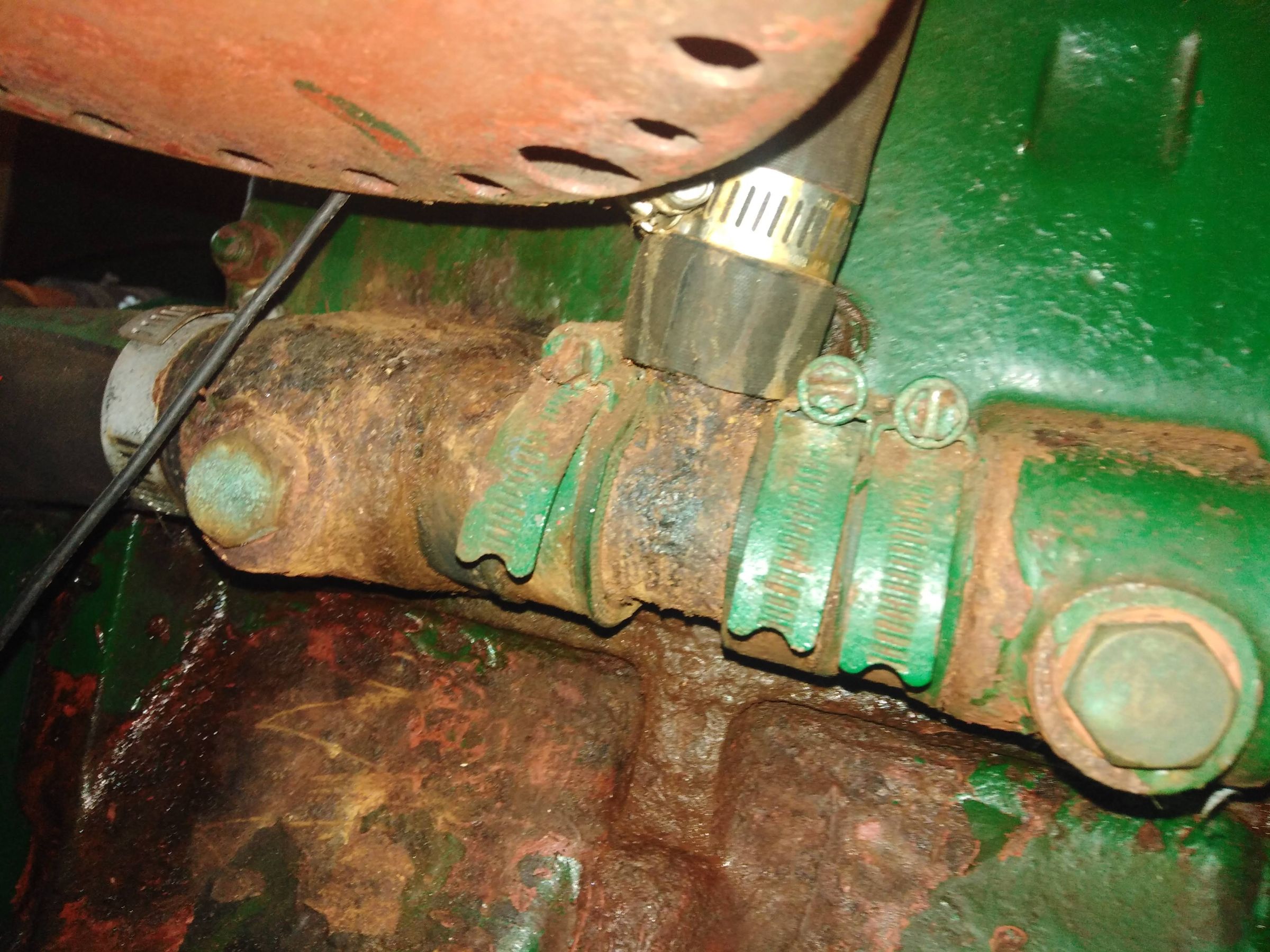

There is a hose which connects between  the two engine block water passages, with another hose going upright into the water cooled exhaust  manifold.
The jubilee clips look original and are clearly very rusted/worn ,
The leak is to the left hand pipe before re-entering the block circulation,
It looks like on closer inspection that the leak is not at the remaining left hand jubilee clip but, the steel pipe entering the block,
After scratching the rusty area and scraping bits of paint away this pipe looks like it's an inner and outer pipe that are joined together with a hylomar type  sealant which has now failed after 40+ years.
Finally my question for advice is this,
Is this a serviceable/ replacement steel/ cast iron pipe, if what is it called, where could I get on from.?
Or in the short term, could I use / bodge it with a Milliput cement or other product that works on hot pipes/ boilers/ water pipes.

The bit you show looks like a casting, but how it is attached to the cylinder block I don't know. Guessing at what it is for, I can't see why it should have another pipe inside it. I have no idea how it is attached to the block or if it is part of the block casting, so can't be much help.
On the third picture there is rust on the pipe which looks to drop down from the bottom of the water cooled exhaust manifold. That could be a sign of water running down to the lower pipes which are much rustier. In the second picture is that very rusty piece actually part of the block? It doesn't look to be quite straight and if it was part of the block you wouldn't be able to assemble the T piece and hoses to the right of it.
There also appears to be a hose clip missing on the left hand leg of that T piece.

Yes, it a T piece with a 2 " hose either side then entering the very rusty block, that's why I say it must have been like it for many years,
Just slightly out of site, unless you get on your hands and knees with a torch.

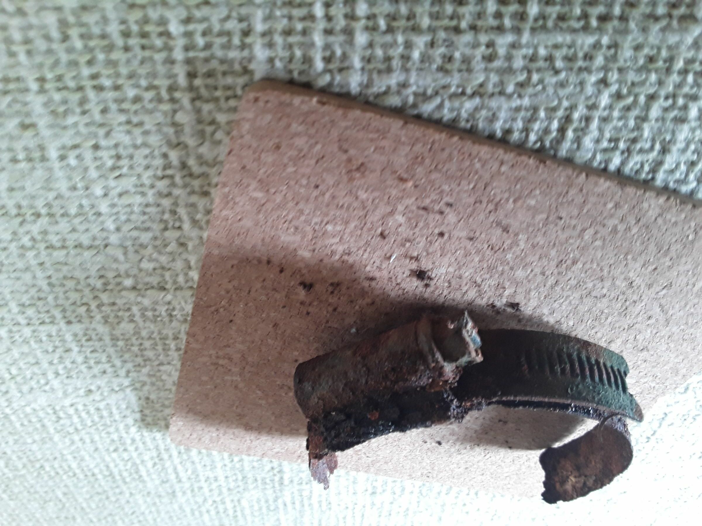

Here is the missing jubilee clip, fell off in my hand (40+ years service)
Probably answering my own question here,
The leak is not where the jubilee clip is missing,
It is more to the left by about an inch, this is where the holymar type sealant is and where was wet to the touch earlier.
Could it be that this small 'collet' type pipe actually screws into the block and the sealant has been put on the threads of it.
After 40 years this wont want to come out without dangerous persuasion to the block.
"Me thinks" boiler cement may be a good, albeit temporary repair. And a replacement clip just in case without disturbing it to much to see how it goes.
Thats all going to have to come apart for a good inspection, scrape and paint. There is just a small chance thats its part a casting that has failed and this could be time consuming to fix. I assume you have an electricity supply and are not dependant on the engine?.
Looking at the large hexagon heads on both T pieces, I wonder if they allow a socket to reach inside to tighten or remove a single fixing bolt for the T piece. If so, there really should be a dowel as well, maybe two, to ensure the T piece casting and presumably a gasket stayed aligned with the block. It is just speculation, so it is probably better to await a Lister expert to give chapter and verse.

The black hose going off vertically shows definite signs of water having run down the outside of it.
Are you sure that the leak is not above this hose?  This would have caused the rusting that you can see lower down.
I don't think that you have positively identified where the leak is from.
The 2 cast tee pieces are bolted to the block with gaskets in between. If you cannot find a leak further up, this whole tees and hoses assembly comes off complete.

The newer black vertical hose and clip are also a source of leak, but they were dry to the touch yesterday morning,
The only wet area was a dark brown crescent shape area to the left of the single green jubilee clip, if you zoom in slightly on picture 2 you can just make it out and see a rubber type sealant which showed a leak.
I will investigate all of the connections later and run the engine for half an hour to get the water flowing,
Interesting that the whole section is held on with those bolts and gaskets, obviously with it being painted previously you cannot determine any join.

Thanks Richard, now you say doors I can see them
Karen: If you can't shift the air filter by hand, I would try a strap type oil filter wrench or maybe a leather belt and a block of wood. Otherwise, a length of wood with two screws right through it that fit in a pair of holes opposite each other.
3 minutes ago, Tracy D'arth said:
Looking again I am not sure that the cast bits come off the block but if they don't how did they get the hoses and clips on?
Richard says the cast bits are part of side doors, presumably to facilitate cleaning the cooling galleries, so the whole side comes off.
That makes more sense, so its one larger gasket to make.  Still doesn't explain how the hoses are fitted though, is it like a BMC A series bypass hose job, squash up to fit?  Or take both off?
Some of that wiring for the alternator looks a bit precarious.
It looks like two doors to me, so assemble the hose onto the doors, leaving it loose, then fit the doors. A bit like Lister heads and exhaust manifolds.
There is a door on each barrel giving access to the water space. Fitting the hoses is a pain, the longer on squashes and goes on. The shorter ones on the tee piece require careful juggling. You can't assemble them to the doors, then fit the assembly as there is a nut and stud behind the pipe (!!!). Before you ask, the 'S' shaped hose on the flywheel end is obsolete and unobtainable
Don't bother trying to unscrew the 'filter', it will be very firmly stuck. It is easier to take the inlet manifold off. It isn't a filter, it's a noise suppressor - actually it' a pepperpot exhaust serving as an air intake
