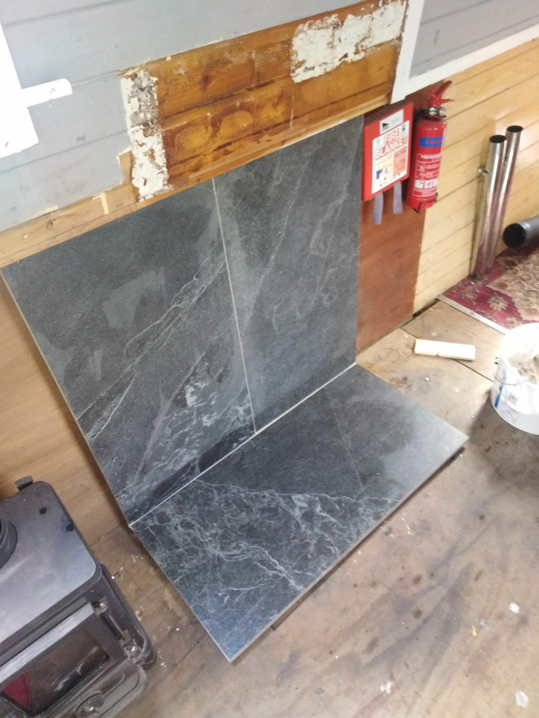

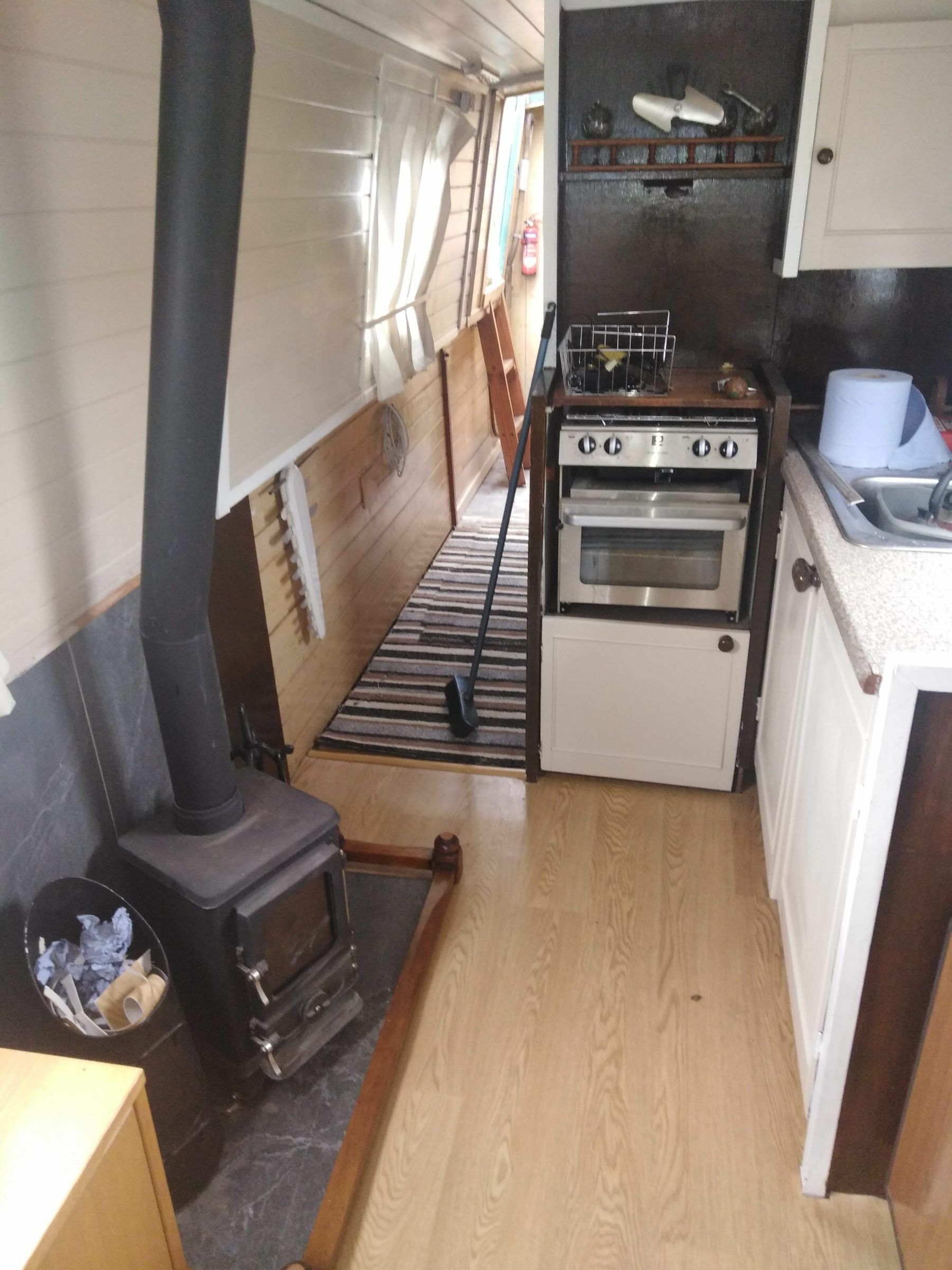

  7. I used wickes ceramic tiles 600mm x 300mm x 30mm each, fixed onto thick plywood underneath and behind, then you need a ceramic drill bit to screw the stoves feet down, through the ceramic and into the plywood. Quite pleased with the result, if I say so myself.
