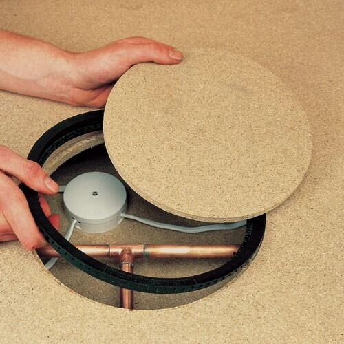

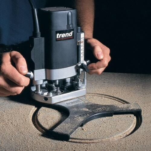

If you have room and a router I'd use a Trend routerbout. Someone will post a link I'm sure. I'm not that clever 😁

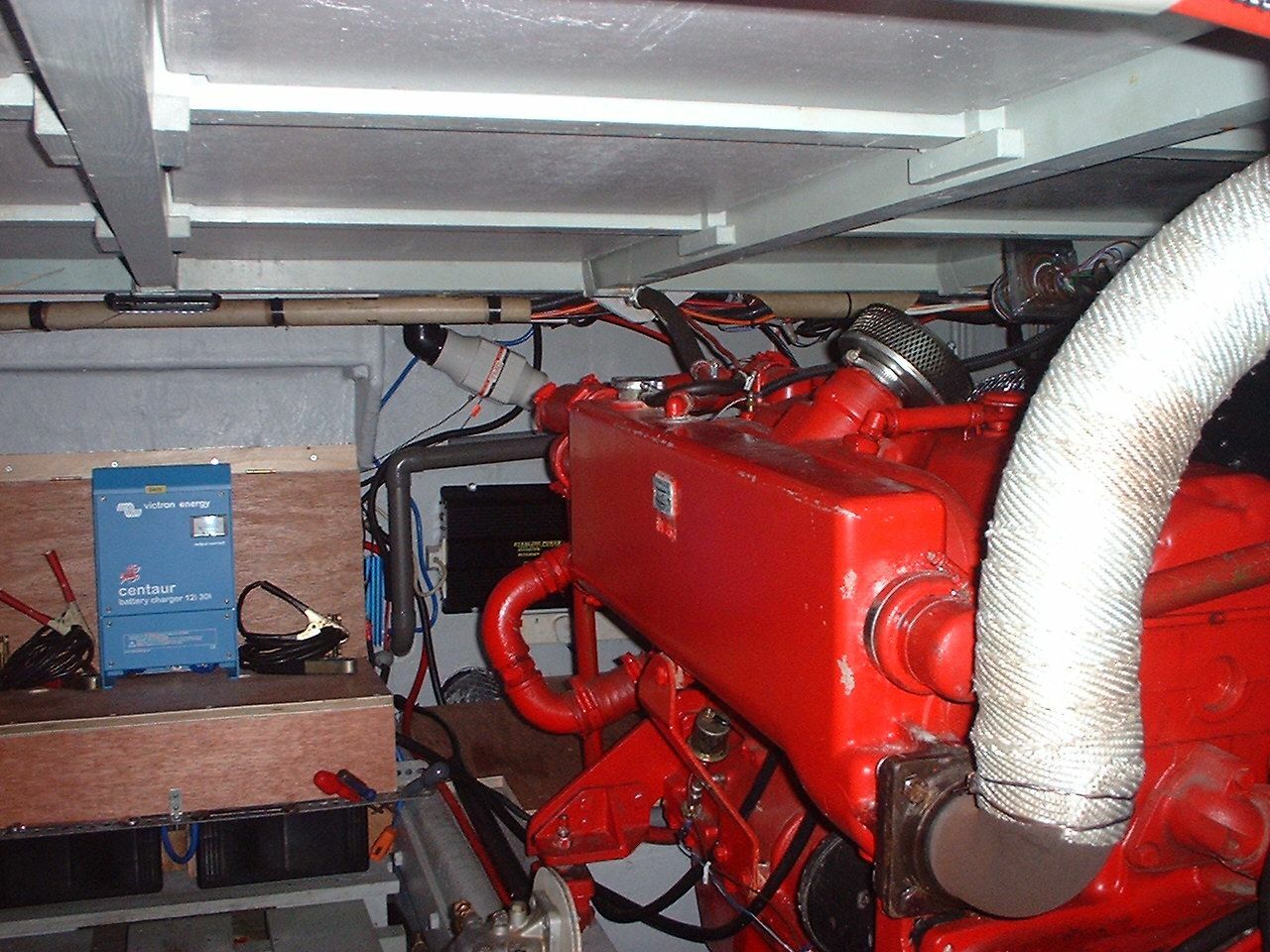

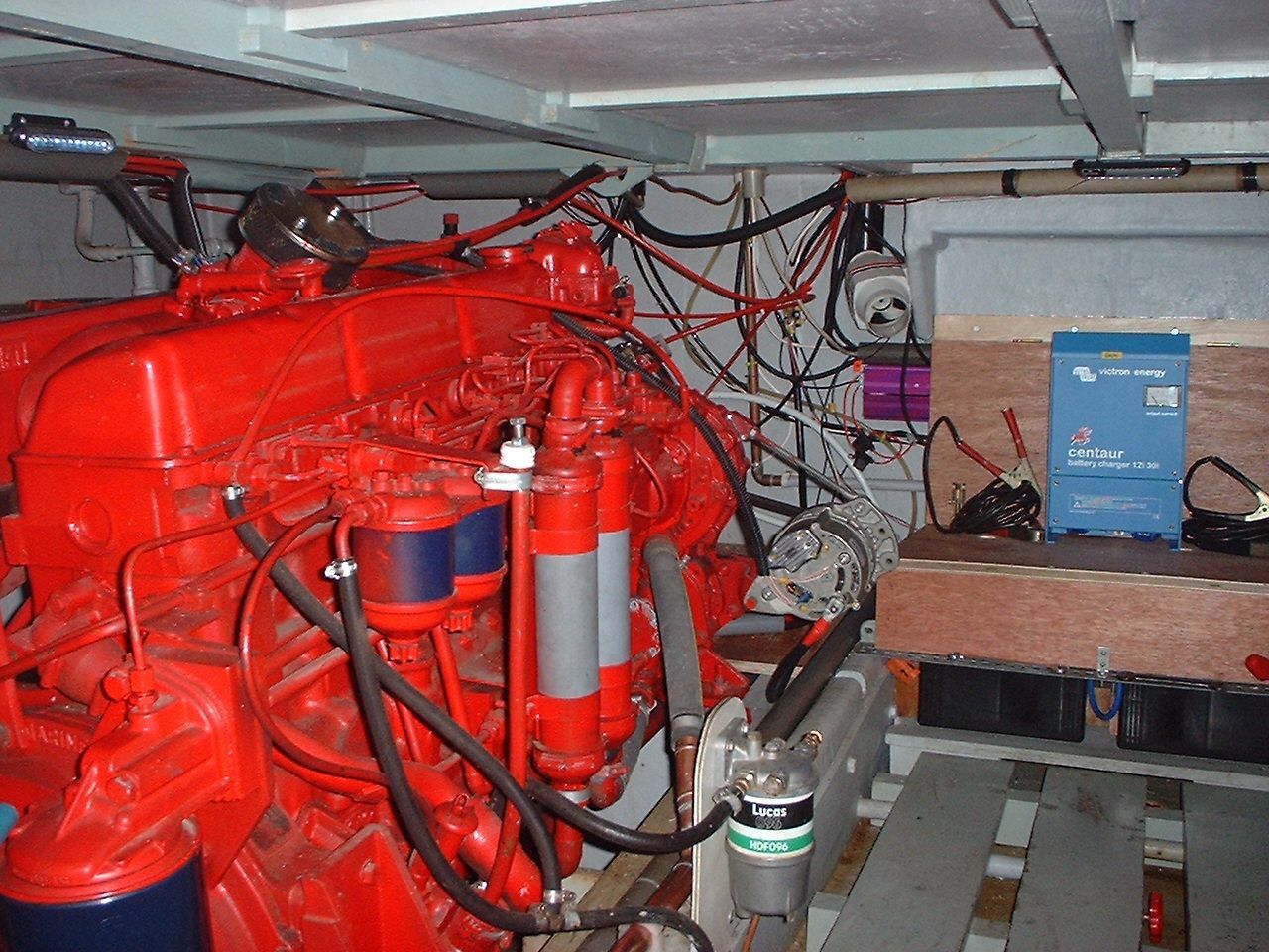

1 hour ago, Tony Brooks said:
................so whole floor areas can be lifted like many GRP Cruisers........................
Whilst we have access to the engines via 'under the stairs down to the rear cabin, much easier access is avilable by lifting the floor panels.
View from below :
The floor panels sit on joists which in turn sit into joist hangers, a section, or the whole floor, can be lifted to give easy access to both engines.

1 minute ago, Puffling said:
It's still quite pricey, but if you already have the router a useful addition to the tricks it can do, I'm sure.
Cheap one on eBay sometimes. Got one to do 22 mm for sale on gumtree brand new unused for £25
