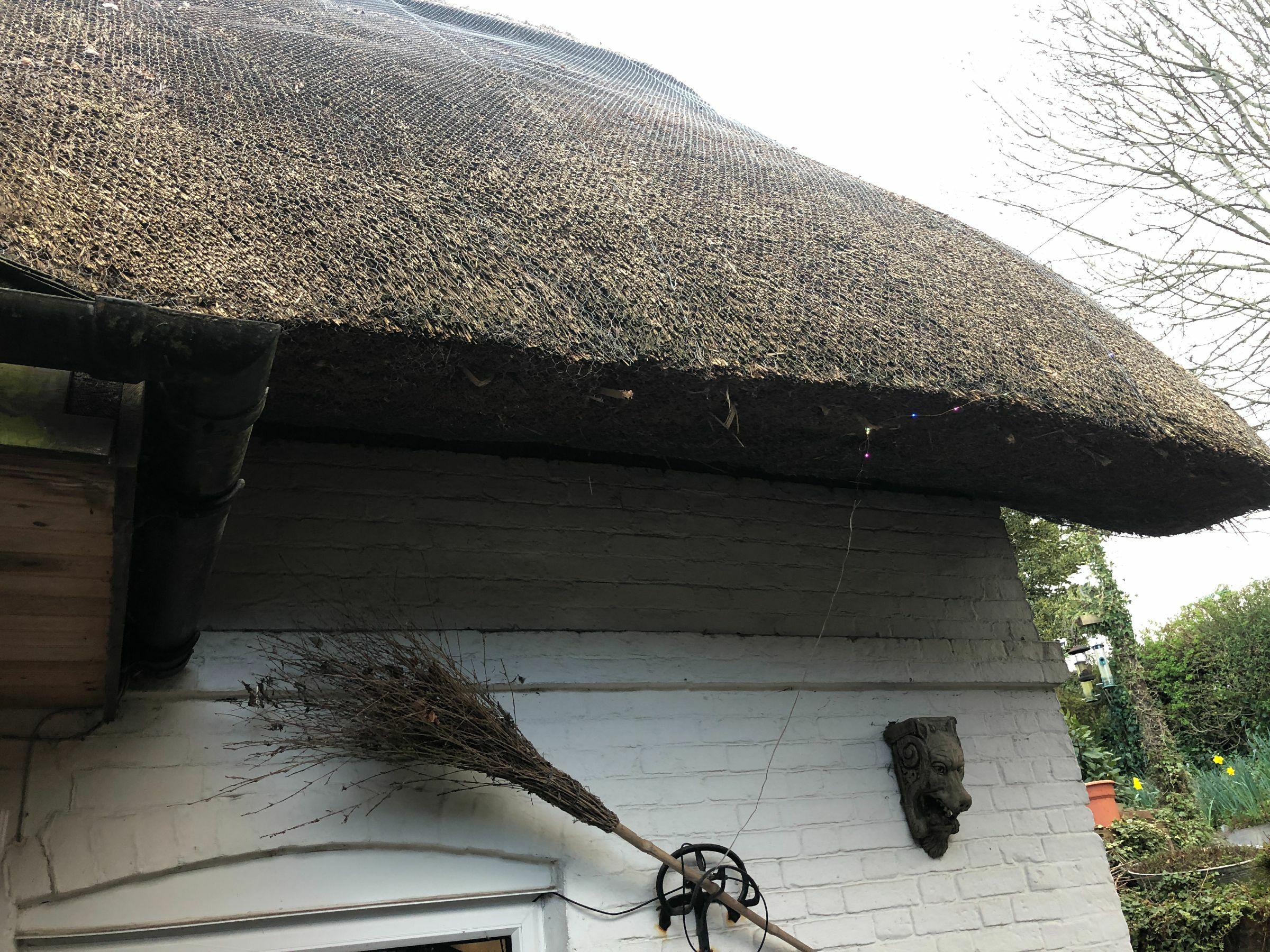

Tell me about the brickwork behind, please.
Is it brick or what?
You’ve  said you live in an old house.
Dunno much about them, other than I've bin wondering about getting the paint power-wossnamed off.
House looks quite old to me!
Lovely.
Fair enough, the other photos made it look like odd brick work.
I think it’s great how they can put a hair net over thatch.
You got a witch in there too?
