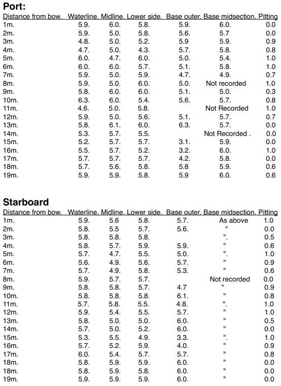

Now the questions. The boat is 6/6/6 iron with a steel stern. I have read that iron can be a bit trickier to weld. I have also read speculation that steel could act as an anode here, and corrode quicker. But I've also read of people have steel base plates on iron boats. Is it much of a concern?
The boat also requires a shoe plate welding on as the chine has worn away. No problem, the yard selling it can likely do it and have given an estimated cost for this work. However, the survey looks to me (see below) to show areas of serious thining? 3.1mm is (fully comp) uninsurable is it not? This was an insurance survey so I would have thought they would mention this? What it said was:
"The table reveals there has been some minor diminution of plate thickness. Some pits were noted where areas of blacking was cleaned off. The bottom plate does not appear to have been blacked in the recent past. No evidence of any blacking was found. Some shallow pit corrosion was noted. Pit depths were measured the deepest being 1.0mm, but the majority were in the range 0.3mm to 0.9mm. There is some thinning of the base around the area of the swims"
And
"Advise. Weld a 100mm wide shoe plate around the base at swim position, this will repair the thin areas and provide a new chine."
Obviously I would get my own survey if I went ahead, but am I reading this wrong? Seems more than minor diminution of thickness to me? Basically, with the cost of renovating the interior, I don't want to buy a boat that is very quickly going to need (more) hull work (although I understand it may well in the future - keeping something historic afloat seems more worthwhile, and thus less painful, than something not though) The survey states "Conclusions. Inspection of the hull indicates it was in good condition. When any minor defects are rectified and other more minor deficiencies are dealt with it represents a well-appointed narrowboat with many years of life ahead of her" But those of you that have read my "tale of two surveys" thread will know I'm not going to put a huge amount of faith into this.

Those thickness readings show that there is the basis of a sound boat there, but there are some problems. But a coarse grid of readings won't necessarily pick up the worst areas. What you really need is an experienced surveyor to go round it with a hammer and knock six bells out of it. That will find the thin areas, the places where the plate is laminated and full of inclusions, and might well put a hole or two right through. Understandably vendors are not generally too keen on such an approach, so it's more useful after you have decided to do significant hull works, in order to determine the extent of those works.
Any iron boat will by now have areas of steel where it has been repaired or altered over the years. I wouldn't worry about that.

What I read here is that this surveyor may not be experienced enough with riveted iron/have not gone to town on, it so the work needed may in reality be much more extensive?

That's good to hear. I guess I feel a bit uneasy still about the previous report - what's up with those 3mm readings? Confused if that's related to the chine or why that hasn't been talked about. The last insurance survey I looked at was much more optimistic than an older survey done for the same boat.

9 minutes ago, DShK said:
But I still feel like I'm trying to understand those thickness readings!
Me too. 3mm seems unusually thick for a boat of that age. The surveyor probably missed all the spots where it is 0.1mm.
