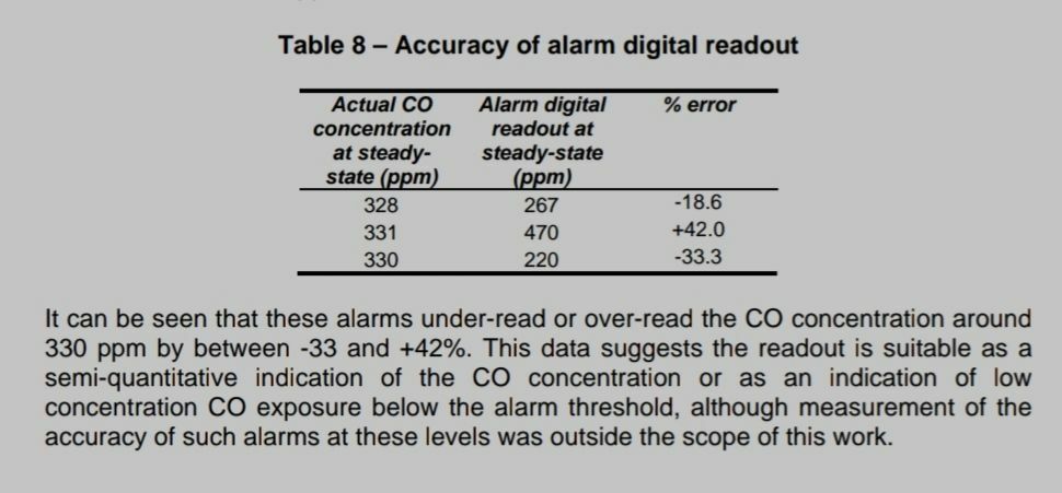

Rebotco Posted January 19, 2022 Author Report Posted January 19, 2022 1 hour ago, blackrose said: No I don't think so. As it's been stuck on 20ppm for some time the indicator is obviously faulty. That doesn't necessarily mean the detector/alarm itself is faulty - unless you think that all CO alarms without indicators are faulty? Would you trust your life on a guess that it might be faulty or not? I sure wouldn't. Just as well you're planning replacing it.
blackrose Posted January 20, 2022 Report Posted January 20, 2022 (edited) 40 minutes ago, Rebotco said: Would you trust your life on a guess that it might be faulty or not? I sure wouldn't. Just as well you're planning replacing it. The indicator was faulty, the detector was not. It was tested regularly. How do you test yours? Surely you don't rely on the cheap ppm indicator to tell you if it's working properly? I wouldn't! Look at these results from a HSE survey of household CO detectors. Although indicators aren't within the main scope of the survey, the inaccuracy of the indicators is quite clear and they shouldn't be relied on. How could an indicator for a detector with a threshold of only 30ppm possibly be useful if the indicator error might be between -18% to +42%? It's pretty obvious really. If you want accurate gas analysis equipment you'll need to pay a bit more than 15 quid! The gas analysers we use at work cost thousands and have to be calibrated regularly. Edited January 20, 2022 by blackrose
