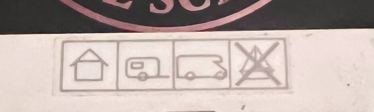

Goliath Posted January 14 Report Share Posted January 14 Just to add; according to my last BSS inspector in 2019, you can ignore this X across the boat, it’s the ‘2’ at the end of the long number that’s important. He did go to great lengths as to why he wasn’t bothered about that X across the boat. I can’t remember what he said my eyes glazed over as soon as he started up about it. But I think it was something along the lines of a narrow boat being more like the caravan and having a steady environment rather than a boat at sea. And some other reason about lack of information for testing on proper boats so therefore that’s why there be a big X over the boat. In all I just remember the important fact that it’s the 2 that matters. So although I had an X over the boat, my alarm is good because it has the 2 on the end of it’s number. 1 Link to comment Share on other sites More sharing options...

Opener Posted January 18 Report Share Posted January 18 On 13/01/2022 at 20:11, Alan de Enfield said: Remember that BS EN 50291-2 are approved for boats, but BS EN 50291-1 ARE NOT approved for boats. Much more here about what you need : Carbon Monoxide (CO) | Boat Safety Scheme | Go Boating - Stay Safe If you already have a Kitemarked alarm, tested to BS EN 50291, or 50291-1, the advice is to keep it, test it routinely and when it needs replacing, choose a unit tested to BS EN 50291-2. According to the box, the ones for sale in my local Lidl are dash-1s with pictograms on the box suggesting it is unsuitable for anything that moves ie yacht, caravan or mobilome. Hey-ho! Better luck next time (they've got a stove fan, though!!!) Link to comment Share on other sites More sharing options...
Alan de Enfield Posted January 18 Report Share Posted January 18 13 minutes ago, Opener said: Better luck next time. Not quite sure why you have quoted me - I doubted they would be part-2 which is why I suggesting that folks check the standard - it was not I that suggested buying them. Link to comment Share on other sites More sharing options...
Rebotco Posted January 18 Author Report Share Posted January 18 49 minutes ago, Opener said: According to the box, the ones for sale in my local Lidl are dash-1s with pictograms on the box suggesting it is unsuitable for anything that moves ie yacht, caravan or mobilome. Hey-ho! Better luck next time (they've got a stove fan, though!!!) A lot of boaters happen to also have homes! Link to comment Share on other sites More sharing options...
