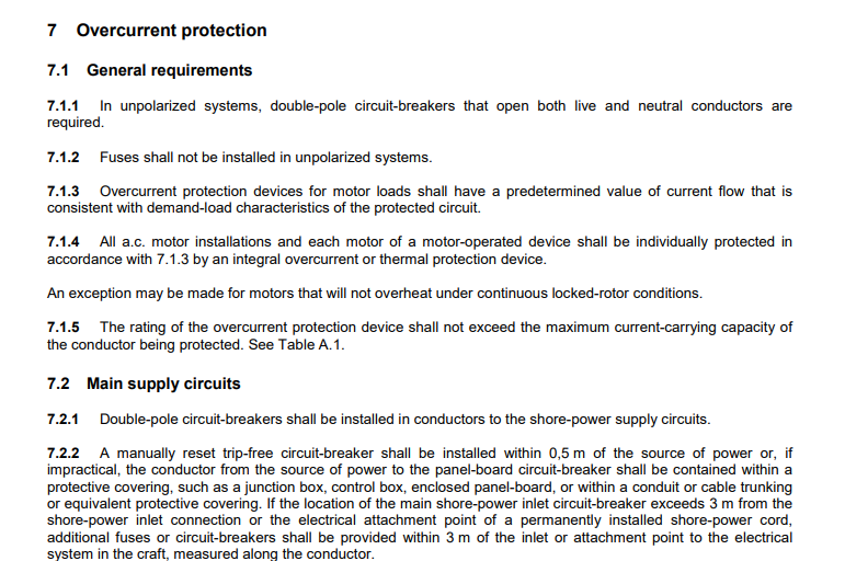

This is why the ISO for small boat ac systems requires double pole breakers etc. if you have such a supply (called an “unpolarised supply”).
Since you raised the subject - it is also a requirement in ISO 13297 (AC Electrical Systems for Small Craft) to have double-pole breakers in the shore line supply (7:2:1)
How many do ?

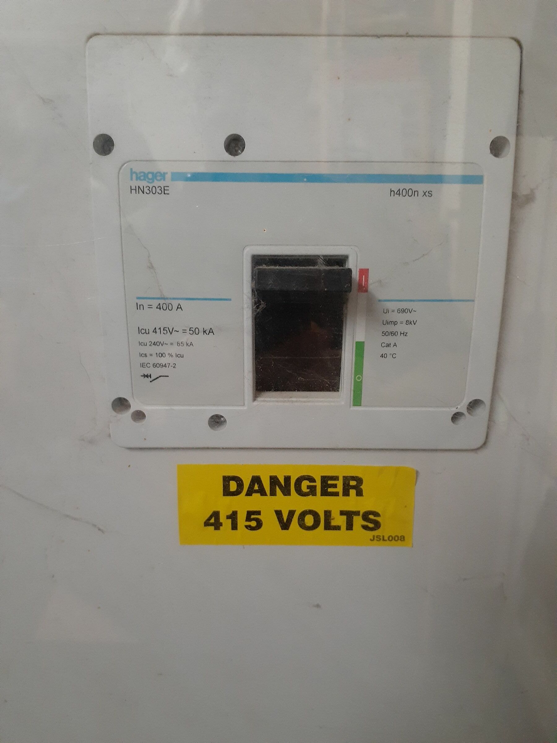

It may not be common, but our household input IS 3-phase. When we had it built we wanted to future proof it for any electrical demands.
Edited by Alan de Enfield

Agreed - can find nothing about 'spacing' in ISO 13297 (AC Electrical Systems for Small Craft)
