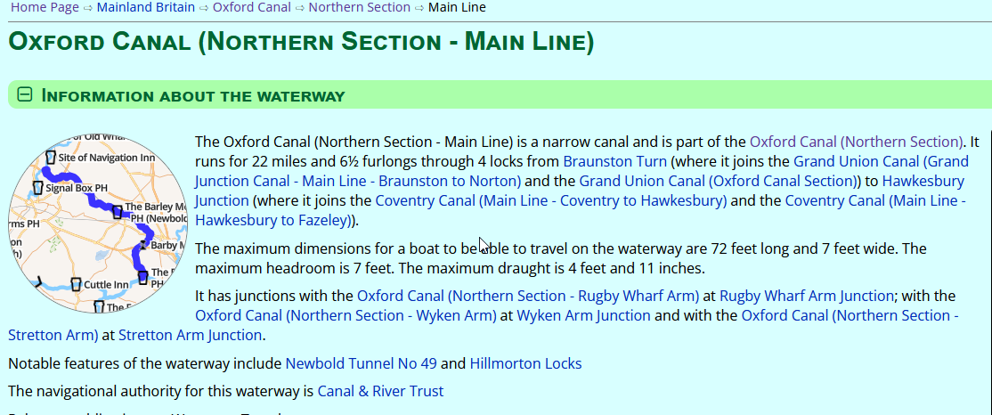

Tracy D'arth Posted November 4, 2021 Report Posted November 4, 2021 19 minutes ago, David Mack said: Yes, but not faultlessly, as it is reliant on the data sources used for the program. For example it told me that I couldn't take a 70 ft boat from the Rochdale Canal to Salterhebble, despite the fact I had already done it in two different full length narrow boats. Turned out that as this section is part of the Calder and Hebble the maximum boat length was set to 57 ft, even though there are no locks on this section. I think that particular glitch has been fixed, but there may be others. That is why I asked if it works. Does it allow wide beams on the North Oxford for example?
StephenA Posted November 4, 2021 Report Posted November 4, 2021 (edited) 10 minutes ago, Tracy D'arth said: That is why I asked if it works. Does it allow wide beams on the North Oxford for example? But of course if you don't tell Canalplan you are 14 feet wide.... Edited November 4, 2021 by StephenA 1
