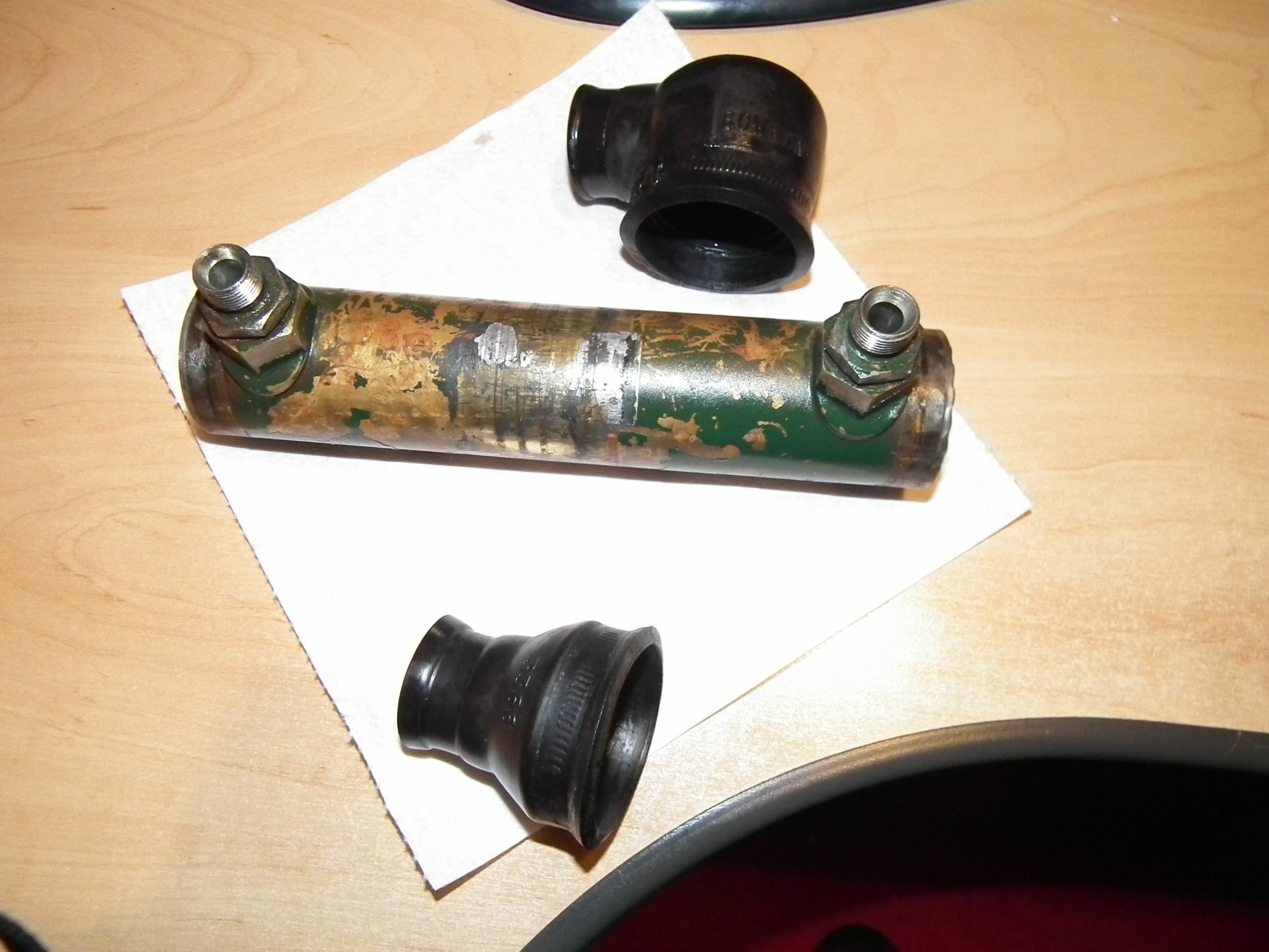

Ray T Posted July 6, 2021 Report Posted July 6, 2021 (edited) Your gear box oil cooler will possibly look something like this: The end caps deform over time, worth replacing. Oil cooler in situ, gearbox removed for clarity. Edited July 6, 2021 by Ray T
ditchcrawler Posted July 6, 2021 Report Posted July 6, 2021 1 minute ago, Ray T said: Your oil cooler will possibly look something like this: The end caps deform over time, worth replacing. I had one just like that that failed
David Mack Posted July 6, 2021 Report Posted July 6, 2021 9 minutes ago, Ray T said: The end caps deform over time, worth replacing. But won't cause the OP's problem. A failed end cap will result in cooling water leakage into the boat. The OP's problem is a failure of a heat exchanger tube or end plate. 13 minutes ago, Ray T said: The end caps deform over time, worth replacing. But won't cause the OP's problem. A failed end cap will result in cooling water leakage into the boat. The OP's problem is a failure of a heat exchanger tube or end plate. Replacement cooler: https://www.asap-supplies.com/products/bowman-dc50-oil-cooler-40hp-3-8-bsp-oil-22mm-id-water-203010
