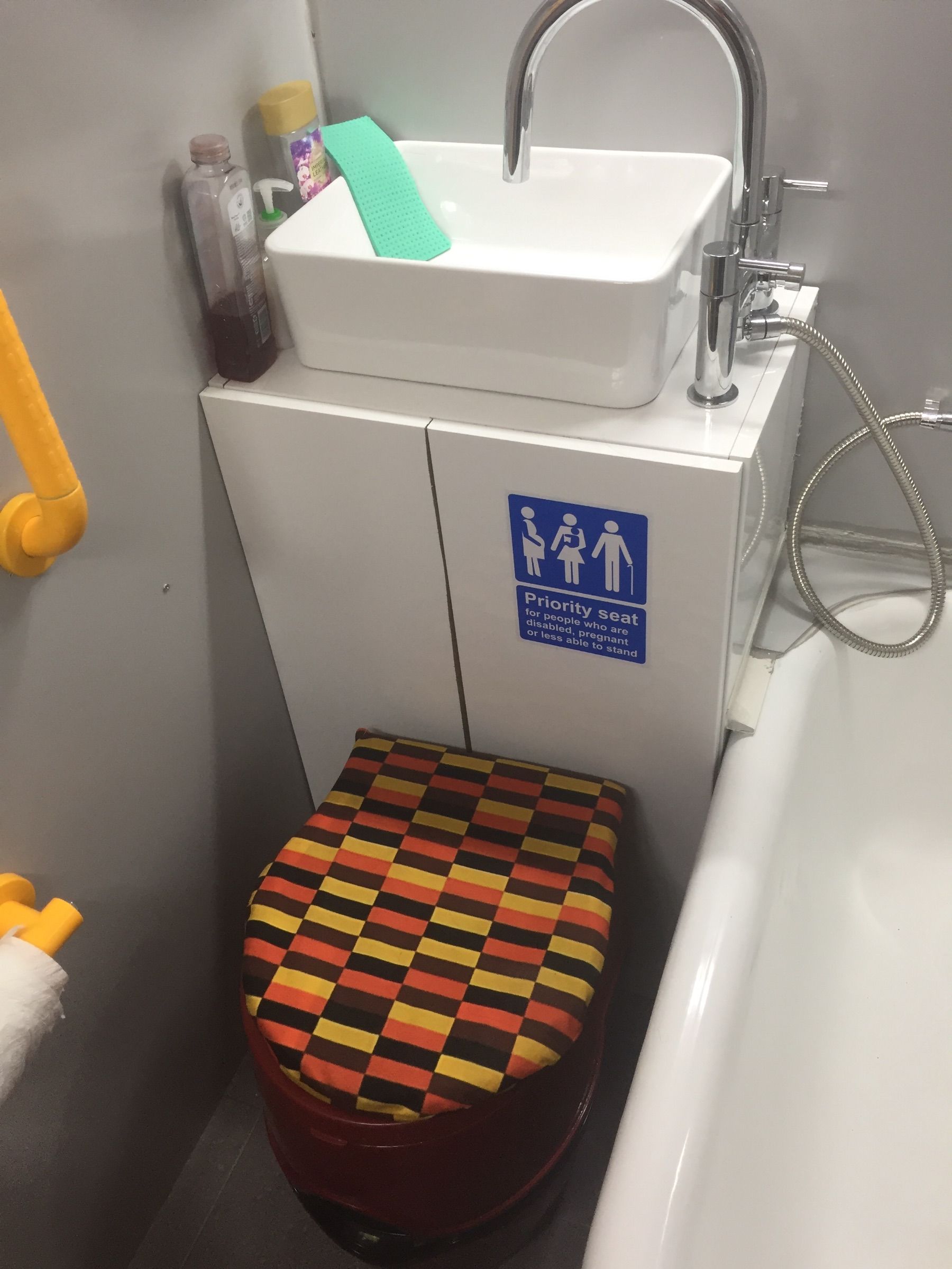

It's in year 2, quite a lot of scratches on the lid, but today I cleaned it with cheap blue laundry liquid on a cloth, and it is looking good, I also started using the laundry liquid in the bowl, and all seems well. When near a sanitary station it lasts a week and is easy to empty, if not near an Elsan it lasts 10 to 14 days, I use the Thetford Blue and minimal flushing, not so easy to empty. I don't have room for a spare, have considered a small porta potti for urine only / emergencies.
