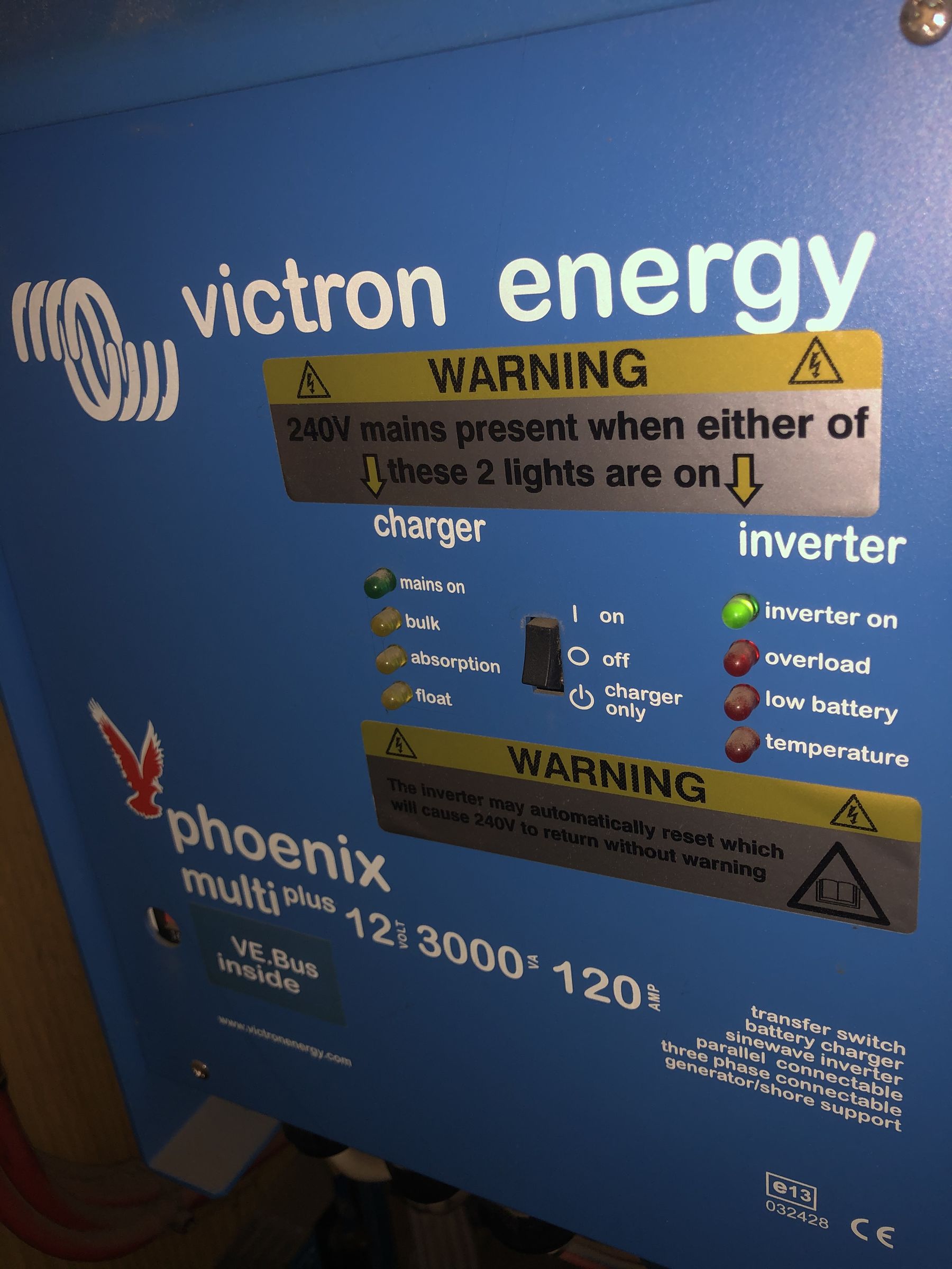

Richard10002 Posted November 9, 2020 Report Posted November 9, 2020 (edited) You dont say what charger you have unless, as Tony suggests, your Victron is an inverter/charger. 2 things to try and help: 1) My Honda EU10i "just" runs my Sterling Pro Charge Ultra 60A charger. I have to start the genny of constant fast power to get it to power the charger. Then, when the charger is up and running, I can change the genny to its' variable speed setting, and it all runs supplying 60A for hours. So, anything more than a 60A charger, and the EU10i will almost certainly not power it. 2) If your 3Kw Victron is also a charger, it will almost certainly be more than a 60A charger.... possibly 80A, possibly 120A..... we dont know. I have a Sterling 2500W Pro Combi S which is an inverter charger where the charger is 80A. I used to have a Honda EU20i which ran the 80A charger with ease. How much bigger a charger it could run, I don't know. Make/Model/Ampage of your charger would help Edited November 9, 2020 by Richard10002
Dr Bob Posted November 9, 2020 Report Posted November 9, 2020 19 minutes ago, Richard10002 said: 2) If your 3Kw Victron is also a charger, it will almost certainly be more than a 60A charger.... possibly 80A, possibly 120A..... we dont know. We have a 5KV victron combi which has 200A charging but can be turned down with the dip switches to be 50A, 100A and 150A. I guess the 3.5KV one can be turned down as well. 1

Richard10002 Posted November 9, 2020 Report Posted November 9, 2020 5 minutes ago, Dr Bob said: We have a 5KV victron combi which has 200A charging but can be turned down with the dip switches to be 50A, 100A and 150A. I guess the 3.5KV one can be turned down as well. Looks like a 3KV will probably have a 120A charger. If that's the case, an EU10i would probably run it at 60A but, given my experience, not a certainty - 50A or less and I would be more certain. I prefer the EU10i as it is much lighter than the EU20i which, whilst more powerful, was always a faff. 1

Timx Posted November 10, 2020 Author Report Posted November 10, 2020 8 hours ago, Tony Brooks said: Is the Victron a combined inverter/charger or do you have a separate mains charger. If you have neither then you can buy a charger to suit the generator but for the smaller generator a suitable charger will take longer to charge the batteries. Do not even think about using the nominal 12V output to try to charge batteries. So I need the larger generator ?

BWM Posted November 10, 2020 Report Posted November 10, 2020 If you have a victron 3000 inverter/charger a Honda eu1 will trip out unless you have a remote control and set the amps to about 3, and this will be insufficient to charge unless run constantly. After a couple of disappointments with Honda eu2 gennys i opted for a CAT 2kva which is in my opinion more reliable and has a full 2kva output, along with some intelligent extras to make oil changes easier. A regular problem with the Honda 2 is that the pull cord frays, due to a contorted route and requires a full strip down to replace.

Richard10002 Posted November 10, 2020 Report Posted November 10, 2020 (edited) 8 hours ago, Timx said: So I need the larger generator ? Using the dip switches you should be able to set this to charge at 100%, 75%, 50%, or 25%, I.e. 120A, 90A, 60A, 30A. So, if you find your genny can’t cope with a higher setting, you can reduce it. As I think I said, my Honda EU10i “just” copes with the 60A setting on my Sterling Pro Charge Ultra 60A charger. When I say “just”, I have to start charging with the genny in full speed, (Hare mode). Then, once the charger is charging, I can switch the genny to variable speed, (tortoise mode). Would it cope in the same way with the 60A setting on your Victron.... probably, possibly, I dint know? In your position I would probably get the EU20i, (or equivalent Kipor), with its’ 1600w continuous capability, and put up with the extra weight. Have you thought about where you are going to store your genny and petrol safely? Edited November 10, 2020 by Richard10002 1

Timx Posted November 10, 2020 Author Report Posted November 10, 2020 2 hours ago, Richard10002 said: Using the dip switches you should be able to set this to charge at 100%, 75%, 50%, or 25%, I.e. 120A, 90A, 60A, 30A. So, if you find your genny can’t cope with a higher setting, you can reduce it. As I think I said, my Honda EU10i “just” copes with the 60A setting on my Sterling Pro Charge Ultra 60A charger. When I say “just”, I have to start charging with the genny in full speed, (Hare mode). Then, once the charger is charging, I can switch the genny to variable speed, (tortoise mode). Would it cope in the same way with the 60A setting on your Victron.... probably, possibly, I dint know? In your position I would probably get the EU20i, (or equivalent Kipor), with its’ 1600w continuous capability, and put up with the extra weight. Have you thought about where you are going to store your genny and petrol safely? Thanks, looking at getting the2000 kipor now, gennerator stored one side of bow locker, with drain hole, and petrol other side with drain hole, 1
