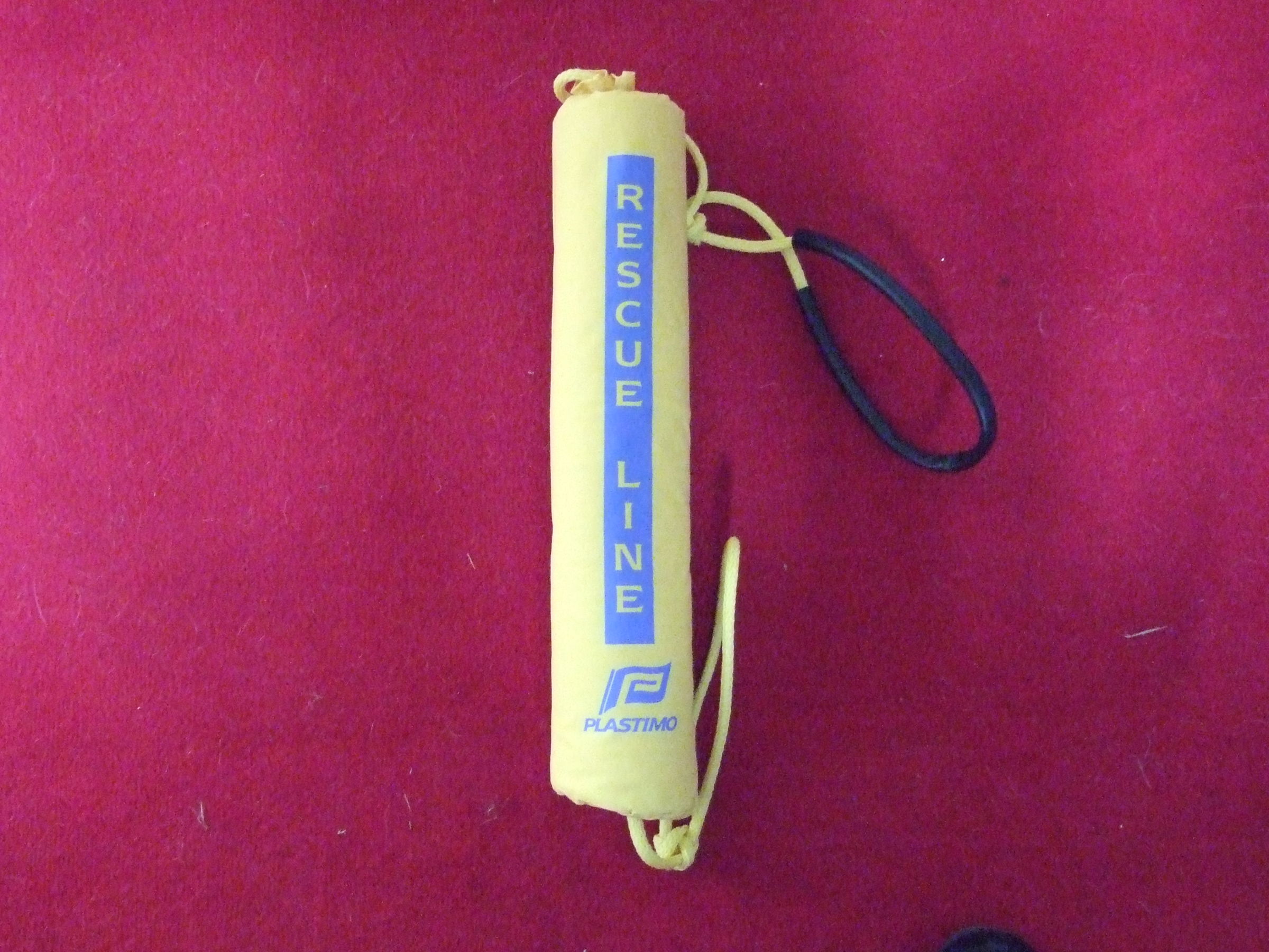

Bob692 Posted November 4, 2020 Report Posted November 4, 2020 Can you have a throwline instead of a life ring/buoy? and keep within the rules.
mrsmelly Posted November 4, 2020 Report Posted November 4, 2020 1 minute ago, Bob692 said: Can you have a throwline instead of a life ring/buoy? and keep within the rules. Yes. There are no rules on CART waters for a lifering anyway.
Alan de Enfield Posted November 4, 2020 Report Posted November 4, 2020 (edited) 12 minutes ago, Bob692 said: Can you have a throwline instead of a life ring/buoy? and keep within the rules. My Catamaran is in Plymouth, lovely place. There are no rules. The Boat safety scheme is about the safety of "passers by" NOT the people on your boat. So, you can have, nothing, a 'ring' or a throw-line, or horse-shoes its your choice. (I have a throw line, but on the canal when the person in trouble is only 10 foot away from you and in 3 feet of water you could throw then a 'ring' or poke them with your 'barge-pole'). Edited November 4, 2020 by Alan de Enfield 1
Tonka Posted November 4, 2020 Report Posted November 4, 2020 I have a throw line just inside the boatman's cabin . It is much better then the life ring that used to be on the roof and damage the paintwork.
Ray T Posted November 4, 2020 Report Posted November 4, 2020 13 minutes ago, Tonka said: I have a throw line just inside the boatman's cabin . It is much better then the life ring that used to be on the roof and damage the paintwork. Ditto.
pearley Posted November 4, 2020 Report Posted November 4, 2020 46 minutes ago, Ray T said: Ditto. Ditto too. But, practice with it before you need it for real.
Ray T Posted November 4, 2020 Report Posted November 4, 2020 28 minutes ago, pearley said: Ditto too. But, practice with it before you need it for real. Thank you, I used to sail offshore and used these as well as soft horse shoe “rings” during numerous training sessions to obtain my offshore qualifications. Personally I was never happy with a hard plastic ring. I know the chance is small but misjudge throwing a ring could hurt a “MOB.”
