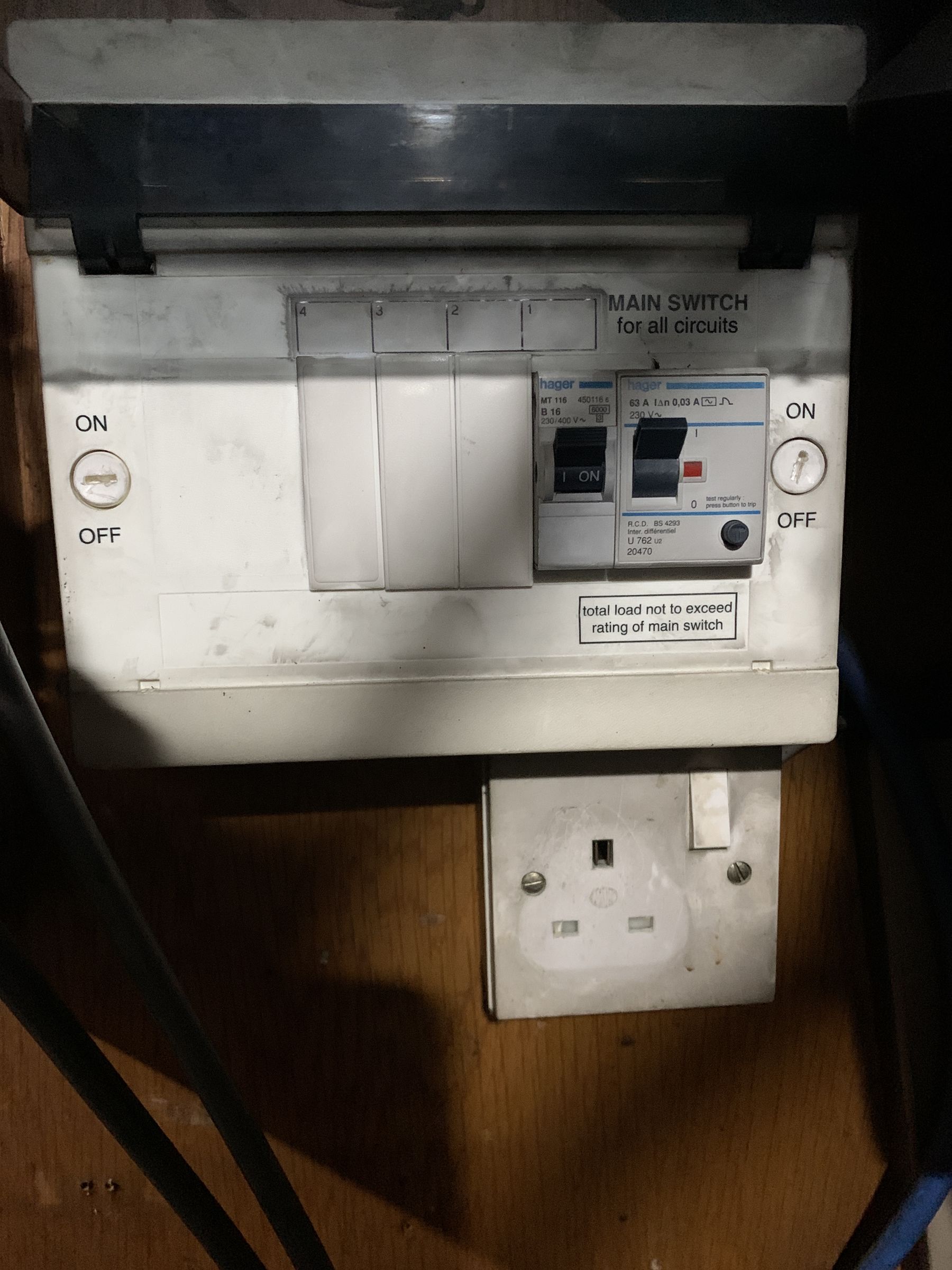

If you only have one central 12V fuse and no others then it is totally against the RCD and BSS fail. i suspect you are confusing a mains (240V AC) consumer unit with the 12V fuse/mcb distribution board.
Photos of this single fuse please. I suspect the bilge pump just might be wired to the engine battery and you may have a flat domestic battery bank so voltage at the DOMESTIC batteries with the pump turned on.
That is the shoreline and or inverter output consumer unit. What you need to look for are a car type fuse box, a metal/plastic panel with lights and/or buttons and/or switches in it arranged in rows and columns or if its an old boat a very old fashioned mains consumer unit with a  big red on/off switch and a row of fuses. I bet you don't have a hand held multi-meter or voltmeter so can't measure the domestic battery voltage.

That  appears to be an ac fusebox with a 16a breaker and a 63a RCD. Boubt that it's anything to do with your pump(s)
To clarify, I meant the photos posted by OP not Tony Brooks
Edited by Slim
You have a 240v circuit and 12v circuit. Show us the 12v board. And listen to Tony B.

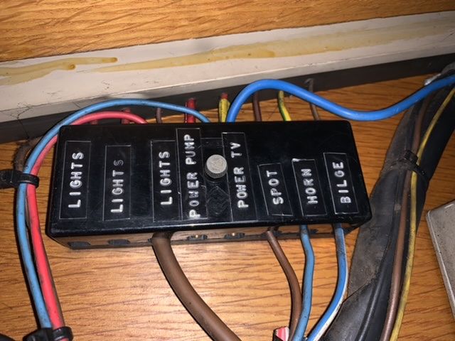

4 minutes ago, Piran said:
Thanks so much! Ok so I have found it I think
Unscrew the knob and lift the cover off, and there should be fuses inside it.

Good - unscrew the silver "button" in the centre and lift the cover off. I expect the under the "power pump" label you will find a fuse that hopefully is blown. Why hopefully? - because if its not you have fault finding to do.
Beware. If your domestic batteries are flat the pumps will draw more current and may blow a new fuse

In that case check where the cable join the fuse holders are clean and secure i.e. not lose and waving about.

1 wire at the fuse panel, but 3 pumps. I'd be looking for a corroded join or splice in the cable, possibly at the pump physically closest to the fuse panel...

If the fuses are ceramic torpedo shaped "euro" fuses bend the bronze strips that have holes in them for the fuse tip together a little and then plan to replace the whole thing for modern plug in fuses.
