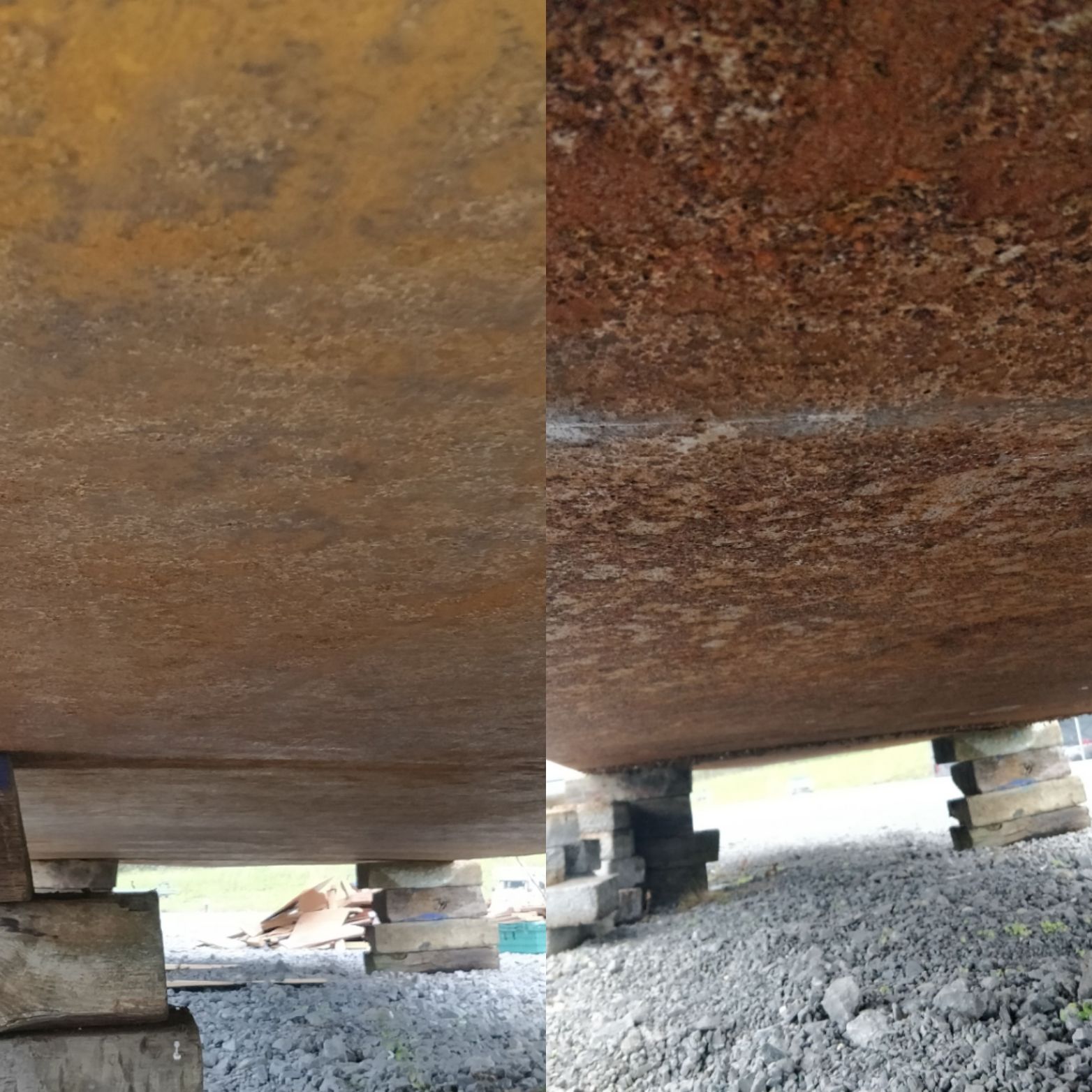

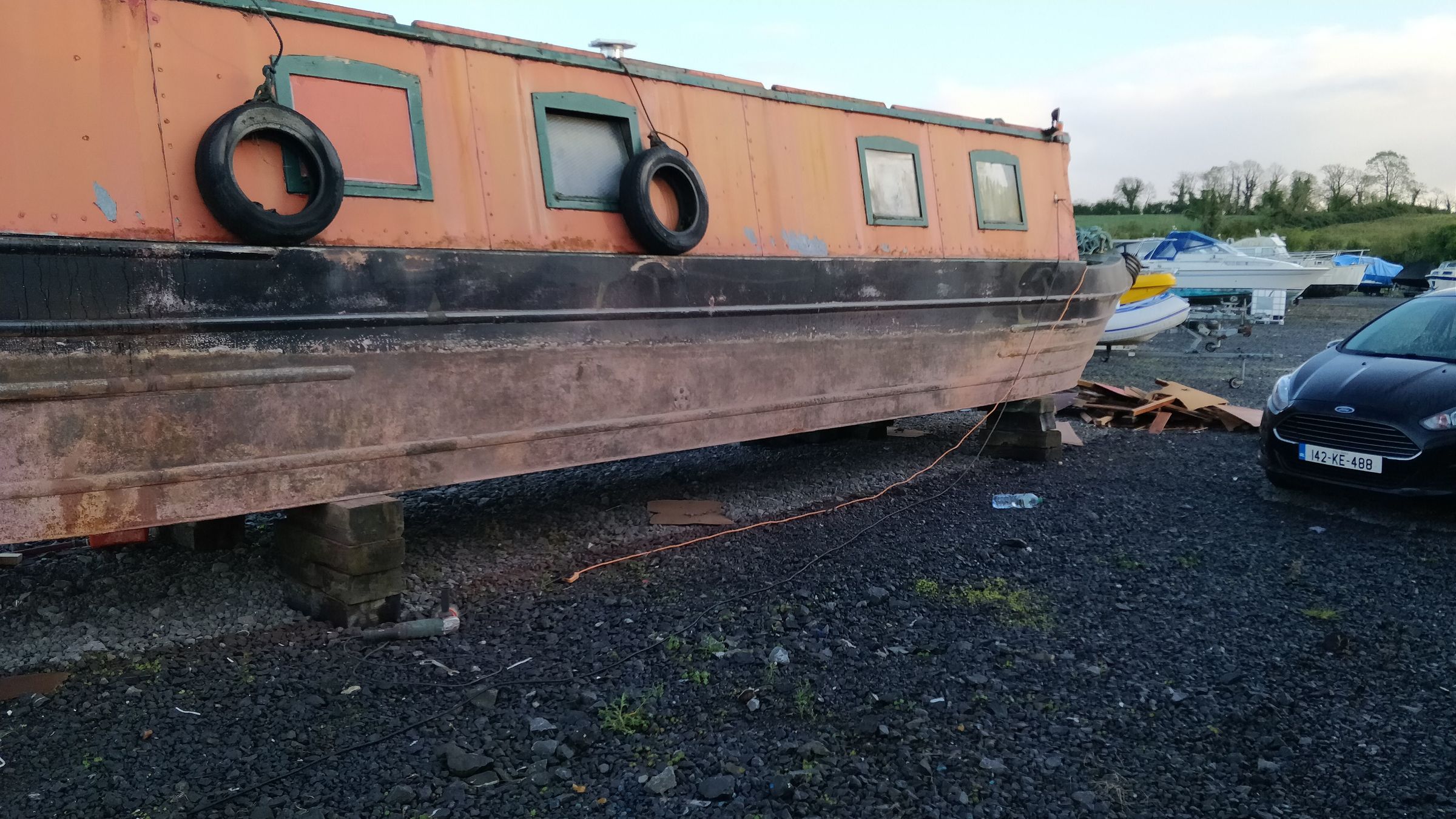

So I launched into buying a narrow boat during covid when I thought I'd have plenty of time to take it slow and learn....fast forward it's dry docked getting cold and I gotta get this painted and back in the water asap. Base plate is solid after scale gone but needs some coating. There's rust and last small chips of last coating, I've hit it with a wire wheel for a few too many hours, Any tips on what to do for prep?...blasting is the obvious choice but absolutely isn't in the price range. Is rust converter a waste of time or even primer when using bitumen black?

By "dry docked" do you mean it's sat on bricks on a hard standing as shown in the photos?  If so, I'd be inclined to see if you can keep it there and get it right rather than to rush it back into the water. You've left it a bit late to be blacking on most days at this time of year - if the steel feels cold to the touch, it's not really good to be blacking. Lots of threads on here about dew points and curing times, putting a newly blacked boat back in too quickly, etc. Of course, sometimes must needs....
I’d get it covered with Vactan, keep it out of the water until March/April, and see how it looks. If bits have rusted again, localised Vactan, the 3 coats of blacking, plus a 4th coat at the waterline.

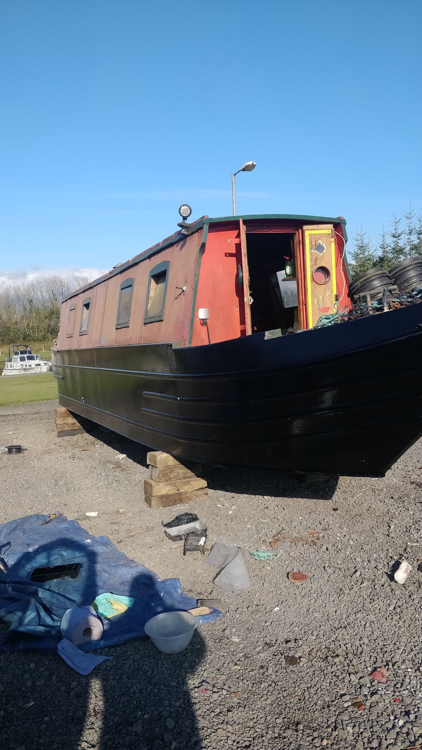

So weather's been very lucky this time of year!  I went with a load of Lowes , followed by 2 coats Primocon, then finally 3 coats blacking.
I've to get it lifted to access the base plate under the wooden blocks but might be only about 4 hours before going into water....bad idea?

Just get some weather shield or hammerite on it, no obvious rust patches from that pic.
You havnt got the time, conditions and humidity to paint it properly with enamels outside now.

I don't think it really makes much difference whether you prep the hull any further, use vactan or just slap a few coats of bitumen on by itself. Unless you use a better paint system you'll have to do it all again in a few years time.
As soon as you start to see rust on the waterline you've got about a year to get the boat out again.
So if you use bitumen don't worry too much about the standard of the prep or the coatings. As long as you keep doing it regularly it will be fine.
I wouldn’t risk my life getting under that boat looking at the wooden blocks. Very precarious?

The swing lift and stands will be rocking at the time just for the underneath the blocks still scaley and zero coats of anything

Sorry there will be a swing crane lifting it onto metal supports while I paint the base plate....."rocking" was probably a bad choice of words considering?
