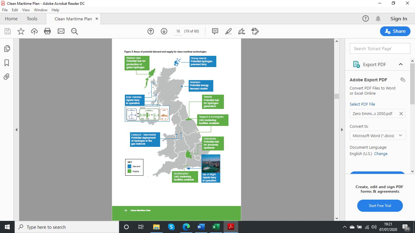

Alan de Enfield Posted September 26, 2020 Report Posted September 26, 2020 27 minutes ago, David Mack said: And the references to 'low or zero emission marine fuel bunkering options' suggest that some sort of oil-based fuel is going to continue to be used. Hydrogen LNG Amonia The planned bulk supply locations - note that it is proposed to feed Hydrogen down the gas main.
