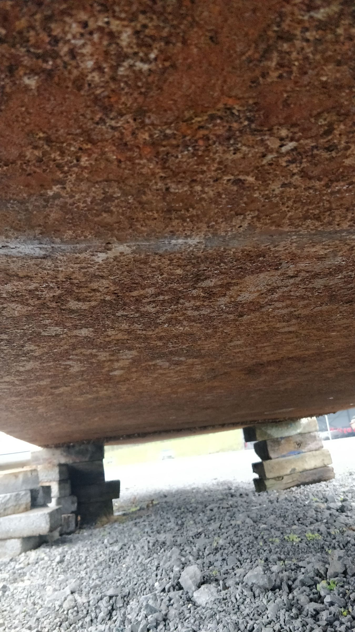

I recently bought a 40ft narrow boat steel hull,
After getting it lifted and cleaned for a survey I discovered quite a lot of rust and a seam in the middle of the boat which needed filling and some pitting towards the front.
I got onto a welder and to save some time and money was hoping ( in favour of sand blasting) to use a grinder with a flat plate to sand down hull and prep it for welding.
Grinder is a dewalt battery 8000rpm and 180grit plate.....am I in any danger of eating through the steel and grinding it down too thin?

Yes absolutely!! I really wish I read this before I went at it guys had about 20mins of battery life, had a small drill brush and a scotch brite disc for grinder. Got the seam somewhat clean but there's some pitting I have to find so I'm going at it again with 4 more batteries Saturday!
Not wishing to spoil your fun but it looks from the picture like this boat has been in salt water and there are holes in the plating. Now it has dried out try hitting as small area with  chipping hammer to see if the scale falls off and what you are left with. Anything less than 3-4mm thick and you have a serious problem. I don't think a wire brush is going to have much impact on that scale except for polishing it. You need an air chisel, needle gun or impact drill with a chisel bit or shot/sand blasting

8mm think originally and about 5.2 in parts now 3.2 at seam don't get me wrong realistically replating is probably the way forward but I've about a €2k budget to get this painted and back in water.  Worry about the proper job to be done after the Covid budget!
