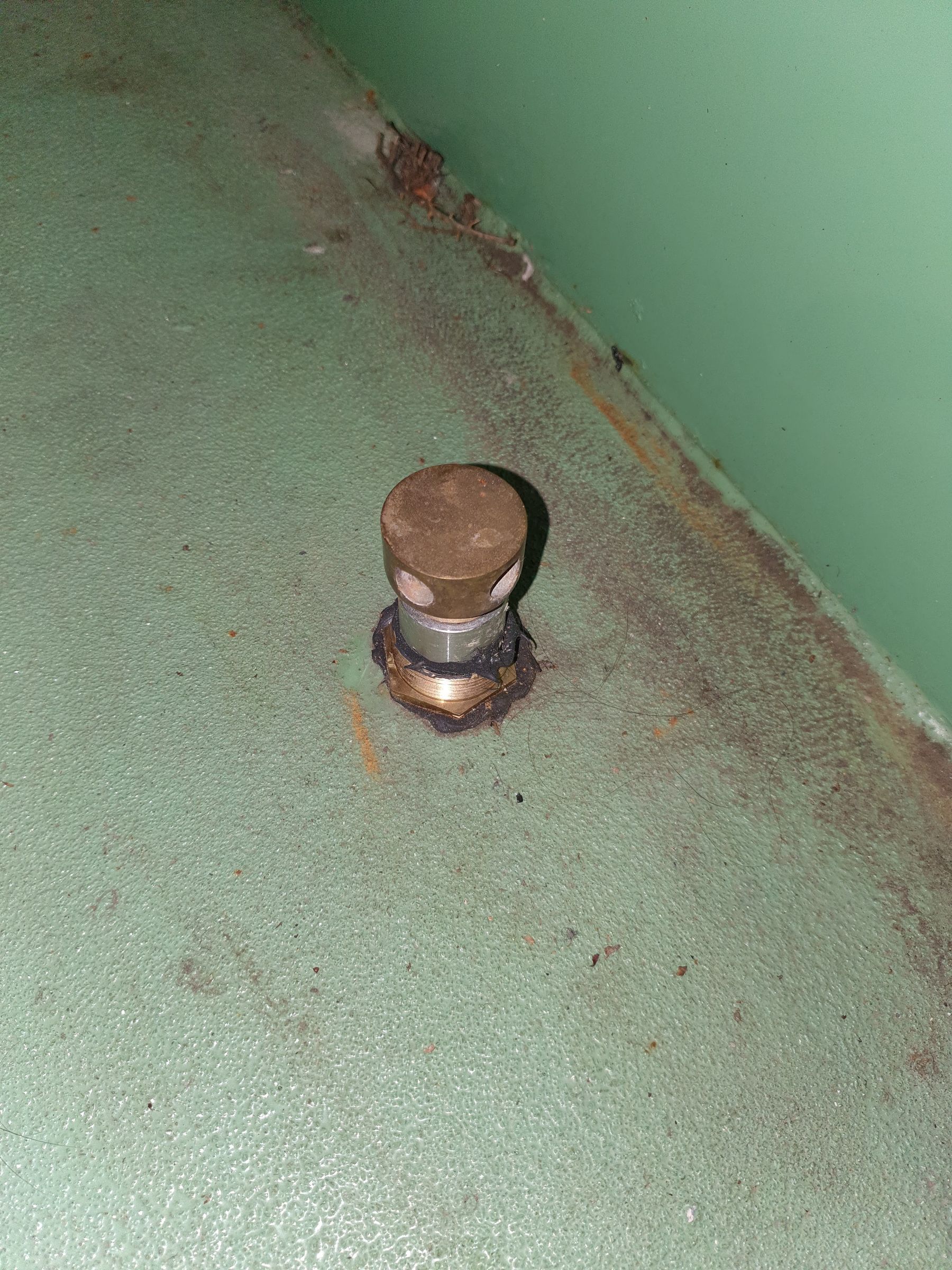

1 minute ago, Tracy D'arth said:
Long shot, there is a vent on the tank to let air in as it empties?
Good call, and around a third of a tank would be enough vacuum pressure to stop flow.
there is what looks to be a vent installed, but doesn't look to be original.
That looks like the vent on the fuel (diesel) tank and have a anti-flame flash gauze in the little holes.
Are you sure you have not put water into the diesel tank ?
If that picture shows the typical condition of a 'new boat' I'd be taking it back to the manufacturer and expecting my money returned.
Its a new boat for me, but actually 6 years old.
I'm sure its not the wrong tank, the diesel tank is at the back of the boat and this is at the front.
That's a terrible thought. Are you sure?
It is identical to the anti-flash vent on my NB diesel tank and it looks nothing like any vent I've had on a water tank, but 'who knows' who the manufacturer is or what they have used.
Just a suggestion that the OP checks his tanks.
Flame arrester is good, at least the water won't explode ?. Maybe somebody installed a water tank vent and that was a convenient way to reduce rain and splash ingress? (hopefully)
..............Dave
Seconded looks several years of grime there, plus the sealant round that vent is dreadful. Have you paid him?

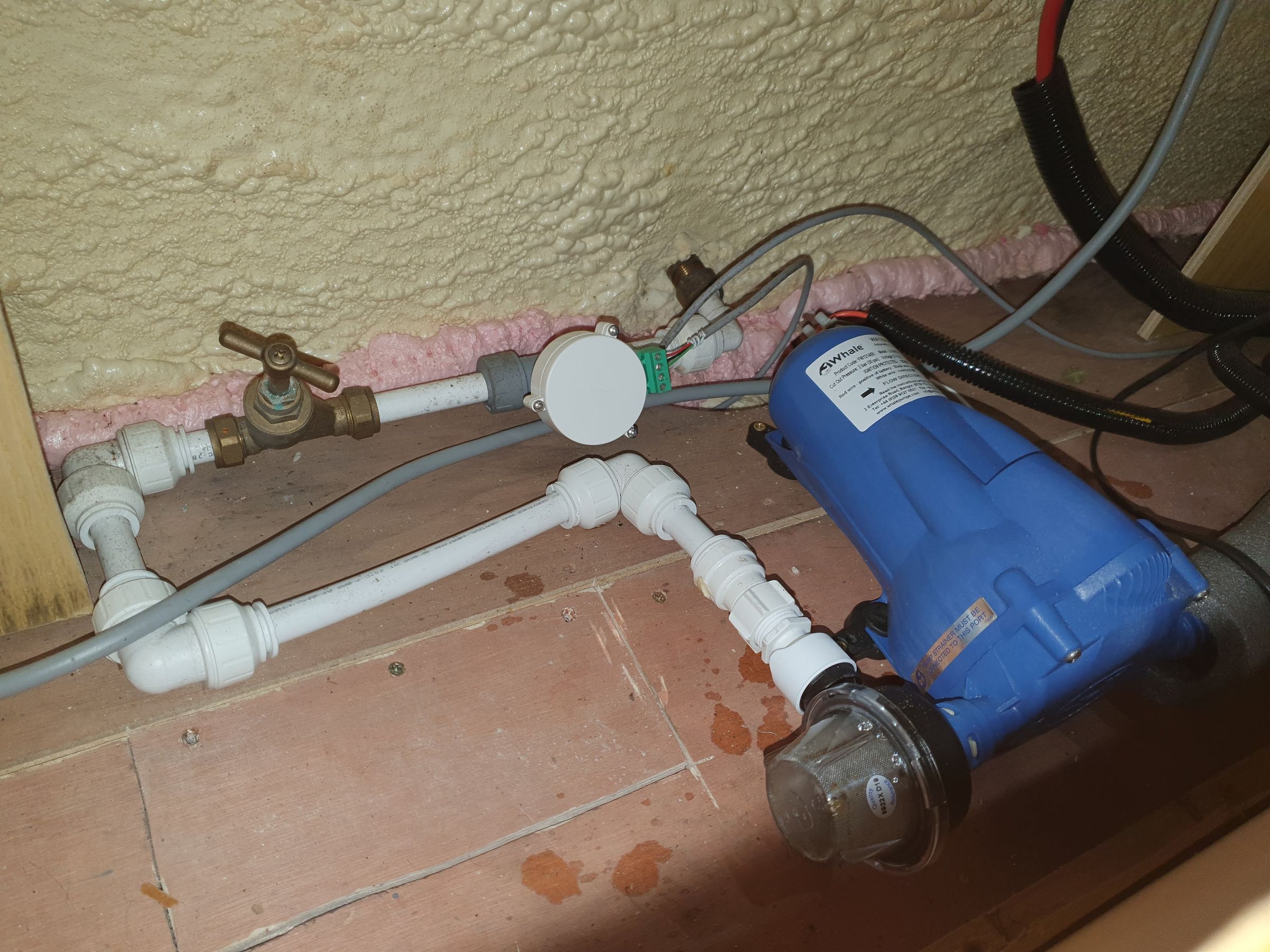

The tank will only give out water until the level in the tank reaches the level of the outlet (the take-off point). If this is too high, or had an elbow dipping down into the tank that has accidently turned up, you will get less water out than you expect.
Smart thinking,  here is the takeoff point, looks to be low enough. No idea how to check if an elbow has rotated on the inside, but all looks stand enough so assume its just a regular outlet with no elbow?
