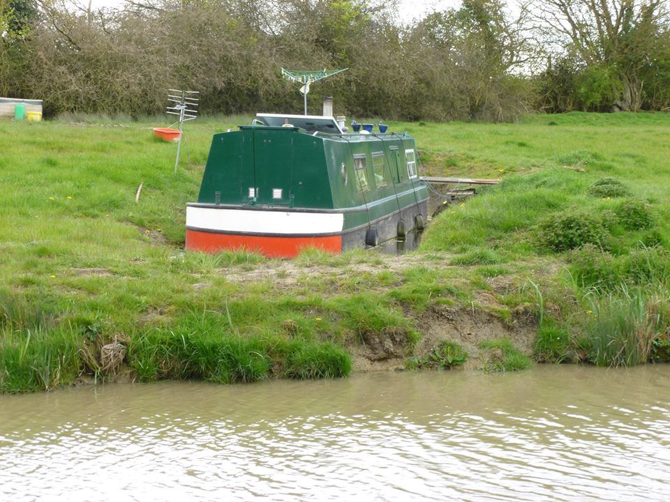

Ray T Posted March 31, 2020 Report Posted March 31, 2020 (edited) Put the boat on hard standing or build your own off canal marina. Edited March 31, 2020 by Ray T
ditchcrawler Posted March 31, 2020 Report Posted March 31, 2020 3 minutes ago, Ray T said: Put the boat on hard standing or build your own off canal marina. That is not very hard, good job its got its fenders down
