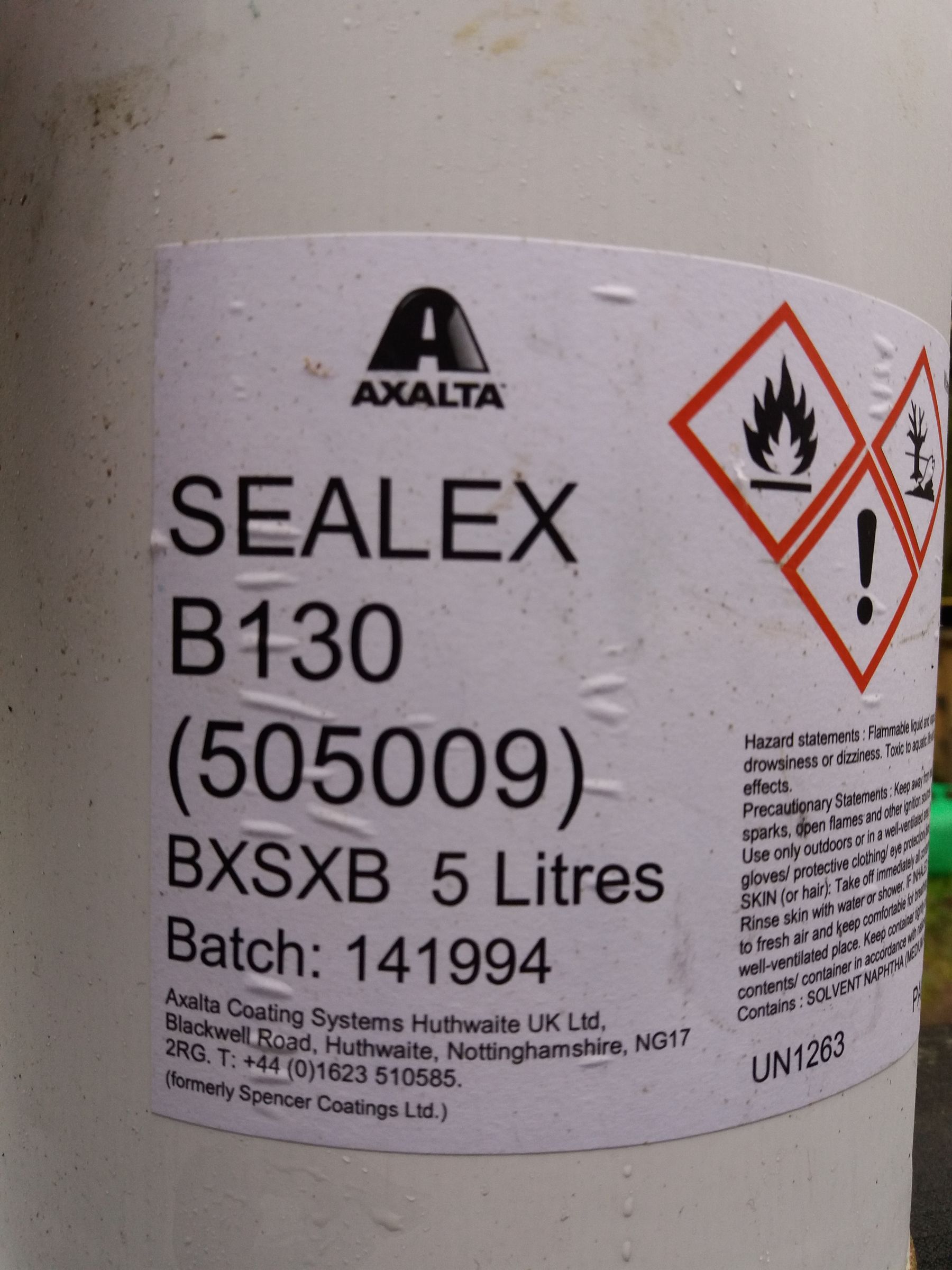

MichaelG Posted January 14, 2020 Author Report Posted January 14, 2020 Hello, thanks for the replies. I wont have the benefit of a covered area, the marina has an open hardstanding area that they can haul boats out onto via a slipway. I can leave it until the warmer weather arrives. I don't know which product the Marina applied two years ago, the bill just says bitumen paint. I think it cost me about £700. I don't grudge paying for it to be done but I'm thinking if I I'm thinking if I do it myself I know how it's been done. Sorry for the two messages but the pooter seems to be going rogue on me.
