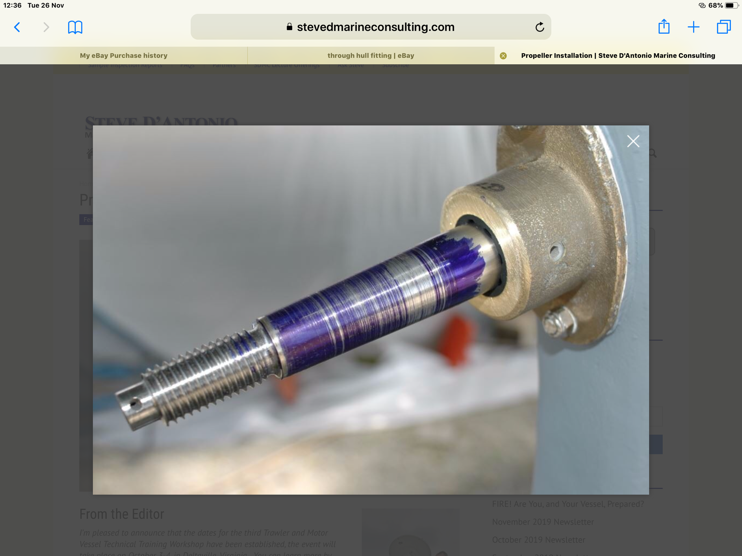

bigcol Posted November 26, 2019 Report Posted November 26, 2019 Hi somone in the marina has had his wooden broads boat out on the hard as he lost drive. when boat came out, this part slightly different but does the same job. He wants to replace the part. but what’s it called please,like to help out the guy. It’s the part that attaches to Hull,and keeps the shaft true
BEngo Posted November 26, 2019 Report Posted November 26, 2019 Stern bearing. May be rubber lined (cutless bearing) or whitemetal. Is there a grease lubricator inside? If so it is whitemetal. Iz there a water inlet on the far side? That would be for a cutless bearing. N

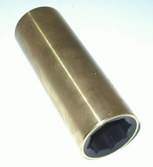

Slim Posted November 26, 2019 Report Posted November 26, 2019 Looking at the photo I would say it was a water lubricated Cutless bearing. You can see the segments clearly.
ditchcrawler Posted November 26, 2019 Report Posted November 26, 2019 24 minutes ago, Slim said: Looking at the photo I would say it was a water lubricated Cutless bearing. You can see the segments clearly.

pearley Posted November 26, 2019 Report Posted November 26, 2019 2 hours ago, ditchcrawler said: The Volvo Penta and Vetus ones look like this. You remove the 3 Allen screws and knock the old one out.
magnetman Posted November 26, 2019 Report Posted November 26, 2019 The photo in the OP is not the actual item. 1
Alan de Enfield Posted November 26, 2019 Report Posted November 26, 2019 2 minutes ago, magnetman said: The photo in the OP is not the actual item. Which he kindly said "its like this but different" That is why I gave him the list of various types and sizes so he could speak to the supplier and identify which one he actually had.
magnetman Posted November 26, 2019 Report Posted November 26, 2019 The item does not belong to the OP.
