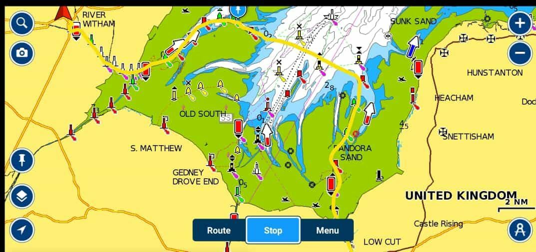

We did have on our phone the Navionics navigation App which is simplicity itself to use and can be downloaded for a two week free trial if you only want it for a single trip. I personally wouldn't have done the crossing without it, in fact we used it last year when we did the tidal Severn, also without a pilot, from Sharpness to Bristol via Portishead.

You can't feel unsure of where you are, or where you should be going with the Navionics app: see the screen shot  showing our track below.
